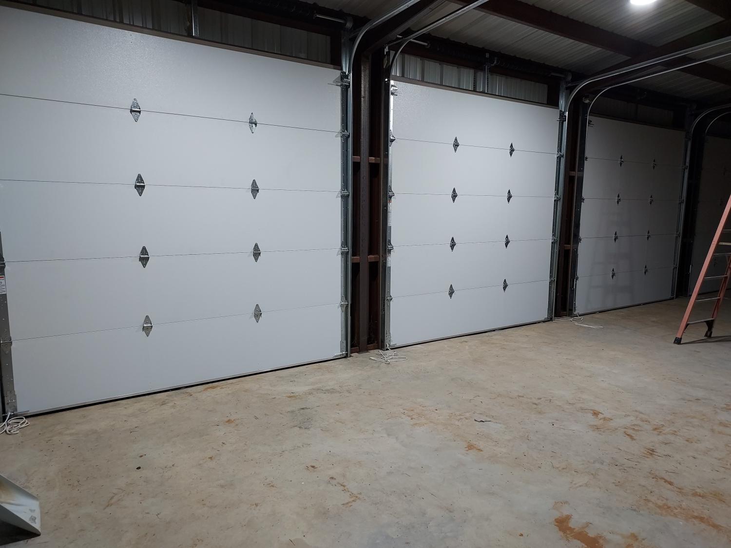

Got the insulated 10' X 10' metal doors installed. I could have saved a few hundred bucks if I got the plastic backs. Went with ALL metal. Nice spring steel door stops for all 4.

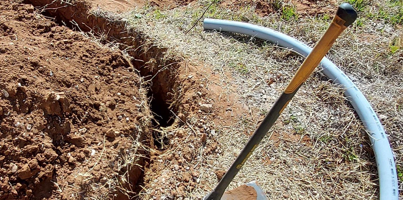

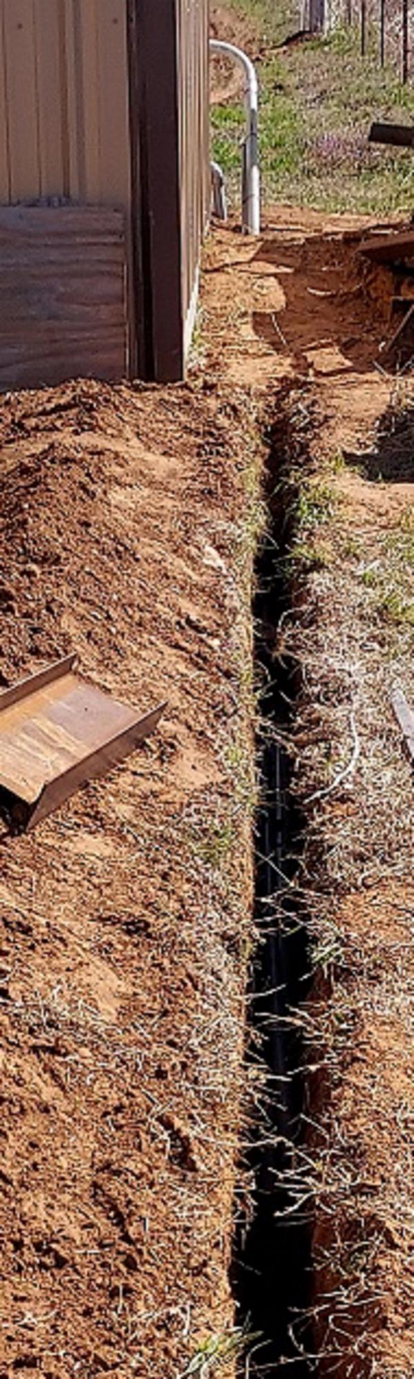

Starting electrical. Got the main 200amp service panel tied into the meter in the old shop, tested 246 volts. 123 on each leg. Zero Volts on the neutral. Dug/picked a 50-foot ditch about 22 inches deep to run power to new shop. Fun with 2 torn rotator cuffs. Neighbor helped a few feet. Pulled the wire through 10 feet at a time. Then slid a 10-foot length over the wire and glued and dropped in the ditch and so on. Pulled last stretch into the new shop and tied into 100amp subpanel. Turned on breaker in old shop and this panel also tested good. Buried the ditch and getting ready to start pulling wire for lights. Lights first, so I can see what I am doing. Then outlets, future door openers, 2 lifts etc... I hung a couple lights as a clearance test. I was lucky that the lights clear the doors by a couple inches. So I hung the last 6. Danny

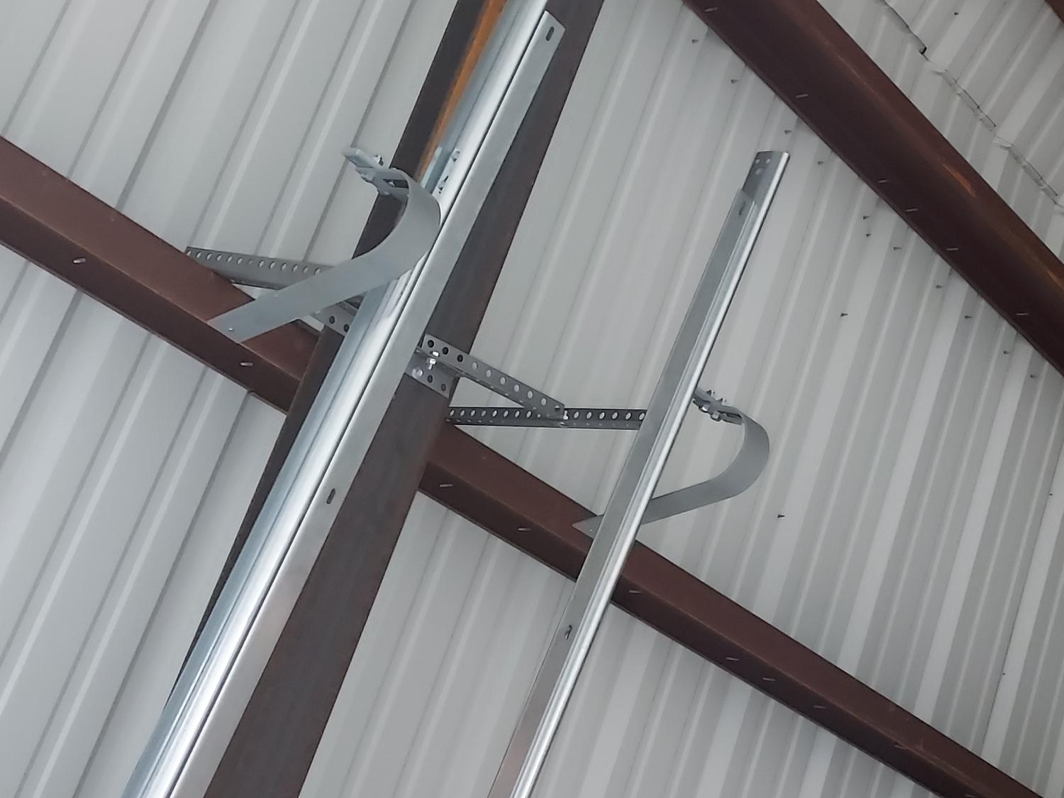

Pictures sideways, so I flipped them and reposted. STILL sideways?? Can someone right them please. Shop doors, and 2 power panel pics. D

I rented a chain trencher to bury my cable to the back shed. NO way I was going to hand dig that, especially 6 weeks after double hernia surgery. Machine was a very nice tool to use.

Not much room for 30 feet of the 50 for a trencher. Too close to building. I wish I could have.

Things are lookin’ great also love the tidy high-angled Overhead Door tracks.
Are you going w/ Manual Lift or if Power Operators, are they Overhead style or Side-mounted?
