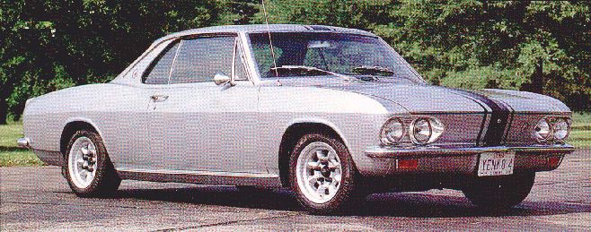

1966-1967 Yenko "Stinger" Corvair |
1966 | |||
Number produced: | |||
4-speeds: 100 | Autos: 0 | Total: 100 | |
RPO #s ordered: | |||
3900CC | Ermine white exterior paint | ||
3F41AA | Heavy duty suspension | ||
3M20BB | Four speed transmission | The M-21 close-ratio transmission was ordered for all of the '66 Stingers. | |
3N44AA | Special steering | ||
3758DA | Black interior trim | ||
COPO #s orderded: | |||
9513A |
3:89 positraction differential | The 3.89 positraction differential was not available for any other Corvair in 1966, but it could be purchased over the counter at Chevrolet. | |
9861E |
Independent brake unit | Dual Master Cylinder Unit. It is believed that this application was taken from a 1966 Cadillac. | |
In '66, the Stingers were sold in various stages (I, II, III, or IV), from street cars to all out SCCA race cars, but all of the first 100 cars came painted white. Also, all of the '66 Corvairs came from GM as "Corsas". Don ordered 100 COPO Corvairs, and tagged them YS-001 through YS-100 |
1967 | |||
4-speeds: 25 | Autos: 0 | Total: 25 | |
COPO #s ordered: | |||
9513A |
3:89 positraction differential | The 3.89 positraction differential was not available for any other Corvair in 1967, but it could be purchased over the counter at Chevrolet. | |
9551B |
140 horsepower engine | The 140 HP engine option was discontinued for 1967, but it was still available as a COPO option. | |
In '67, Chevrolet dropped the Corsa model from the Corvair line, so Yenko was forced to order Monzas instead. These cars were ordered either Marina Blue of Bolero Red, as the SCCA had dropped the rule that all American made SCCA cars be white. The '67 COPO "Stingers" were tagged YS-107 through YS-120, while the non-COPO '67s were tagged YS-102 through YS-106 and YS-121-YS-9700 | |||
Stingers tagged after February 1967: | |||
4-speeds: 60 |
Autos: 0 |
Total: 60 | |

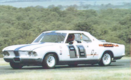

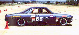

This is a '66 Yenko Stinger Corvair racing in the SCCA. This was Don's first real dealings with using the COPO pipeline to get the ideal car for that type of racing. Here is one of the first 100 Stinger Corvairs built. This car was set aside and painted "Silver Pearl" and was used as Yenko's family driver. The Stingers proved to be another one of Don's good ideas. | |||

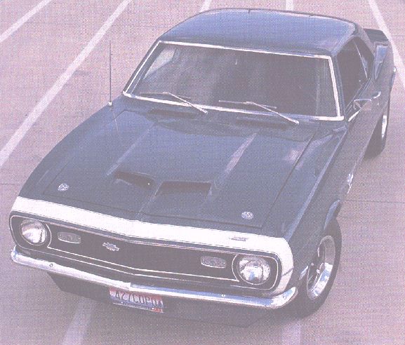

1968 Yenko Camaro |
Number produced: | ||||||
4-speeds: 65 |
Autos: 0 | Total: 65 (est.) | ||||
RPO #s ordered: | ||||||
L-78 |
396/375hp "L-78" engine | This was the highest rated 396 available in the Camaro. Some historians feel that all of the '68 Yenko COPO Camaros came with the L-78 installed at Chevrolet, while some believe there were a few L-72s installed by Chevrolet. | ||||
COPO #s ordered: | ||||||
9737 |
Sports Car Conversion | This added heavy duty suspension components, a 140 mph speedomoter, and a larger carb. | ||||
COPO engine code: |
MV = 4-speed | |||||
COPO rear end code: |
QD = special HD, 4.10 posi | |||||
Transmission code: |
P0xxxB = M-21 | |||||
Here is the '68 Yenko Camaro give-away car. Notice the unique for '68 hood hiding the 427. Here is an even better look at the hood on a blue '68 Yenko Camaro. Unsure which color to choose? Well, would you rather be subtle, like this Island Teal car, or announce your presence with this red car?! | ||||||

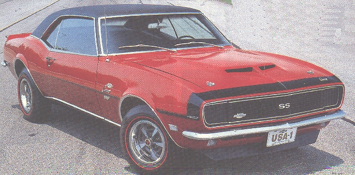

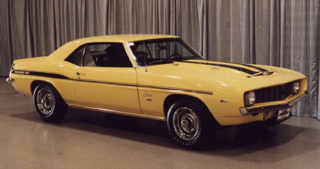

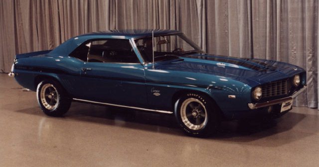

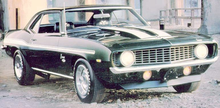

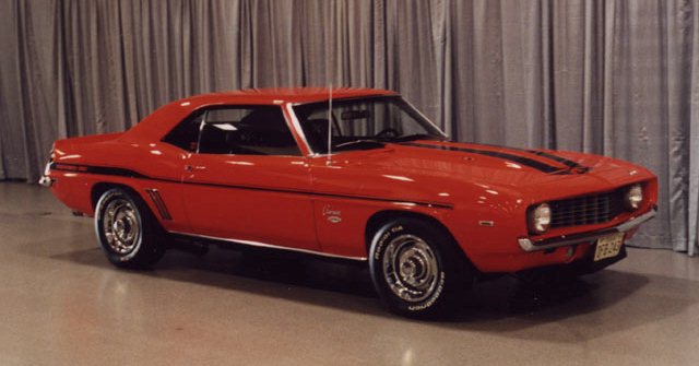

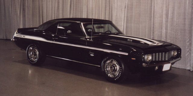

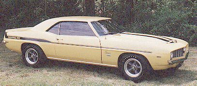

1969 Yenko Camaro |
Number Produced: | |||||||||||||||||||||||
4-speeds: 170 |
Autos: 28 |
Total: 198 | |||||||||||||||||||||
RPO #s ordered: | |||||||||||||||||||||||
C08 | Roof cover, vinyl | Optional | |||||||||||||||||||||
D55 | Console | Optional | |||||||||||||||||||||
D80 | Spoilers, air: front and rear | All '69 Yenko Camaros were ordered w/spoilers. | |||||||||||||||||||||
G80 |
Axle, rear, posi, 4.10 | A 12 bolt housing with a special ring/pinion replaced the standard units under COPO 9737. | |||||||||||||||||||||
J50 |
Brakes, power | This option was required by Chevrolet on all COPO cars ordered. | |||||||||||||||||||||
J52 | Brakes, power disc front | This option was required by Chevrolet on all COPO cars ordered. | |||||||||||||||||||||
L78 |
396/375hp "L-78" engine | This was the highest rated 396 available in the Camaro, and was replaced with the L-72 when COPO 9561 was ordered. | |||||||||||||||||||||
N40 | Steering, power | Optional | |||||||||||||||||||||
U17 | Instrumentation, special | Optional | |||||||||||||||||||||
U63 | AM radio | Optional | |||||||||||||||||||||
VE3 | Bumper, special front | Optional | |||||||||||||||||||||
X11 or X44 or X66 | Fisher Body Code | Early cars were either X11 or X66, while cars built after March are X44. | |||||||||||||||||||||
Z21 | Exterior style trim group | Optional | |||||||||||||||||||||
Z23 | Special interior group | Optional | |||||||||||||||||||||
COPO #s ordered: | |||||||||||||||||||||||
9561 |
427/425hp "L-72" engine |
This deleted RPO L78 and added RPO L72, along with RPO ZL-2 (cowl hood), RPO V48 (heavy duty 4-core radiator), and RPO F41 (high performance suspension w/special springs/shocks). | |||||||||||||||||||||
COPO engine code: |
MN = 4-speed, MO = automatic | ||||||||||||||||||||||
9737 |
Sports Car Conversion | This added 15 x 7 Rally wheels, a 140 mph speedomoter, and a 13/16" front stabilizer shaft. | |||||||||||||||||||||
BE = special HD, 4.10 posi | ||||||||||||||||||||||
Transmission code: | P9xxxB = M-21 or 69Xxxx = 400TH | ||||||||||||||||||||||
Identifying marks: | |||||||||||||||||||||||
Most of the '69 Yenko Camaros were fitted with stripes and emblems, although there were some cars ordered stripe and/or emblem delete. Yenko also offered aftermarket gauges, headers, shifters, and Atlas wheels as extra cost options. | |||||||||||||||||||||||
In '69, they utilized the COPO pipeline to get the factory to install 427s into the Camaro. Here is a '69 Yenko Camaro, 1 of 5 Daytona yellow automatics. Or, for those who would rather blend into the darkness, a Fathom Green '69 Yenko Camaro. Fathom Green, such as on this '69 Yenko Camaro, proved to be a very popular color on the Camaros. Another one of the 6 colors offered on the Camaro was LeMans blue. | |||||||||||||||||||||||

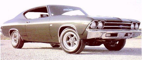

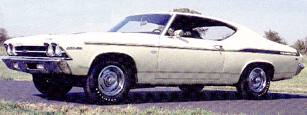

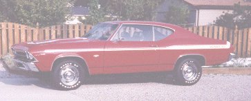

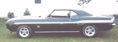

1969 Yenko Chevelle |
Number Produced: | |||||||||||||||||||||||||||||
4-speeds: |
Autos: |
Total: 99 | |||||||||||||||||||||||||||
RPO #s ordered: | |||||||||||||||||||||||||||||
C08 |
Vinyl roof | Optional | |||||||||||||||||||||||||||
G80 |
Axle, rear, posi, 4.10 | 12 bolt housing, and a special ring/pinion replaced the standard units under COPO 9737. | |||||||||||||||||||||||||||
J50 |
Brakes, power | This option was required by Chevrolet on all COPO cars ordered. | |||||||||||||||||||||||||||
J52 | Brakes, power disc front | This option was required by Chevrolet on all COPO cars ordered. | |||||||||||||||||||||||||||
L78 |
396/375hp "L-78" engine | This was the highest rated 396 available in the Chevelle, and was replaced with the L-72 when COPO 9561 was ordered. | |||||||||||||||||||||||||||
M-21 or M-40 |
Close ratio 4-speed or automatic transmission | Either a Muncie 4-speed or a 400 Turbo-Hydramatic auto was required for all COPO cars. | |||||||||||||||||||||||||||
N40 |
Power steering | Optional | |||||||||||||||||||||||||||
U63 |
AM radio | Optional | |||||||||||||||||||||||||||
V48 |
Radiator, heavy duty | This option was required by Chevrolet on all COPO cars ordered. | |||||||||||||||||||||||||||
COPO #s ordered: | |||||||||||||||||||||||||||||
9562 | 427/425hp "L-72" engine | This deleted RPO L78 and added RPO L72, along with RPO V48 (heavy duty 4-core radiator). | |||||||||||||||||||||||||||
COPO engine code: |
MQ = 4-speed, MP = automatic | ||||||||||||||||||||||||||||
9737 | Sports Car Conversion | This added 15 x 7 Rally wheels. | |||||||||||||||||||||||||||
KQ = special HD, 4.10 posi | ||||||||||||||||||||||||||||
P9xxxB = M-21 or 69Xxxx = 400TH | ||||||||||||||||||||||||||||
Identifying marks: | Yenko Chevelles could have came with any/all/none of the following options: Yenko hood stripes, Yenko side stripes, head rest decals, "Torque Thrust" style wheels, aftermarket tach, aftermarket guages, Yenko emblem(s), 427 emblem(s), [NOTE: to see how the Yenko Chevelles were equipped when they arrived at Yenko Chevrolet from the Chevrolet assembly plant, check out the COPO page.] | ||||||||||||||||||||||||||||
For those of you who want room to move around, how about this '69 Fathom Green Yenko Chevelle. How about this Olympic Gold, automatic, Chevelle. If you want something more discreet, try this Butternut Yellow Yenko Chevelle with rally wheels. An exact opposite would be this write-me-a-ticket-red Chevelle. Why can't they build family cars like this anymore? |

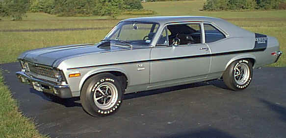

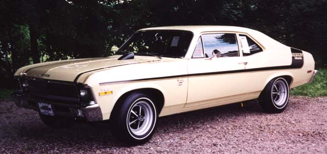

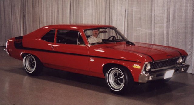

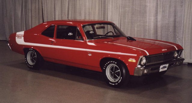

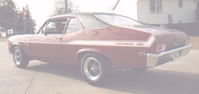

1970 Yenko "Deuce" Nova |
4 speeds: 122 |
Autos: 53 |
Total: 175 |
731 | Standard interior, black | This was the standard black vinyl, bench seat | ||
G80 | Axle, rear, posi, 4.10 | 12 bolt housing, and a special ring/pinion replaced the standard units under COPO 9737. | ||
JL2 | Brakes, power, w/disc front | This option was required by Chevrolet on all COPO cars ordered. | ||
L65 | 350/250hp engine | This was the base 350ci engine in the Nova, and was replaced with the LT-1 when COPO 9010 was ordered. | ||
M20 or M35 | Wide ratio 4-speed or 350 Turbo-Hydramatic transmission | The M20 was the base 4-speed transmission in the Nova, while the 350TH was the base 3-speed automatic transmission in the Nova. Both of these transmissions were replaced by either the M-21 or 400TH whenever COPO 9737 was selected. | ||
N10 | Exhausts, dual | Dual exhaust was standard on 250hp or base V-8 (307) engines. | ||
U63 | AM radio | The AM radio was standard. | ||
ZJ3 | Special interior group | This included the bright trim on pedals, mirror, dome light, ect. | ||
9010 | 350/360hp "LT-1" engine | This deleted RPO L65 and added the same engine as used in the Z/28 Camaro. | ||
COPO engine code: |
CTB = 4-speed, CTC = automatic | |||
9737 | Sports Car Conversion | This deleted F40 and M-20, and added the F-41 suspension (which included the addition of a 13/16" front sway bar and added a rear sway bar, and was originally an SS only option), either the M-21 or 400 Turbo-Hydramatic transmission, and a special heat-treated ring and pinion. | ||
CBW = special HD, 4.10 posi | |||
P0xxxB = M-21 or 70Wxxx = 400TH |
First 125 cars (5 colors ordered): |
Cortez Silver | Cortez Silver w/white stripes | Cortez Silver w/black stripes |
Cranberry Red | Cranberry Red w/white stripes | Cranberry Red w/black stripes |
Fathom Blue | Fathom Blue w/white stripes | Fathom Blue w/black stripes |
Forest Green | Forest Green w/white stripes | Forest Green w/black stripes |
Gobi Beige | Gobi Beige w/white stripes | Gobi Beige w/black stripes |
The first 125 cars were ordered in 5 colors, with 25 cars of each color being ordered, but there was an uneven split of cars ordered with the 4-speed, automatic, and power steering options. |
Last 50 cars (5 colors ordered, including 3 new colors): |
Citrus Green | Citrus Green w/white stripes | Citrus Green w/black stripes |
Hugger Orange | Hugger Orange w/white stripes | Hugger Orange w/black stripes |
Sunflower Yellow | Sunflower Yellow w/white stripes | Sunflower Yellow w/black stripes |
Due to demand, 50 more cars were ordered, this time with 3 new colors replacing 3 old colors, and 10 cars of each color were ordered. Once again, there was an uneven split between cars ordered with the 4-speed, automatic, and power steering options. It is believed this second order of cars were most likely modified with Yenko specifics of stripes, wheels, Dixco hood tach, ect. by Hurst Performance in Detroit, MI. |
Yenko Novas could have came with any/all/none of the following options: Yenko Deuce side stripes, Yenko Deuce hood stripes, Deuce interior decal, Yenko emblem(s), "Torque Thrust" style wheels, Dixco hood tach, after market guages, [NOTE: to see how the Yenko "Deuce" Novas were equipped when they arrived at Yenko Chevrolet from the Chevrolet assembly plant, check out the COPO page.] |

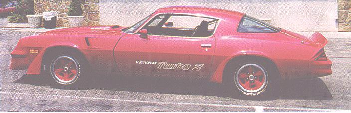

1981 Yenko "Turbo Z" Camaro |
Number produced: | |||||||||||||||
4 speeds: 0 |
Autos: 19 |
Total: 19 | |||||||||||||
1FP87 |
Z-28 sport coupe | This included a special ducted hood, special shocks/springs, HD stabilizer bars, dual exhaust, power disc brakes (front), and body colored 15x7" wheels with white-lettered tires. The base engine/trans for the Z-28 was the LG4 (305ci/165hp) and 4-speed wide range transmission. All '81 Yenko Camaros started out as Z-28 cars. | |||||||||||||
LM1 | Engine, V8; (350ci/175hp) | The 350ci V-8 was optional with the Z-28, but mandatory on all Yenko Turbo Zs. | |||||||||||||
Engine code: |
D5B = automatic | ||||||||||||||
MX1 | Transmission, automatic; THM350c | This was the mandatory transmission on the Z-28. | |||||||||||||
Rear end code: |
PW = 3.08, posi | ||||||||||||||
Y1xxx = THM350c | ||||||||||||||
Yenko options: | Stage I | T.I. Turbocharger, autmoatic transmission, Stage I wheels, Turbo Z graphics. The Stage I package was standard equipment on all '81 Yenko Camaros, but all factory options (except sunroof) are available, as well as any of the Stage II options.. | |||||||||||||
Stage II | Same as Stage I, plus: fully adjustable Kamp leather seats, leather competition steering wheel, Turbo Z special floor mats, Koni shock absorbers, modified stabilizer bars, modular wheels, and Goodyear Wing-foot tires. Along with the Stage II package, all factory options (except sunroof) were available. | ||||||||||||||
After the insurance companies and the oil crisis hit, Yenko's high performance department cooled off a little. In 1981, Yenko decided he needed another kick--the '81 Yenko Turbo Z. This car was the last car built as the dealership changed ownership. This car has 32,000 miles and is believed to be #19. The mostly original interior, and mostly original paint and graphics are still in tact. |
