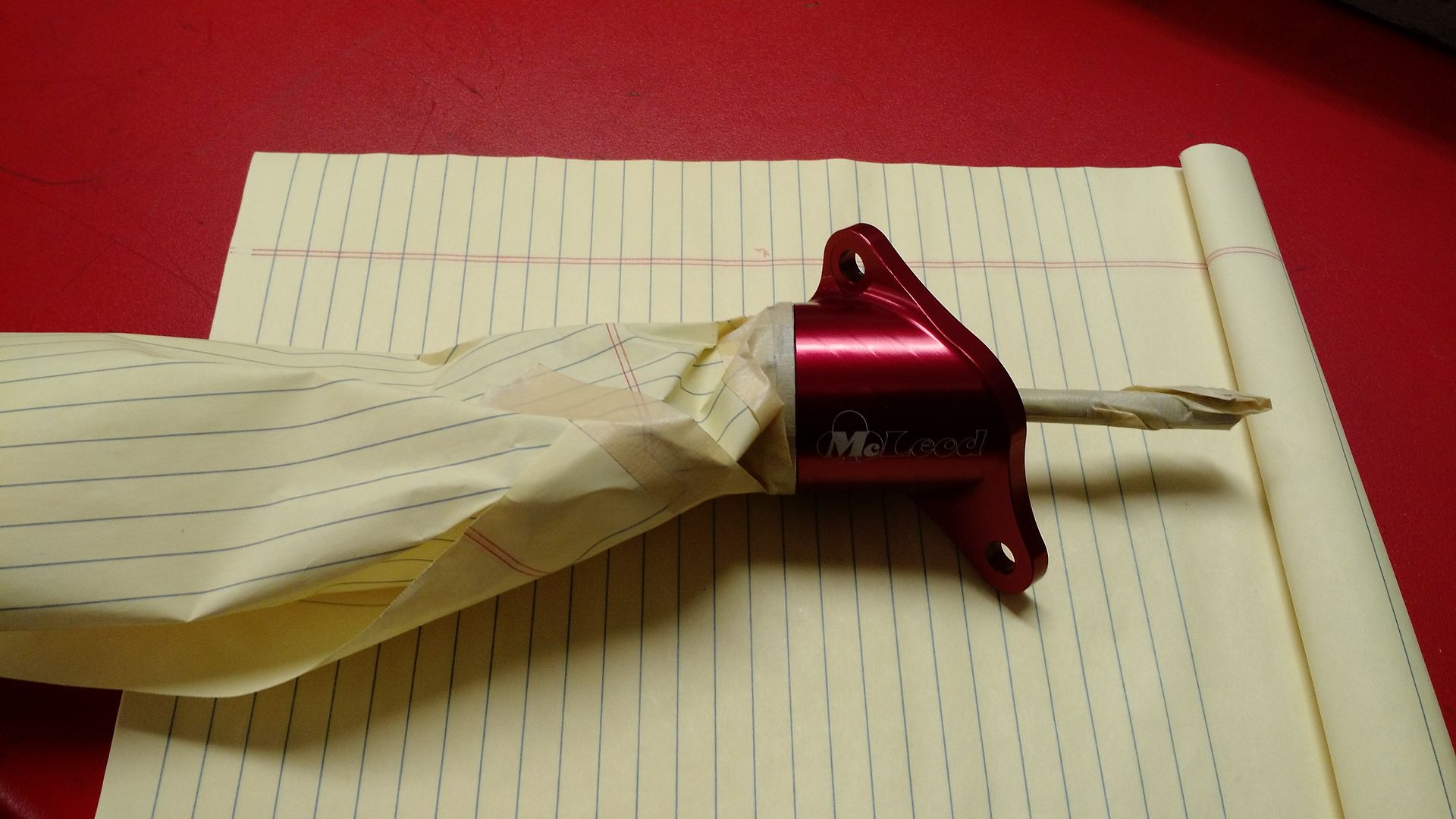

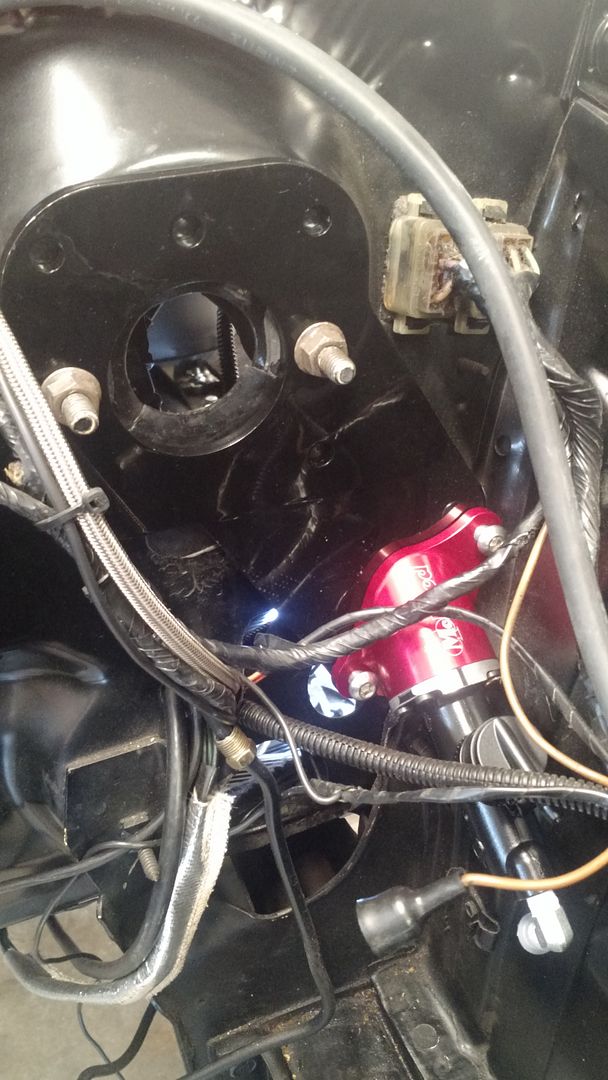

Also have been working on some little things. Naturally, there is no such thing as a bolt in. Just getting everything fitted for the clutch master. Had to grind on the mounting plate for the master as it hit the inner fender.
http://i1043.photobucket.com/albums/...ps36htkjwb.jpg
After some finessing, looks like the master is mounted correctly, and will provide the right geometry for the pedal ratio. Just have to tidy up some wiring.
http://i1043.photobucket.com/albums/...pspizq0hhm.jpg
I hate the red on the master, so it needs to be black..............Nice masking paper eh?
http://i1043.photobucket.com/albums/...psetgtzasj.jpg
