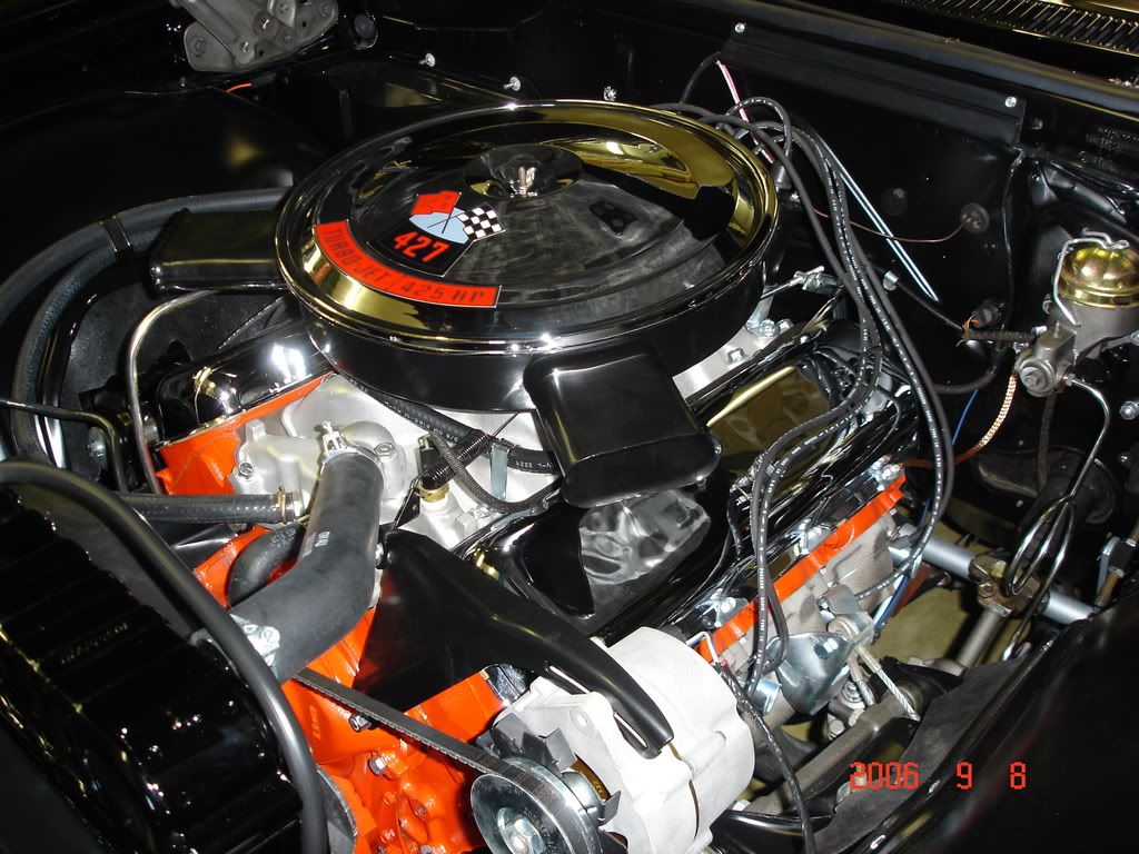

Here's the Madiera Maroon...(I think)
Compliments of Kevin! https://www.yenko.net/ubbthreads/imag...lins/beers.gif
Humm..........Look at the difference in the Alternator Brackets between the Maroon car and Jody's Black 66 425 H.P. car........Are they both correct.....Early vs. Late etc.??????
http://i19.photobucket.com/albums/b1...n_DSCF6126.jpg
http://i13.photobucket.com/albums/a2...odysCar003.jpg
Ken https://www.yenko.net/ubbthreads/imag...mlins/flag.gif
The bracket was probably cut. GM didn't make one like that. The bracket in the 2nd pic is correct. My favorite GM mole can't find any documentation to support that short design. Cutting it like that weakens the support for the alternator. Things twist under load. That's why they changed it from the 1965 design. You don't want to have belts flying around at 7 grand! Since we're picking, the upper heater hose nipple on the intake isn't factory correct in the 1st pic. 2nd pic (Jody's) is factory correct. I guess Jody or previous owner added the engine chrome.
Ken, the bell housing should be #3872444. Fan looks good. I've seen 2 designs. That's one of them. Why so many digits in the part number of the crank pulley??

-----Im not sure if Im seeing things correctly, but it appears as though Jodys car has the bolt missing from that correct alternator bracket that would go thru to the intake. That would promote a bunch of twist as well!!!........Bill S

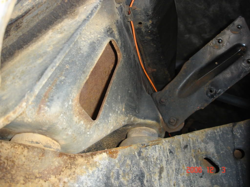

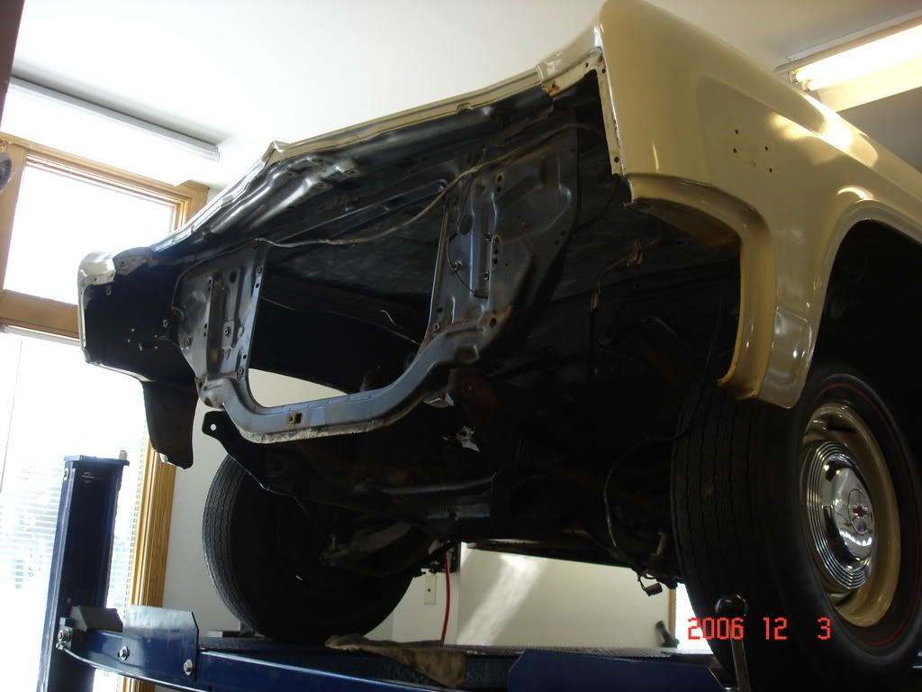

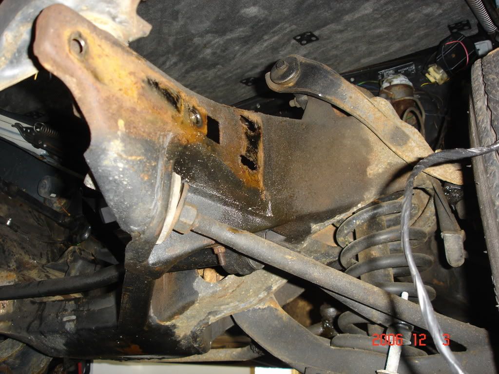

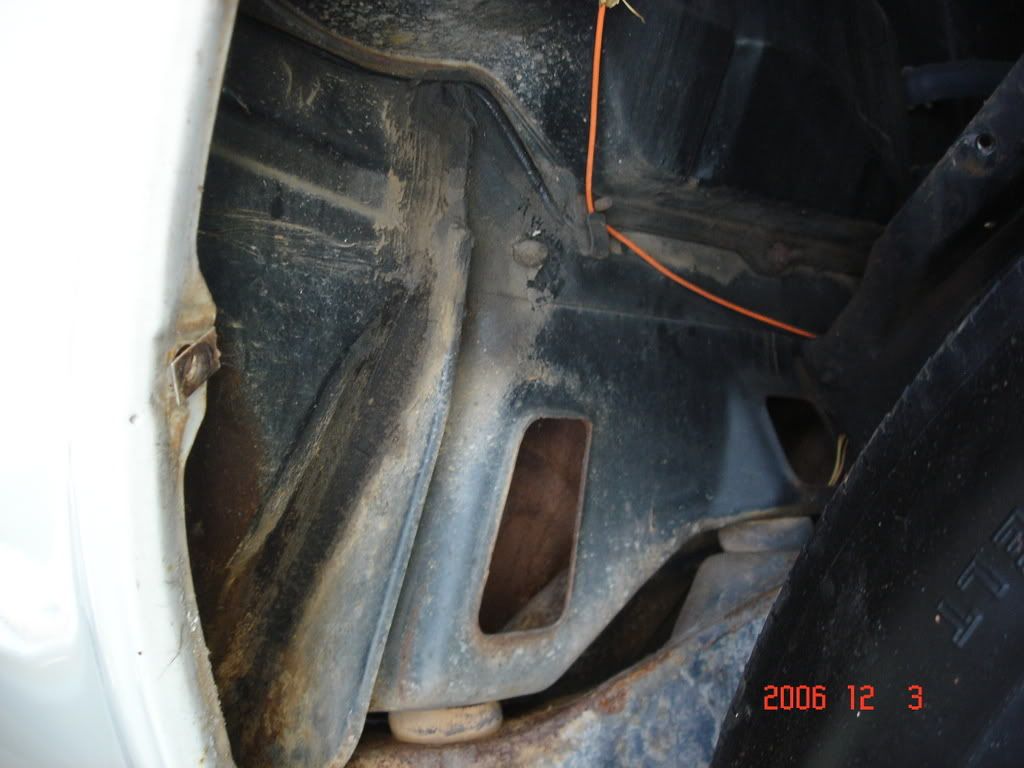

Pulled the front end apart today........Here are more B4 pic's
http://i13.photobucket.com/albums/a2...t/DSC03583.jpg
http://i13.photobucket.com/albums/a2...t/DSC03582.jpg
http://i13.photobucket.com/albums/a2...t/DSC03580.jpg
http://i13.photobucket.com/albums/a2...t/DSC03581.jpg
http://i13.photobucket.com/albums/a2...t/DSC03589.jpg
Ken
