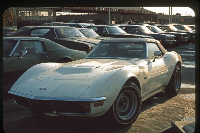

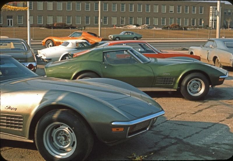

After a whole lotta research I was able to locate some Canadian documentation and pricing. Canadian window stickers are the rarest pieces of paper in the universe. They were completely different than the US counterpart. The form is different, the prices were higher and most dealers removed them from the cars beofre the sales since there was no Monroney Law in Canada like there was in the US.
Here is an example of a 1972 Corvette window sticker that was photographed along with a bunch of Corvettes at a Canadian dealer lot in 1972:
http://i599.photobucket.com/albums/t...72-5Custom.jpg
http://i599.photobucket.com/albums/t...72-6Custom.jpg
http://i599.photobucket.com/albums/t...72-1Custom.jpg
http://i599.photobucket.com/albums/t...72-2Custom.jpg

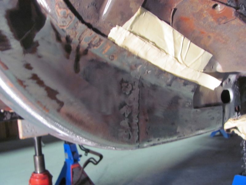

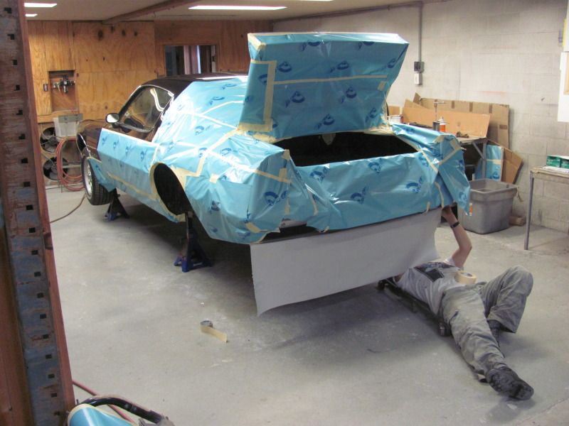

Finally got the car back today after the rear frame rail repairs which took a lot longer than expected. (surprise!). So at least the structural fix is done. I'll save the trunk drop offs and rear outer wheel house repairs for the winter when I pull the motor to regasket it.
Here are some shots of the frame repairs taken by the bodyman:
The underside of the trunk floor once the driver's side frame section was removed. Looks very clean.
http://i599.photobucket.com/albums/t...s72js63072.jpg
And the replacement driver's side rail section being trial fitted:
http://i599.photobucket.com/albums/t...s72js63083.jpg

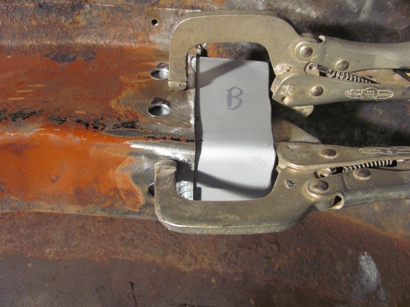

He used leftover sections of the new rail to form inner braces to weld through the rails, to. This way the rails arent just butt welded end to end. He did this for all the frame sections.
http://i599.photobucket.com/albums/t...s72js63094.jpg
The pass front rail with the welds all ground down:
http://i599.photobucket.com/albums/t...s72js63103.jpg
http://i599.photobucket.com/albums/t...s72js63101.jpg
And after some body filler was applied:
http://i599.photobucket.com/albums/t...s72js63114.jpg
Masking off for painting (actually the red oxide primer).
http://i599.photobucket.com/albums/t...s72js63160.jpg

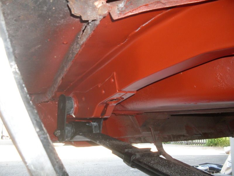

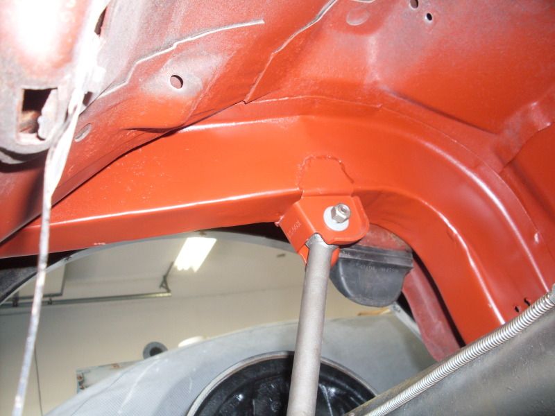

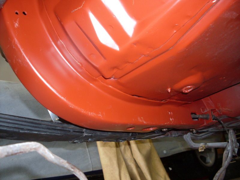

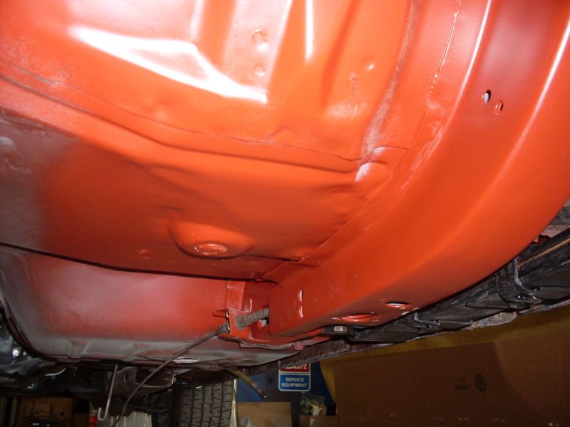

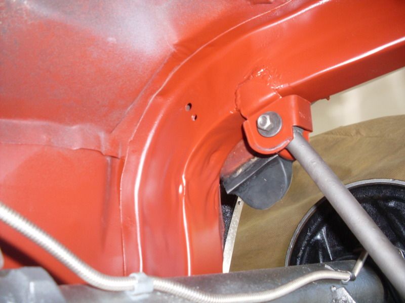

njsteve 08-16-2012 07:48 PM
Re: The New Project: Part Deux!

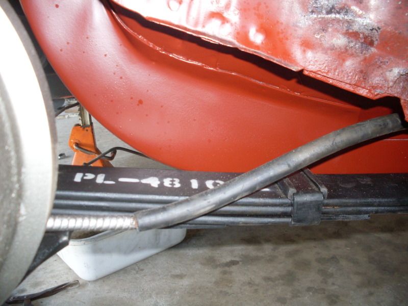

Here are the finished frame repairs in red primer. Now it's back to the garage to install all my parts. After these baseline photos were taken I got out the black spray can and duplicated the original black overspray on the frame rails. I did it just as sloppy as the Norwood assembly plant guys did. [img]<<GRAEMLIN_URL>>/grin.gif[/img]
http://i599.photobucket.com/albums/t...c/SDC11598.jpg
http://i599.photobucket.com/albums/t...c/SDC11600.jpg
http://i599.photobucket.com/albums/t...c/SDC11603.jpg
http://i599.photobucket.com/albums/t...c/SDC11606.jpg
http://i599.photobucket.com/albums/t...c/SDC11601.jpg
http://i599.photobucket.com/albums/t...c/SDC11602.jpg
http://i599.photobucket.com/albums/t...c/SDC11599.jpg

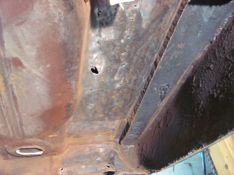

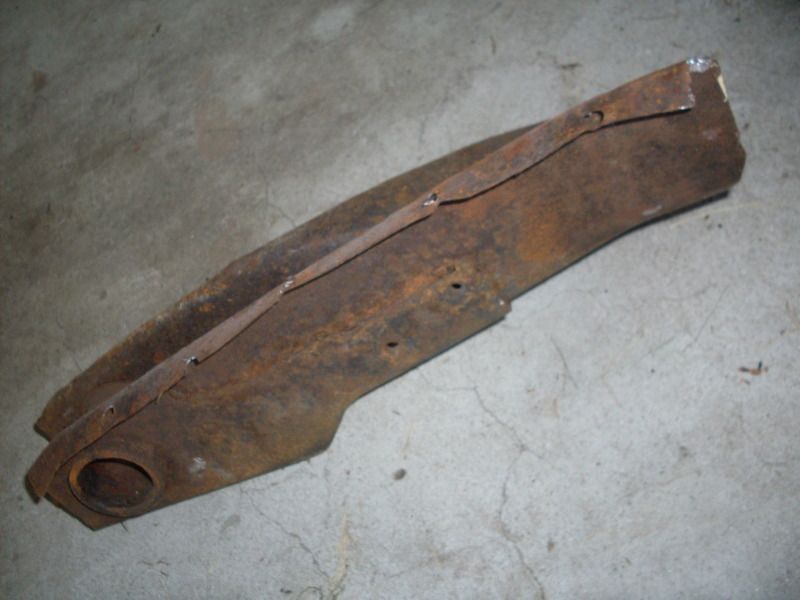

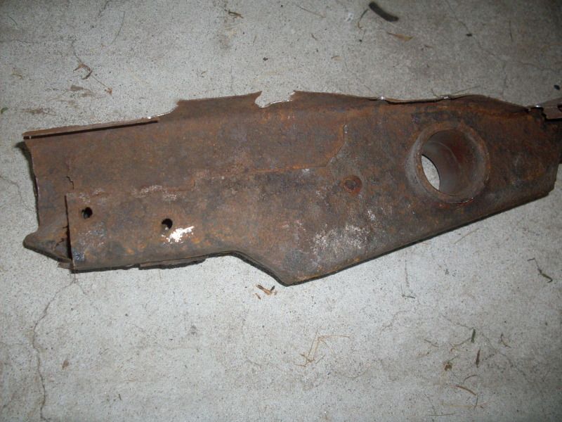

njsteve 08-16-2012 08:09 PM

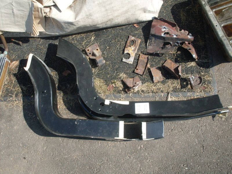

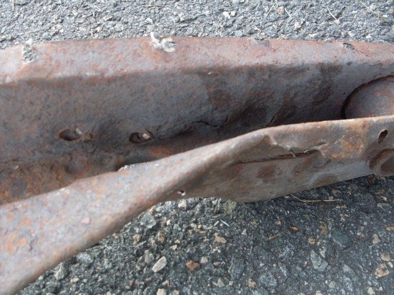

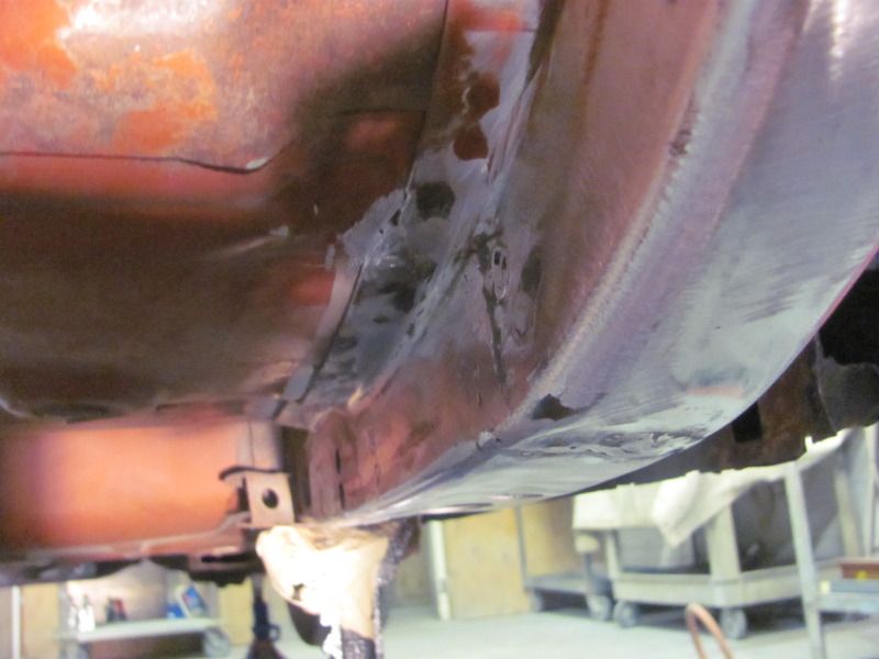

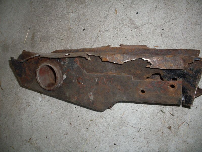

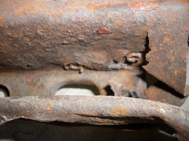

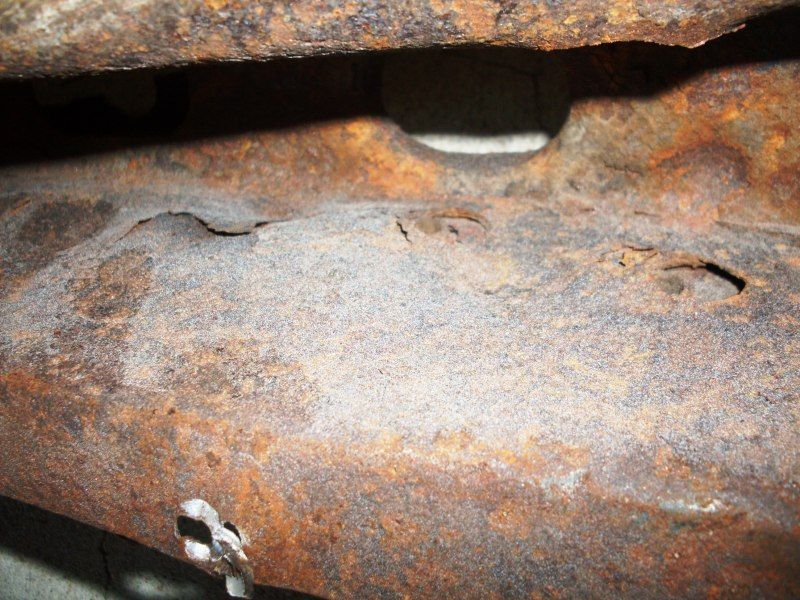

And in case you'r wondering what the old rail pieces looked like, here you go. Both sides were swollen and corroded where the two panels were welded together by the exhaust hangers. A real moisture trap, just like the lower sections of the rails by the front leaf spring perches.
http://i599.photobucket.com/albums/t...c/SDC11626.jpg
http://i599.photobucket.com/albums/t...c/SDC11625.jpg
http://i599.photobucket.com/albums/t...c/SDC11624.jpg
http://i599.photobucket.com/albums/t...c/SDC11627.jpg
http://i599.photobucket.com/albums/t...c/SDC11616.jpg
http://i599.photobucket.com/albums/t...c/SDC11628.jpg
I'm glad I got the full rails. Here's what's left, and some of the rusty, mangled front lower rail remnants:
http://i599.photobucket.com/albums/t...c/SDC11615.jpg
