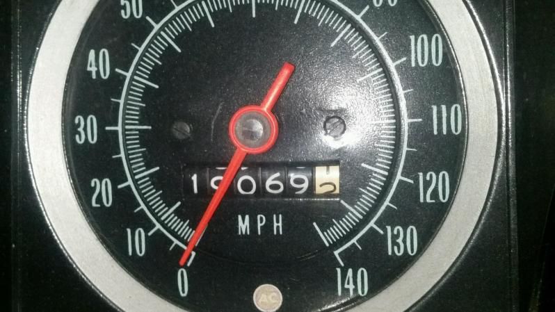

Wow, you guys are detailed!!!
The Firebird repops are actually very accurate, but since all 68-69's came with the same speedo, there was never an effort to just make a silk screen version.
Great info, thanks guys. [img]<<GRAEMLIN_URL>>/biggthumpup.gif[/img]

The picture Brent posted of the 140 certainly looks like an early decal version to me. Look at the right side, the numbers from 90 to 140 are almost to the aluminum edge, not at all like the originals or later repros.

Brent - spend a couple of minutes &amp; look at it more closely before we bring Sherlock Holmes out of retirement!

Is this from your Orange car or another treasure hunt find ?
The Orange car is apart and at SCW....correct ?
Then its a matter of pulling it from the housing....
as you're gonna clean it up as well..... yes?
I went through my stash finding 7 speedos....they all have the indent into the aluminum face as well as all the Originals pictured.
I think its real. ...after all this.. unless it is a decal.

The backside is the best way to tell, the originals will have the printed numbers/lines visible in the aluminum.
