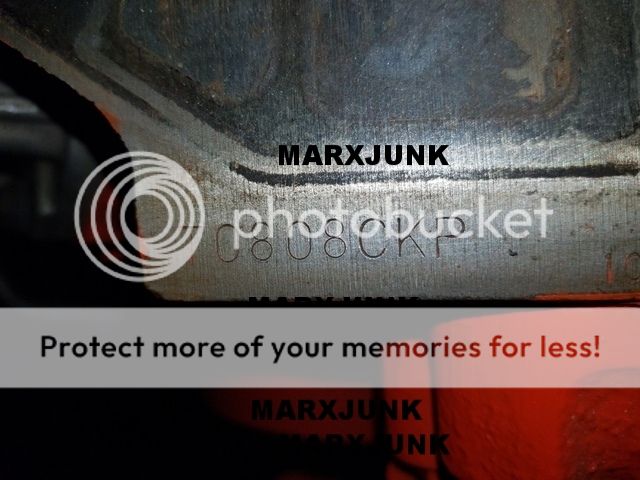

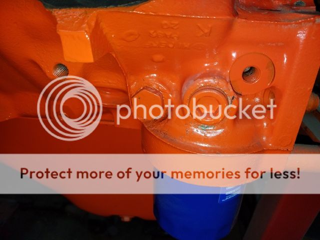

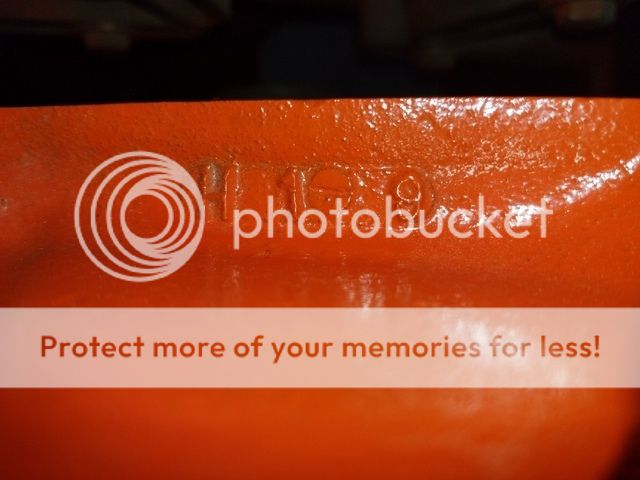

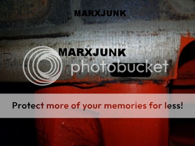

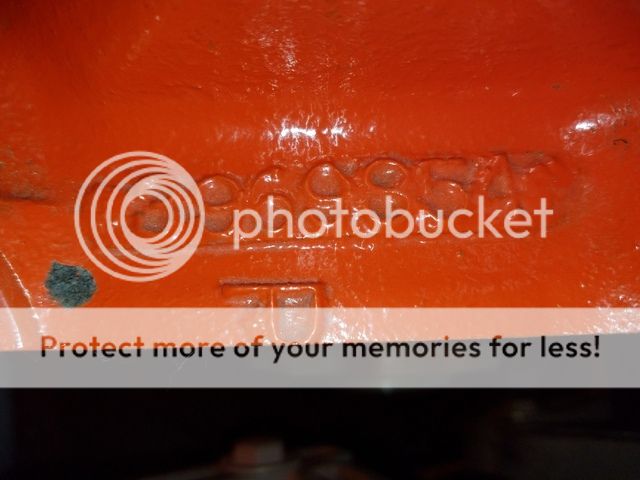

marxjunk 10-11-2016 01:33 PM
Re: 70 l89 NOVA?
will never happen..i will never get the heads..ever
here we go..until i figure out if the car is still in existence i wiped out the last of VIN and water marked them...and i do have a a line of ownership on the motor 3 people back now, so i will start working on it...but i fear its going to be a dead end..
SO WHAT DO THE EXPERTS THINK..AUTHENTIC STAMPS?..
http://i396.photobucket.com/albums/p...psb5t3hfnz.jpg
http://i396.photobucket.com/albums/p...psyklter0f.jpg
http://i396.photobucket.com/albums/p...psfnrndzch.jpg
http://i396.photobucket.com/albums/p...psjzhzkpzy.jpg
http://i396.photobucket.com/albums/p...pswspyx0co.jpg
scuncio 10-11-2016 01:44 PM
Re: 70 l89 NOVA?
Wow. Pretty cool. The W in the VIN stamp looks a little off to me, but I'm not a Nova expert by any means.
L78steve 10-11-2016 01:44 PM
Re: 70 l89 NOVA?
Wow, Looks good. Never say never on the heads.
BLACKLS5 10-11-2016 01:45 PM
Re: 70 l89 NOVA?
I'm not an expert but I don't like it.
