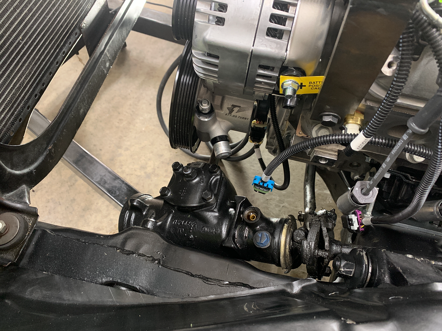

So....Using the Holley Engine Trans install kit I decided to give it a try and see if there were any issues...... Again, the Holley kit is engineered perfectly as the engine and trans slid in and bolted right up....... Wow.... Great to buy something that actually does what it's supposed to do....... Another one of my concerns was in my choice to buy the Holley Mid-Mount front drive assy..... I was told there would be a clearance issue with the power steering pump reservoir and the steering box...... We are installing a Hydra Boost so I decided to gamble and buy the unit anyway....... That was the first thing I looked at after installing the engine..... Plenty of room......the gamble paid off ........ I also bought some shorty headers that were supposed to fit..... LOL.... Just ordered the Hooker long tubes headers designed by Holley so I know the will fit when they get here......... Again... I realize I can't afford "Cheap" stuff !!!!...... LOL.... Now to get the wiring sorted out and hidden.....

In addition to the new Hooker headers I also ordered the complete Hooker exhaust system engineered for this install..... Here's a pic of the Engine with the wires moved so you can actually see it...... LOL....... Chris also bought a set of Holley valve covers which hide the coils and wiring.......Gonna wait till I get the headers installed before going any further on the engine so I don't get ahead of myself....
