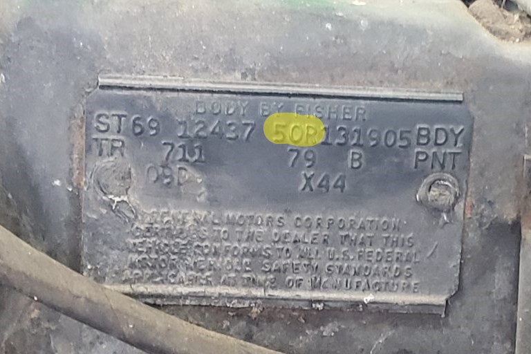

rlw68 12-04-2021 04:13 PM
1 Attachment(s)
In 'Echoes of Norwood' p98, there's a picture of the body plate stamping machine connected to a card reader. If the cards were the source of errors they would need to include the Fisher build date. The date, like the plant code NOR and other legal jargon, was most likely set on the machine.
The substitution of a 5 for an N would be one heck of a typo ! :eek2:
Attachment 208534
70 copo 12-04-2021 06:01 PM
Rob,
Good observation... The repetitive data fields like the date of production week and the plant were on the programming spool (drum). This was to save key puncher time and reduce errors this is called programming driven entry.
If the programming drum for the week has the wrong date or is simply not changed timely that is a factor in batch errors in all the card readers.
Review this video starting at minute 1:38
70 copo 12-04-2021 06:10 PM
Rob,
An error like 5OR is likely a reader error.
Note the warning in this video at minute mark 1.00
