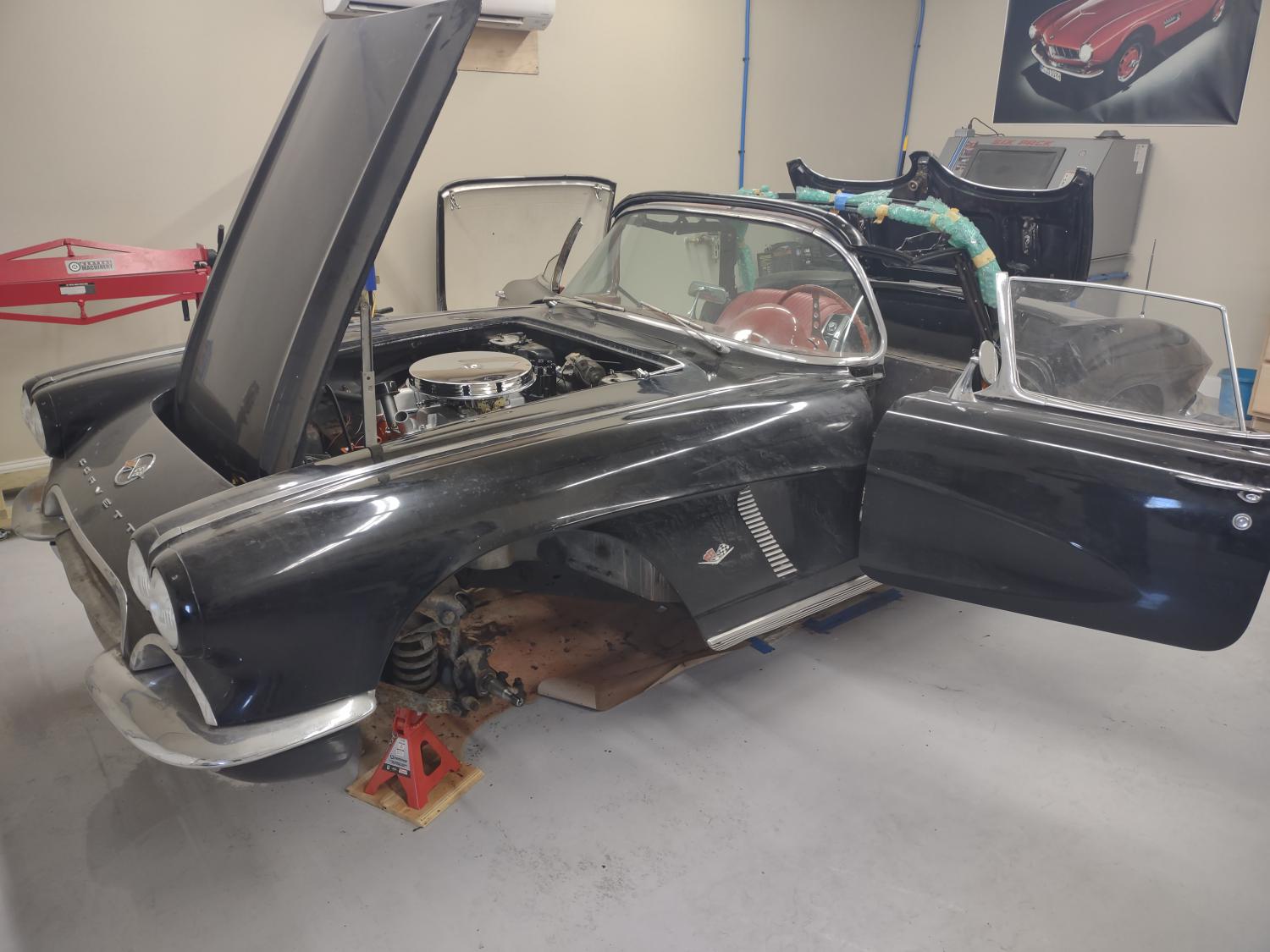

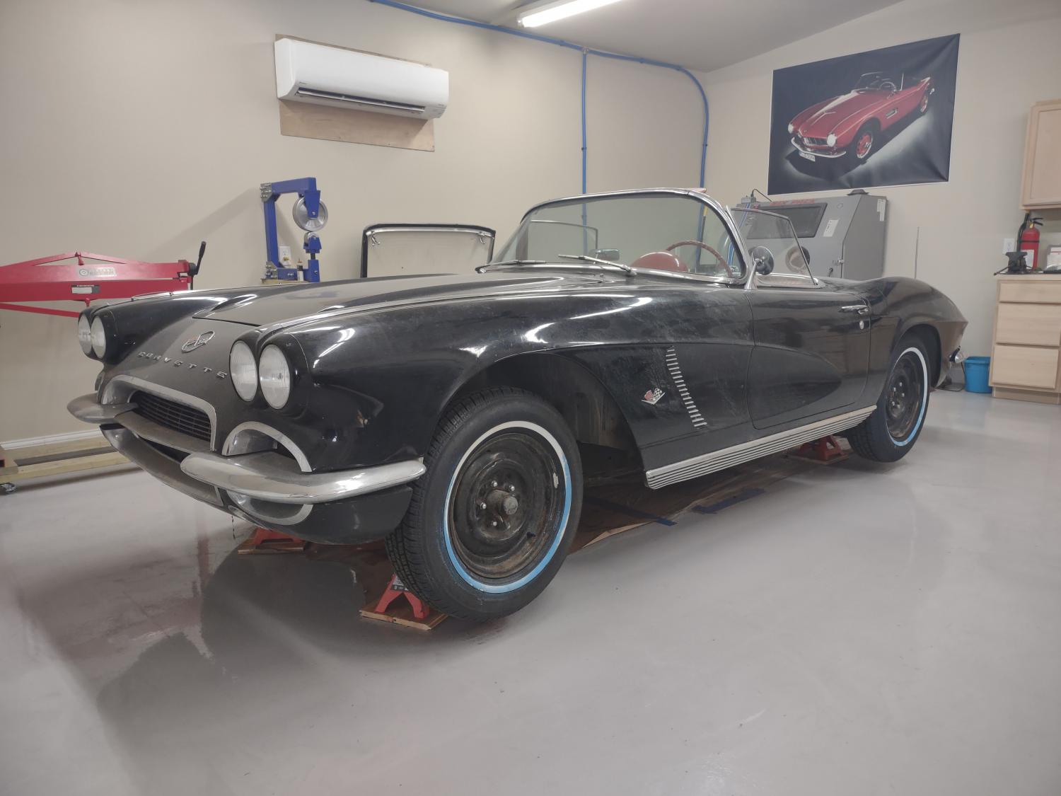

A12pilot 02-06-2022 10:18 AM
9 Attachment(s)

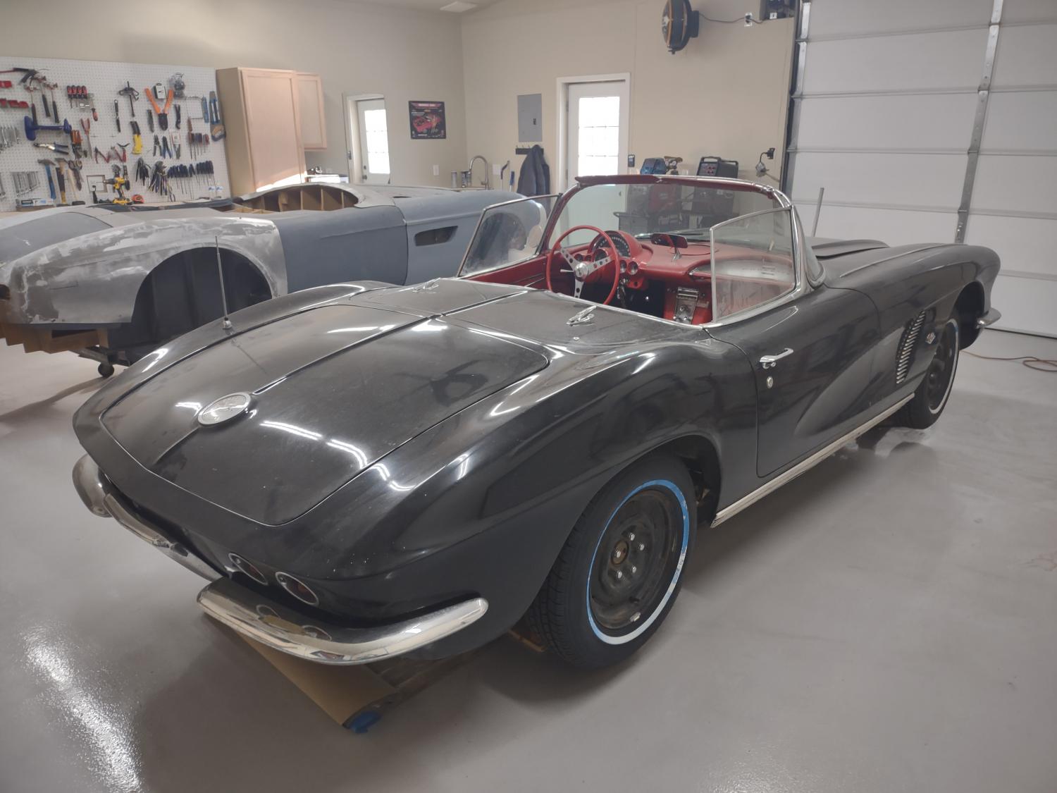

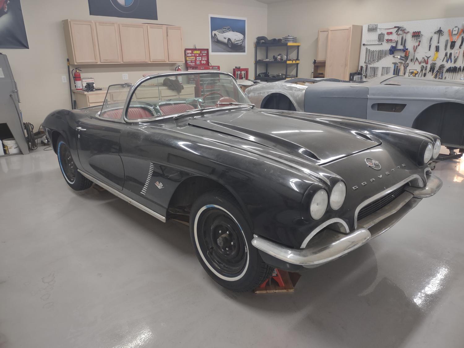

Here you go Ryan!:biggthumpup:
Attachment 213085
Attachment 213086
Attachment 213087

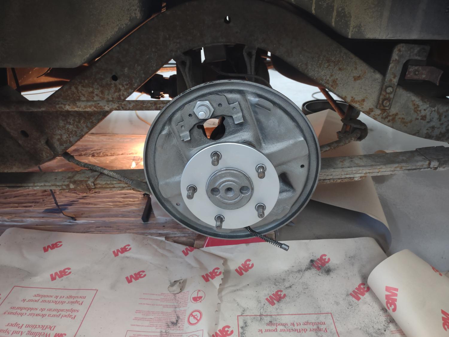

So a good day tearing into the old Vette. I'm replacing the main harness with a new one and it seems to me that things were thrown together under here haphazardly. I think this car was apart at some point but don't know the history on it. :no: But based on things in seeing not hooked up and routing of the harness, I think it definitely has something going on. But up first is more mechanics: brakes!

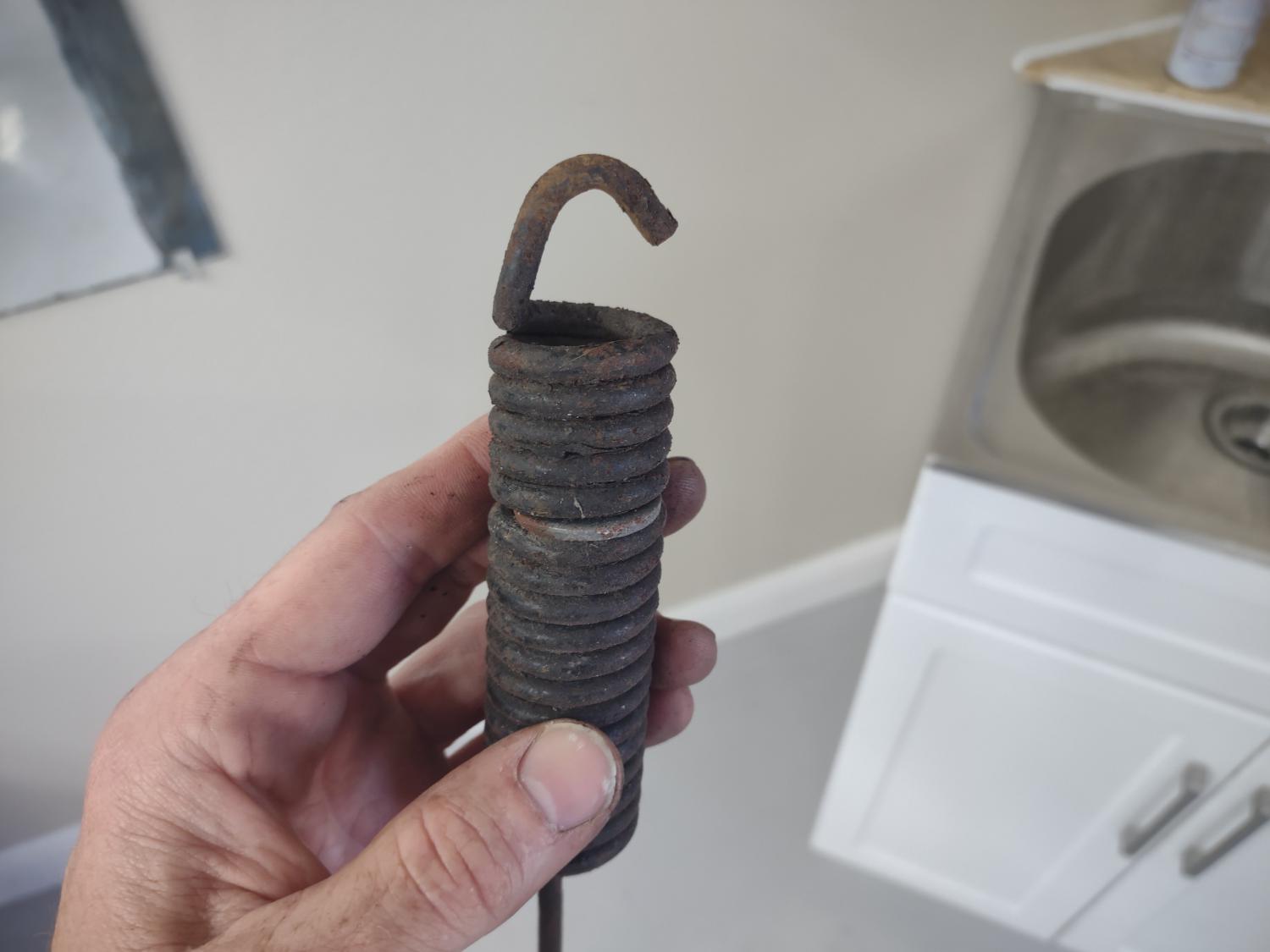

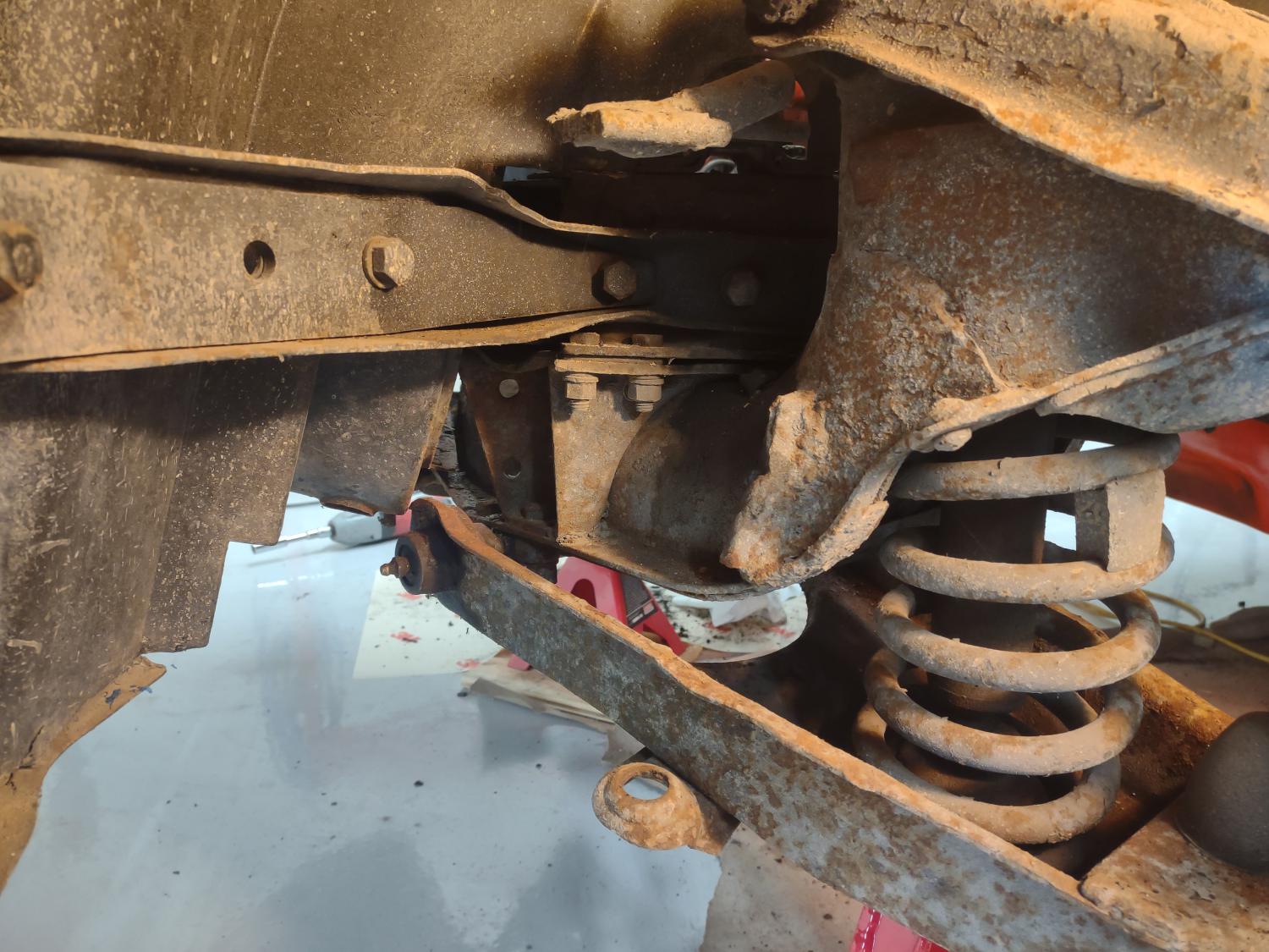

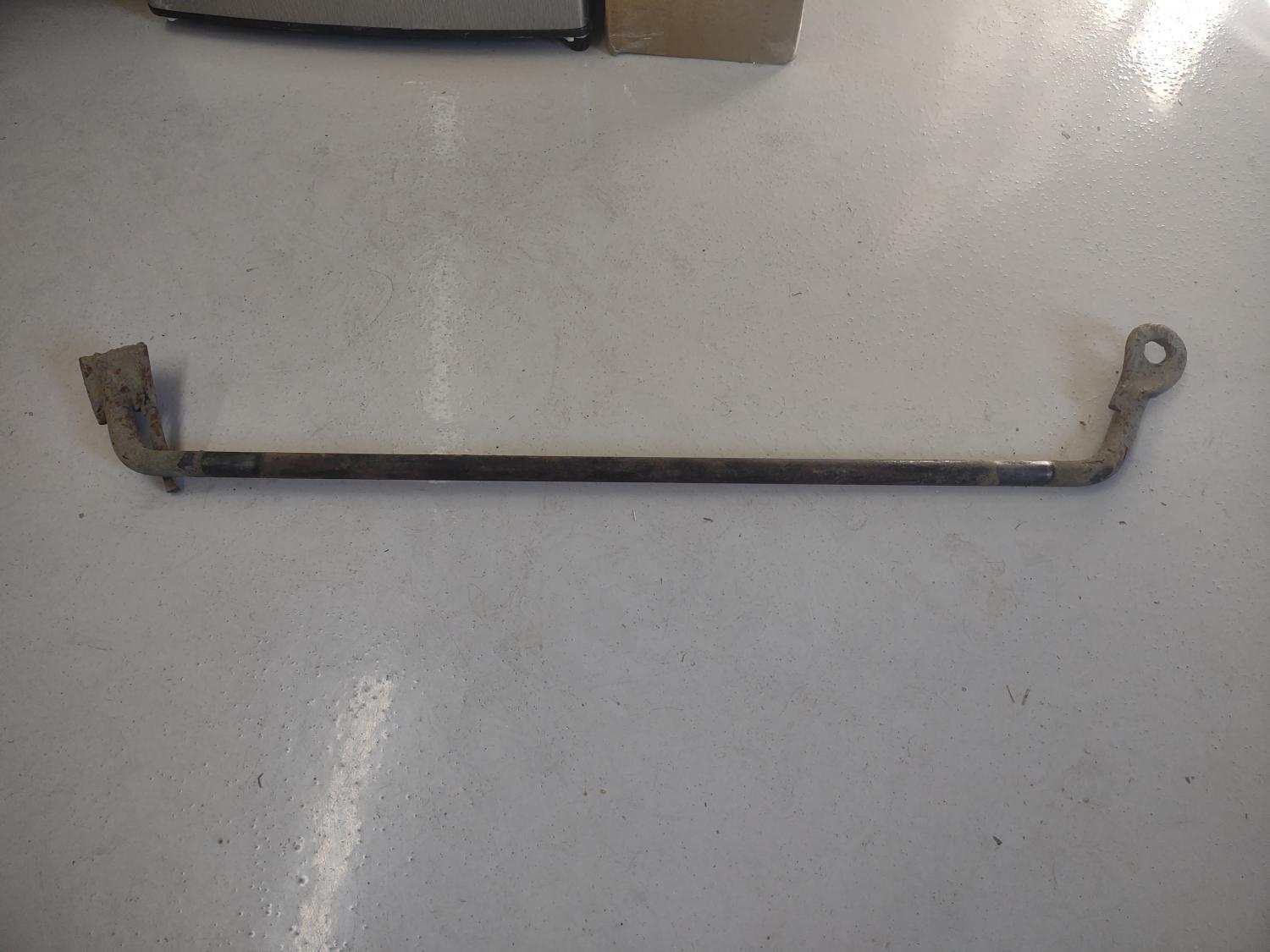

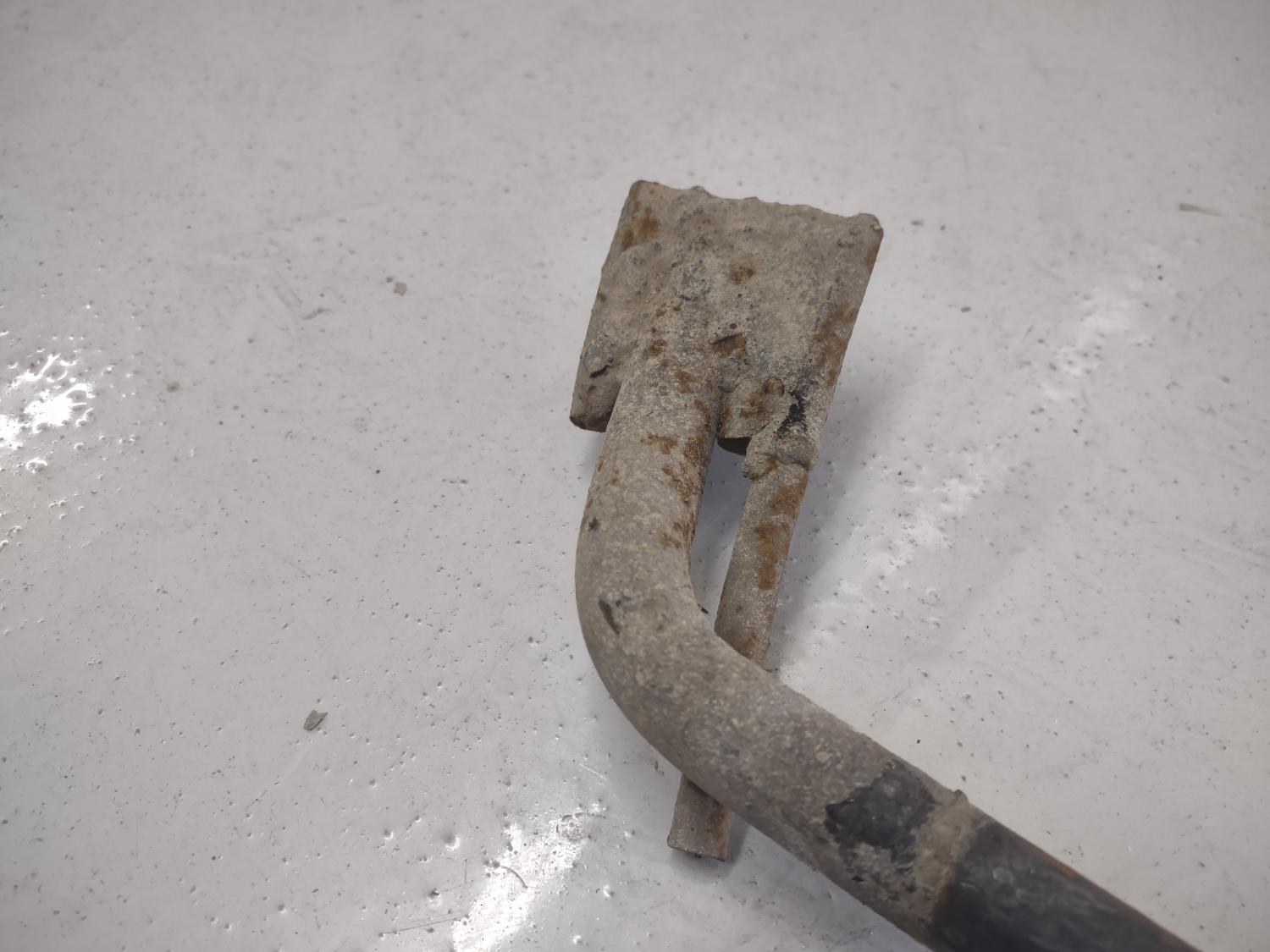

One often wonders what's happened to these cars over the years. And looking at the sway bar, one has to really ask, "What the....???:hmmm:"
Attachment 213088
Attachment 213089
So any idea what that could be? Welded ends, some sort of bracket welded then cut off the spring perch. I was thinking maybe they did that for a make shift tow bar or something. Weird.

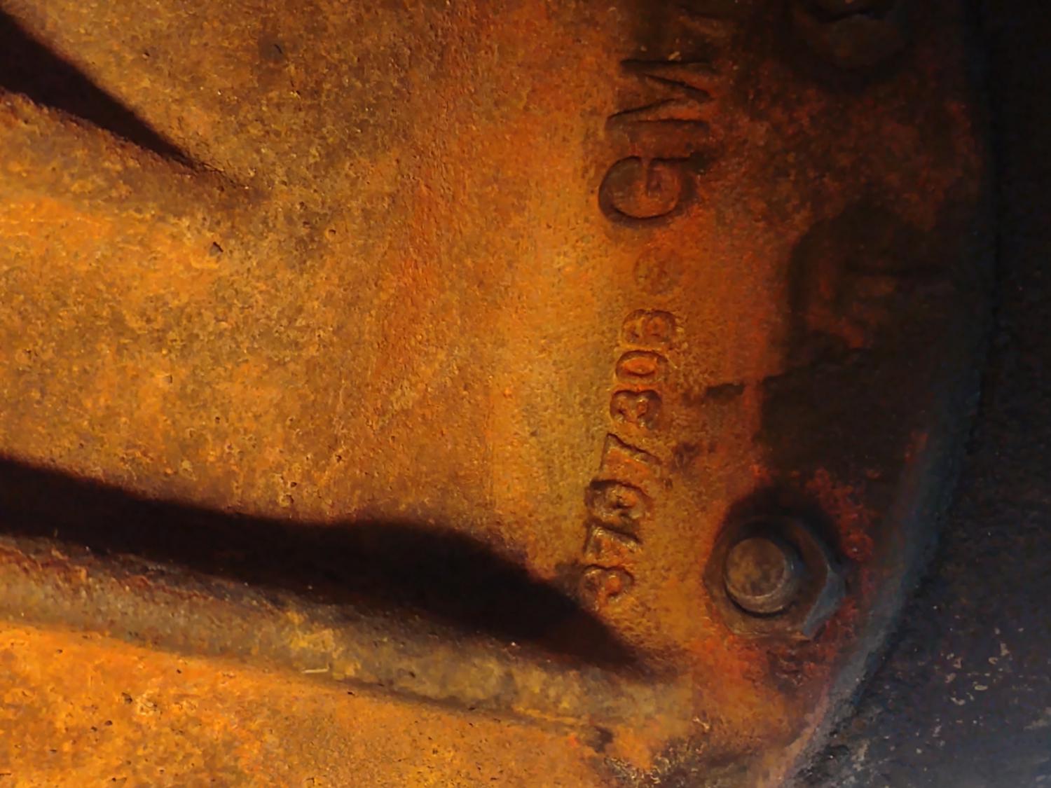

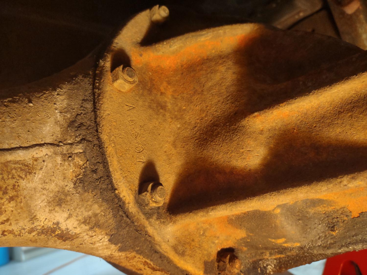

So the rear axle I know was swapped. At least the center section was. This car has all the traits of a 340 car, but missing a couple so I figured the rear axle would be a good clue to add to the evidence. But sadly, the code "AB607" doesn't decode to a 62 Vette. Also, the carrier number is there, but no date. So what's the deal with that..... Tim!?:dunno:

Picture of the axle info.....
Attachment 213094
Attachment 213095
