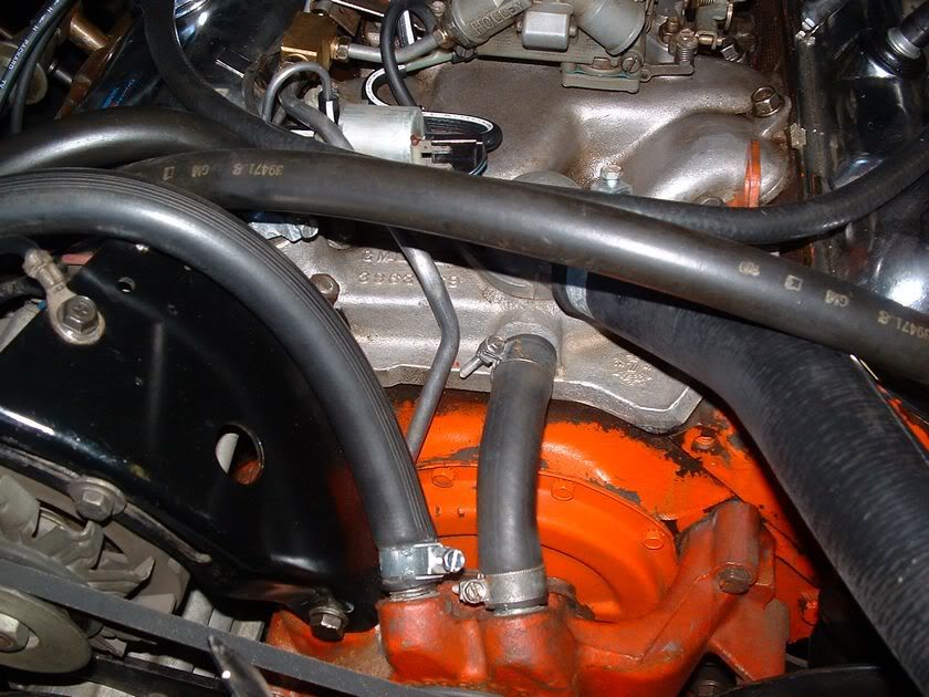

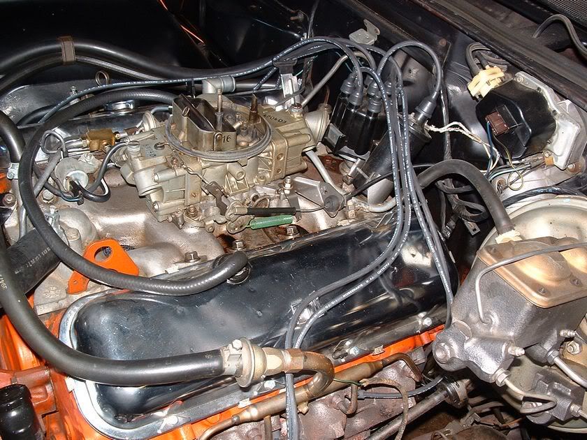

Rick, I was most certainly wrong about Cumby having a L-78 Chevelle. What I meant to say, was that Cumby's Survivor LS-6 w/o cowl induction and having the Dual Snorkel Air Cleaner was a very good source of reference for 70 L-78 Camaro restorers.
What configuration of left smog tubes are the top restored LS-6 Chevelles using with and w/o cowl induction....
I am also looking for a survivor 1st design left hand smog
hose 39471?8
http://img.photobucket.com/albums/v4...n_Dec05032.jpg
http://img.photobucket.com/albums/v4...n_Dec05039.jpg

"What configuration of left smog tubes are the top restored LS-6 Chevelles using with and w/o cowl induction"....
Most are putting on the over the valve cover tube even if it's not accurate for their early build,but either design will fit fine when Cowl Ind. equipped or not.
I believe it is due to owners not knowing there was a design difference & revision date for this tube,(as noted in the 1970 Chevelle Ass. manual),as well as most reproduction houses only carry the later issued over the valve cover design tube anyway.
