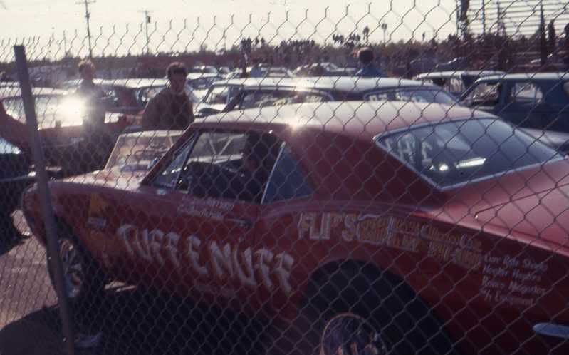

Dog427435 06-14-2008 09:50 PM
Re: Hood Scoop
Wow - That is a lot of work - takes skill and some finess -
Now I know why I saw a lot of square boxes back in the day!
http://i158.photobucket.com/albums/t...5/img019-2.jpg
