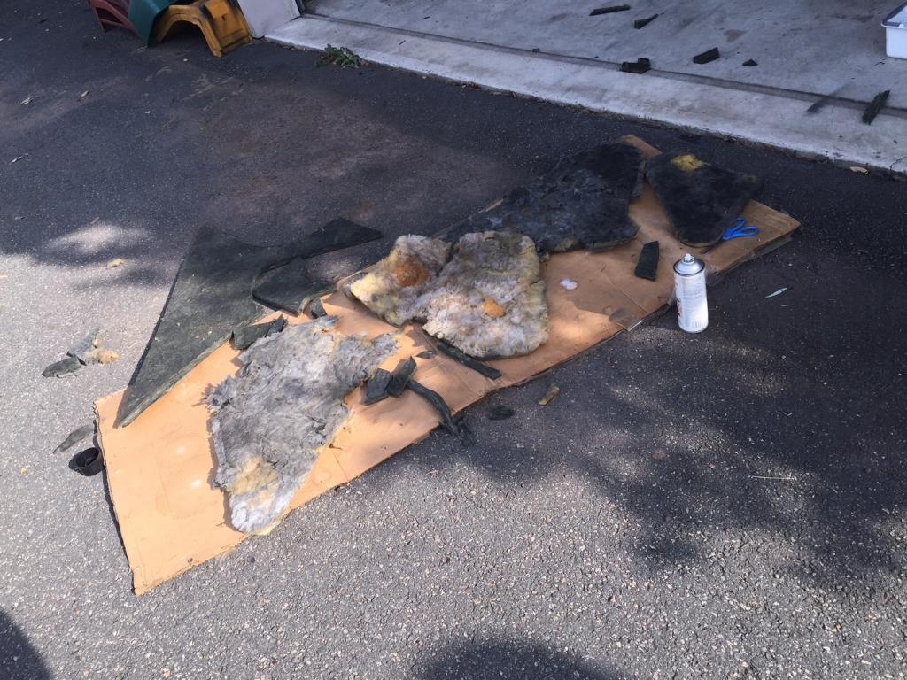

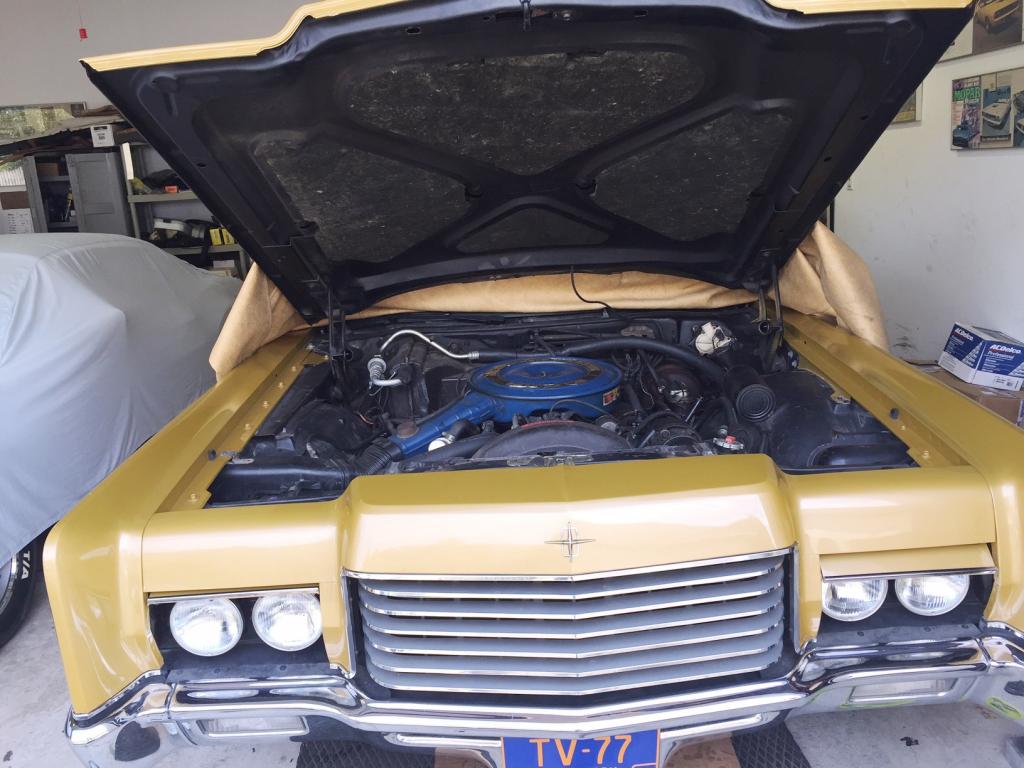

Thanks to Enio45, who sent me the bulk section of hood insulation he found, I was able to reproduce the original insulation sections for the hood on Grampa's Lincoln. Hopefully the mice won't like this stuff as much as the old stuff they chewed up while it sat in my Dad's garage for a few decades. I'm glad I saved the old pieces to use as patterns.
The whole process only took about a half hour (minuse the several times I had to chase the stuff across the driveway when a gust of wind came through). [img]<<GRAEMLIN_URL>>/rolleyes.gif[/img]
