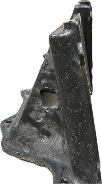

BB Camaro AC Suitcase
1 Attachment(s)
I lied... Apologies.
The BB Camaro AC Suitcase outer half is also different. The angle off the firewall is different between SB & BB. I did not notice until I had the two pieces side by side.
Small block inner half in foreground, angled a little more towards the engine, BB inner half behind it.
Attachment 271581
