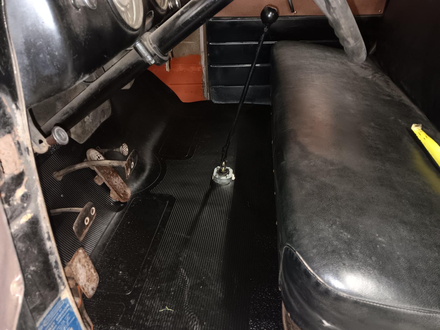

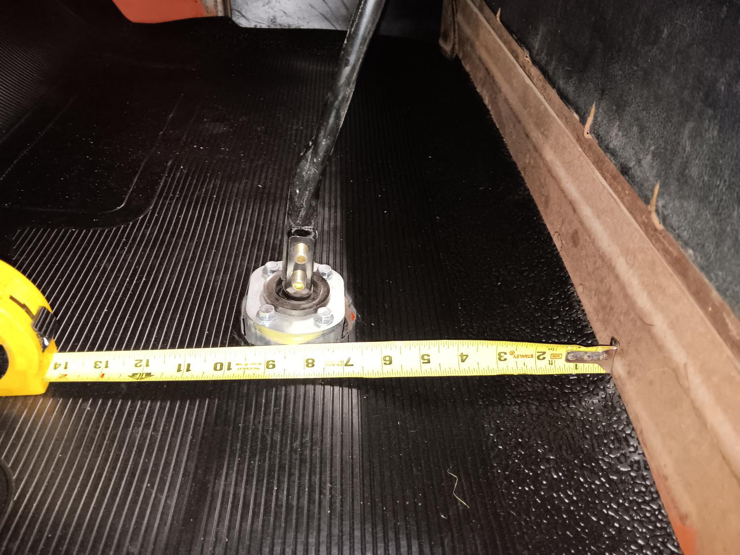

A12pilot 07-18-2025 05:10 PM
2 Attachment(s)
The shifter protrudes through the floor at roughly 8.25" to the center of the shifter when in neutral. This shifter is just one I made until the one I ordered gets here Monday. It clears the seat with no issues. That help?
Attachment 286672
Attachment 286673

KevinW 07-19-2025 12:56 AM
Thanks for the pics Dave and the referral Freddie.
Its good to know that it clears the seat. I would still like to find something that is more forward, so maybe the extenders I see for other ford tremec applications would work. thx
