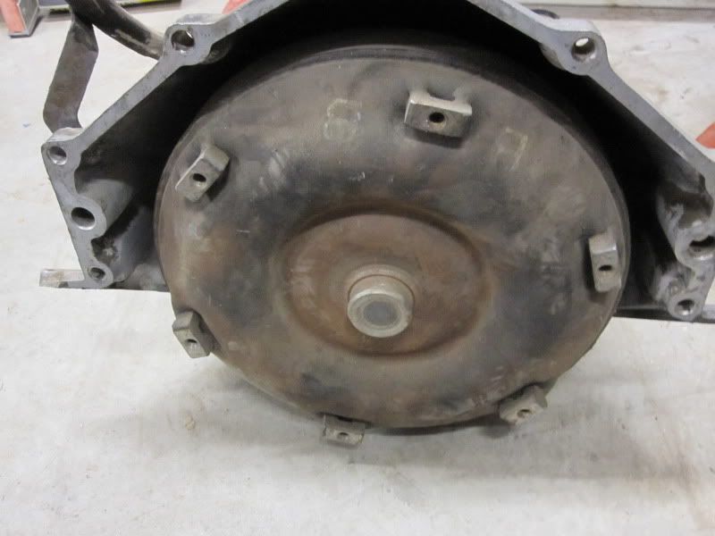

Does anyone have photos front and back of an original T400 6 lug convertor. Just came across one someone wrote GM 70 on seeing if it matches up. Thanks, Larry.
WILMASBOYL78 03-14-2016 10:34 PM
Re: CY & CX 400THM: differences & similarities
Here is what I have...this is from a 1970 Nova CW TH400...original 6 lug convertor.
Hope that helps...wilma
https://www.yenko.net/ubbthreads/pics..._trans_007.jpg
https://www.yenko.net/ubbthreads/pics..._trans_009.jpg
lbnaz 03-17-2016 12:43 AM
Hello, thank-you for the photos. Mine does not look like that so probably isn't GM. By the way your PM box is full tried answering that way. Larry
