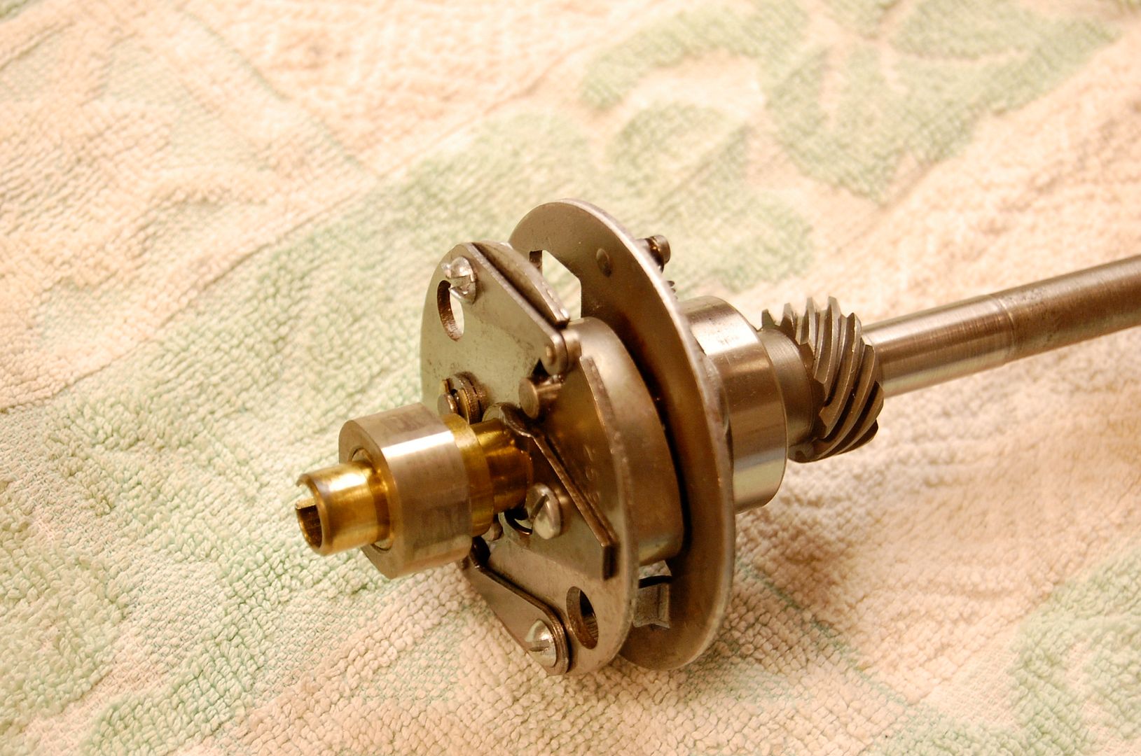

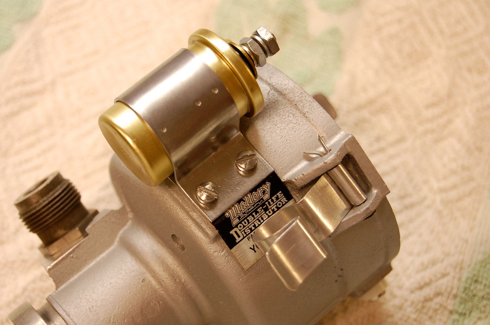

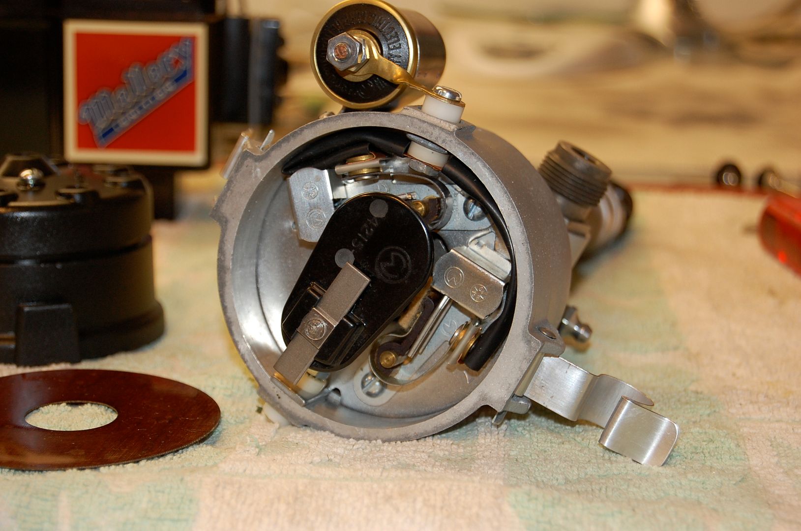

Reassembled most of the distributor. Two-piece cap needs to be restored and am waiting for my points to come in.
<span style="font-size: 17pt"><span style="color: #000099">Innards were n nice shape, just needed a good cleaning and lubrication...</span></span>
http://img.photobucket.com/albums/v6...s/DSC_0038.jpg
http://img.photobucket.com/albums/v6...s/DSC_0056.jpg
http://img.photobucket.com/albums/v6...s/DSC_0047.jpg http://img.photobucket.com/albums/v6...DSC_0042-1.jpg http://img.photobucket.com/albums/v6...DSC_0051-1.jpg http://img.photobucket.com/albums/v6...s/DSC_0046.jpg
ORIGLS6 06-29-2010 04:38 PM
Re: Roof Deuce Restoration
That's just down-right purty.
So, looking at the bottom photo, is this the second half of that &quot;Double Life&quot; distributor? [img]<<GRAEMLIN_URL>>/naughty.gif[/img]
Nice work Sir!

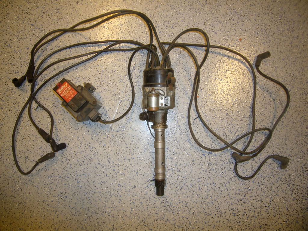

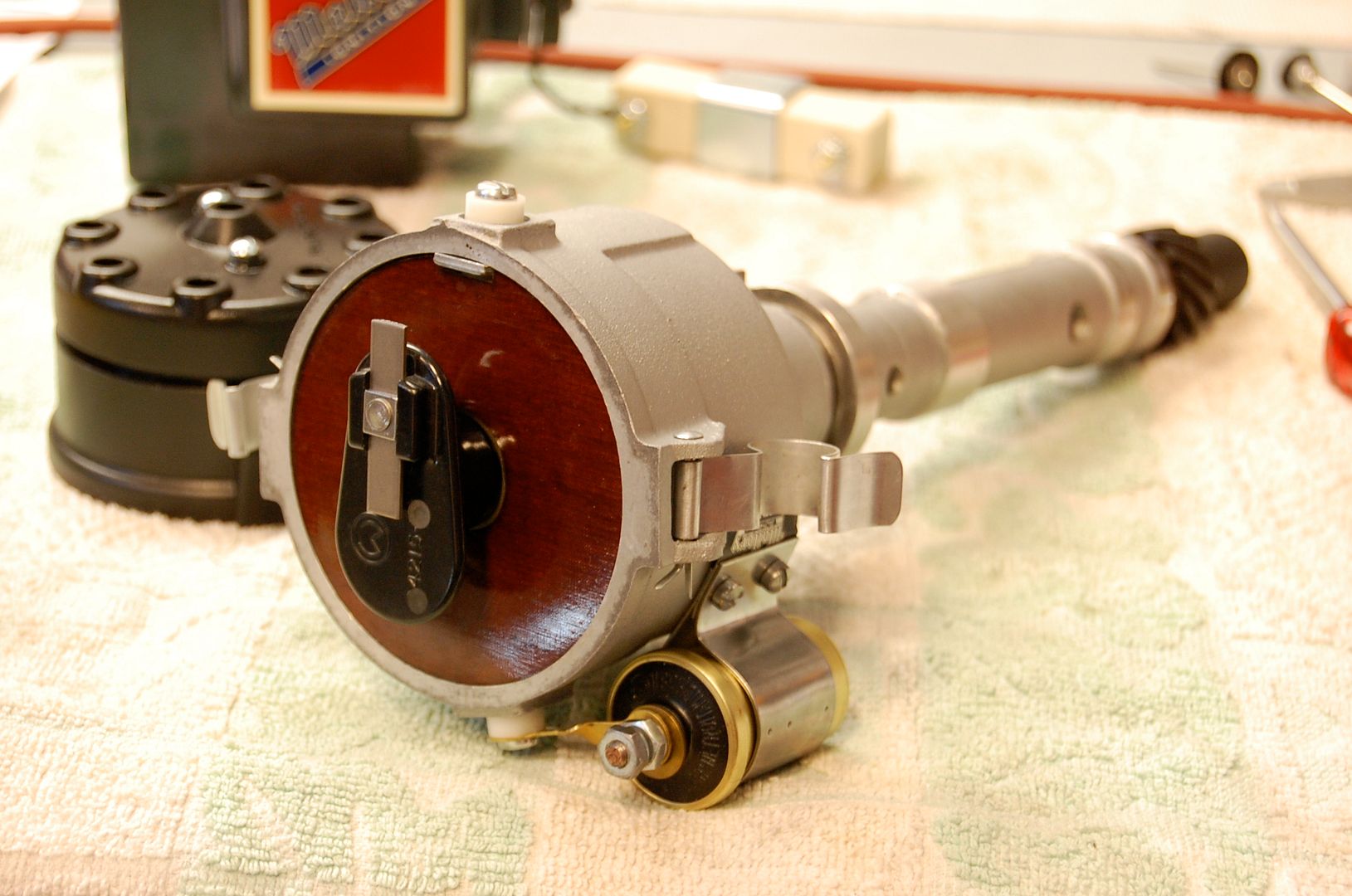

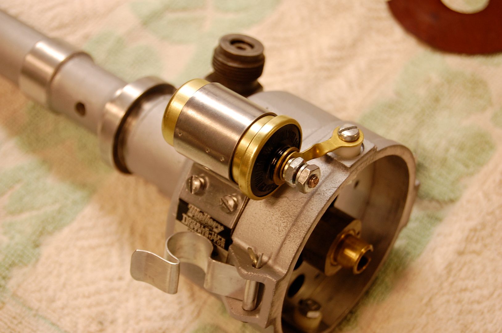

<span style="font-size: 17pt"><span style="color: #000099">Restoration of the Mallory ignition is done. Now off to dial it in on a Sun machine. The AC Delco performance ignition wires are dated 8th and 11th month of 1971...</span></span>
<span style="font-size: 17pt"><span style="color: #000099">Before:</span></span>
http://img.photobucket.com/albums/v6...P1110839-1.jpg
<span style="color: #000099"><span style="font-size: 17pt">After:</span></span>
http://img.photobucket.com/albums/v6...DSC_0005-2.jpg
http://img.photobucket.com/albums/v6...s/DSC_0011.jpg
http://img.photobucket.com/albums/v6...DSC_0043-1.jpg
http://img.photobucket.com/albums/v6...DSC_0038-1.jpg
http://img.photobucket.com/albums/v6...DSC_0040-1.jpg
http://img.photobucket.com/albums/v6...DSC_0045-1.jpg

ORIGLS6 07-06-2010 03:57 PM
<div class="ubbcode-block"><div class="ubbcode-header">Originally Posted By: mockingbird812</div><div class="ubbcode-body">
</div></div>
Hmmmm. 465 HP? Quite a gain over the stock ignition! [img]<<GRAEMLIN_URL>>/biggthumpup.gif[/img]

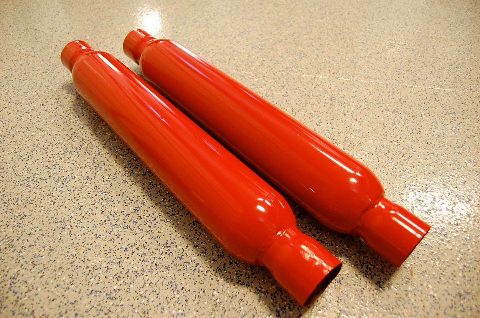

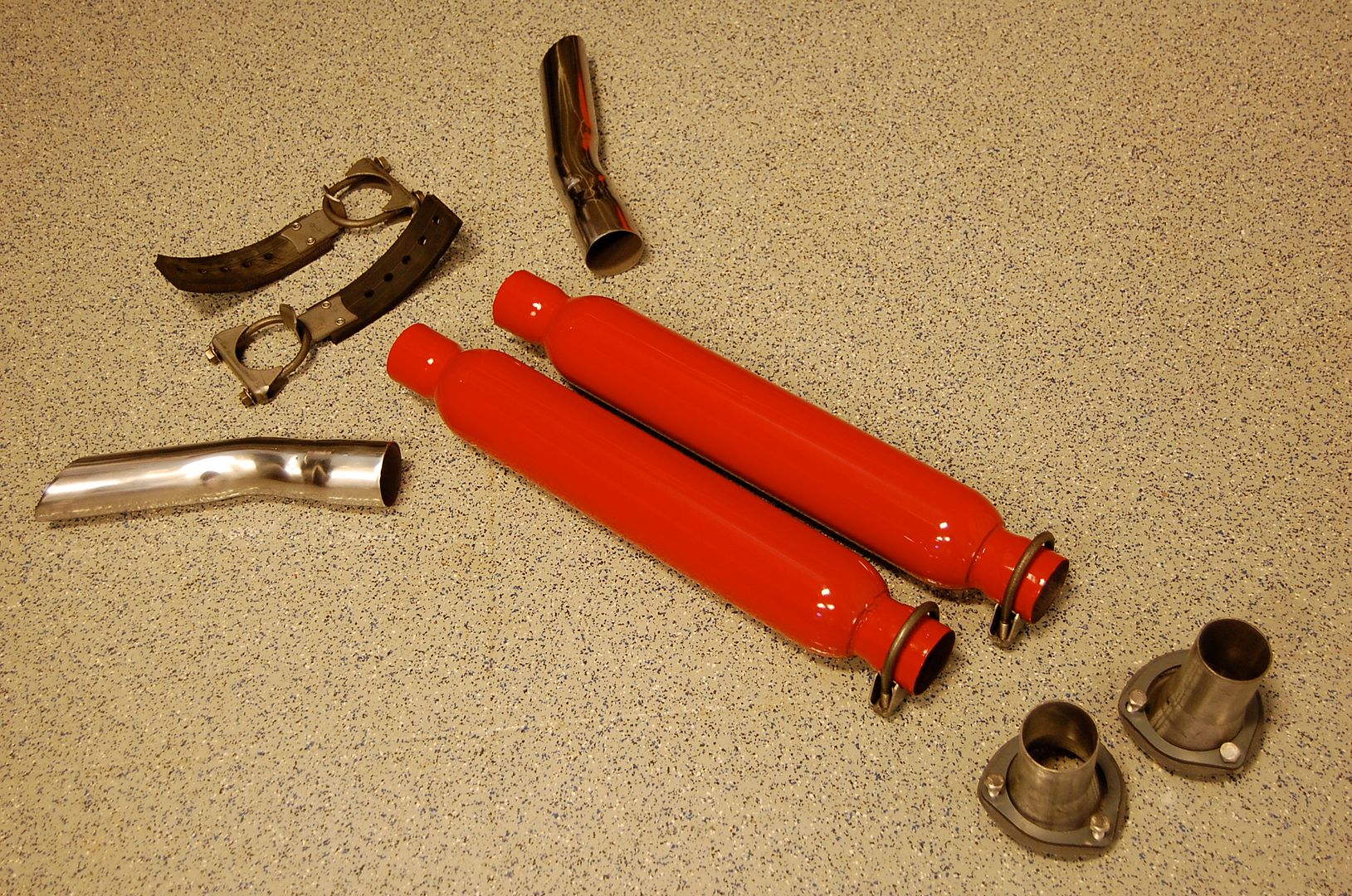

As mentioned before I am going to give MCACN's Day Two Concourse judging a shot. The parts used for this judging have to be period correct (not a Jegs catalog) and they will be looking for the original part numbers. These are the Roof's original Cherry Bombs. They had a bit of road rash which i had to massage out. A bigger challenge was that I couldn't find a exhaust temp high gloss Ch. Bomb red so the powder coater put a ceramic coating on the mufflers to seal the heat in and then powder coated over that. Period correct C. Bomb stickers are being made....
http://img.photobucket.com/albums/v6...DSC_0141-1.jpg
http://img.photobucket.com/albums/v6...DSC_0136-1.jpg
