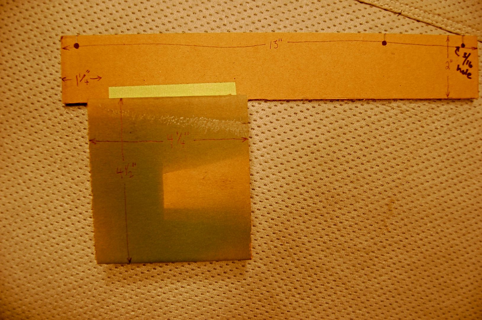

Keeping with the day-two theme, a couple guys asked about how I mounted the Mallory coil. I didn't want to drill any holes in the firewall so I used some existing holes for the wire gutter to attach this coil (and resistor).
<span style="font-size: 20pt"><span style="color: #3333FF">Started with a cardboard template to make sure I had a decent design and fit (would recommend taking own measurements as they may vary from car to car) .... </span></span>
http://img.photobucket.com/albums/v6...DSC_0005-3.jpg

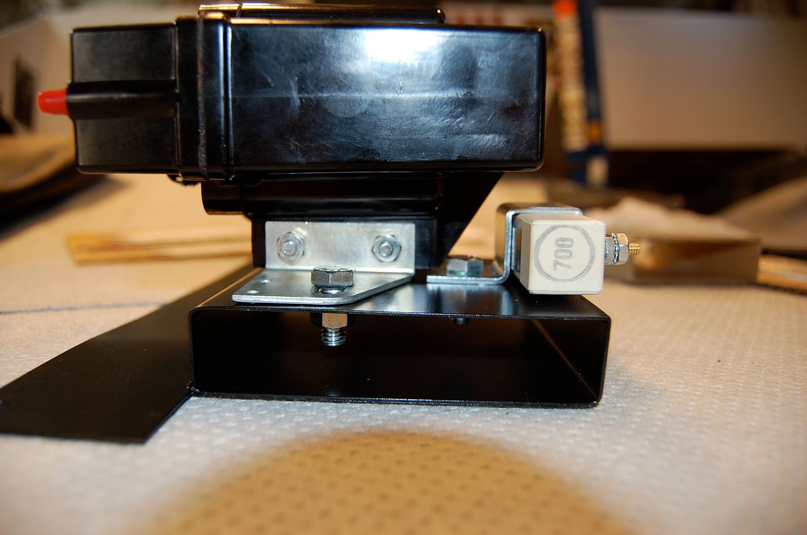

<span style="font-size: 20pt"><span style="color: #3333FF">...this is what the Mallory coil mount looks like from the rear... </span></span>http://img.photobucket.com/albums/v6...DSC_0028-2.jpg
<span style="font-size: 20pt"><span style="color: #3333FF">...side view of dry run...</span></span>
http://img.photobucket.com/albums/v6...DSC_0011-1.jpg
<span style="font-size: 20pt"><span style="color: #3333FF">...top view (dry run)....</span></span> http://img.photobucket.com/albums/v6...s/DSC_0013.jpg

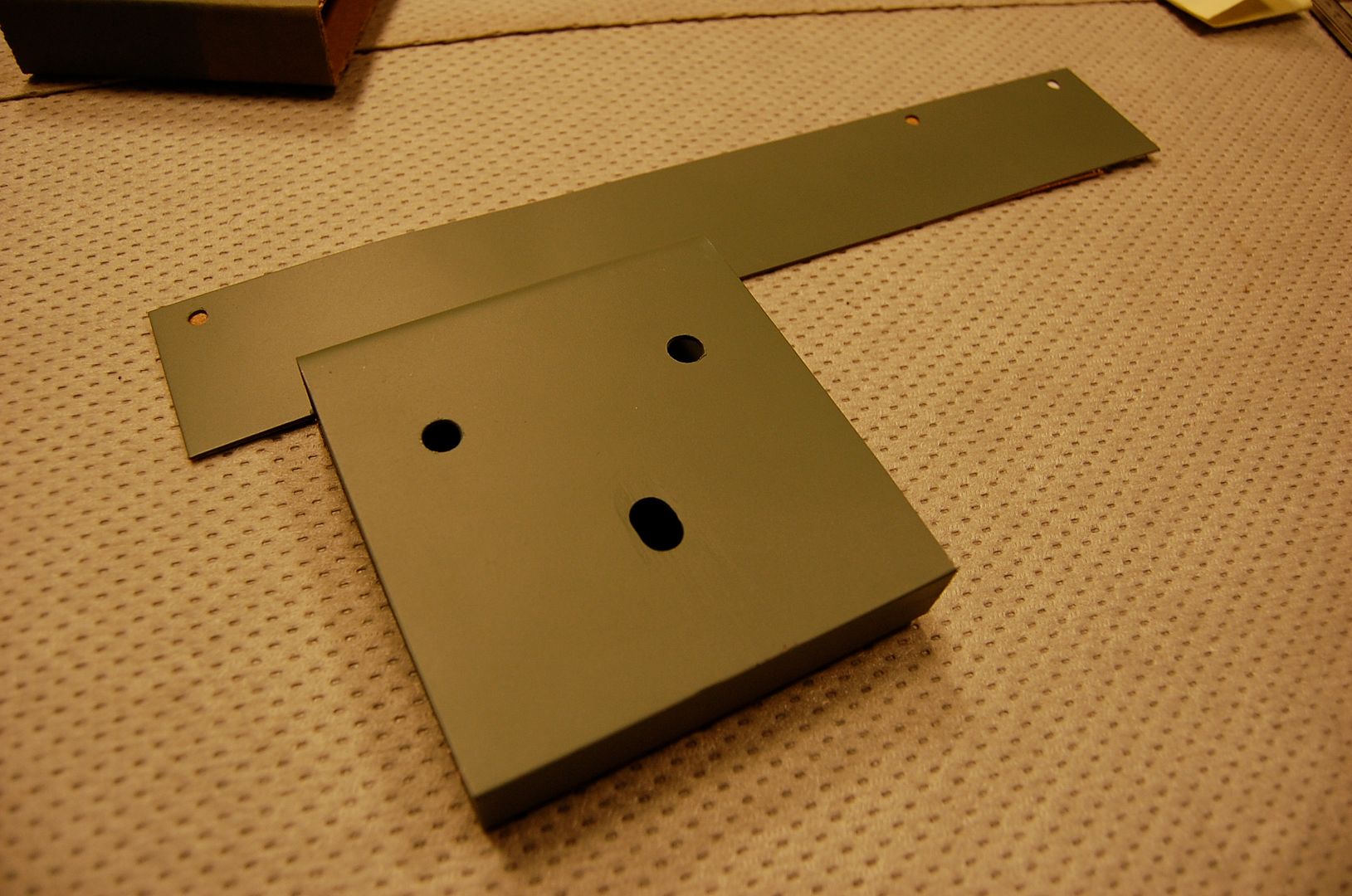

<span style="font-size: 20pt"><span style="color: #3333FF">...primed and drilled holes for mounting the coil and ballast resistor (bottom hole elongated because of a minor miscalculation [img]<<GRAEMLIN_URL>>/blush.gif[/img] ) ....</span></span>
http://img.photobucket.com/albums/v6...DSC_0020-1.jpg

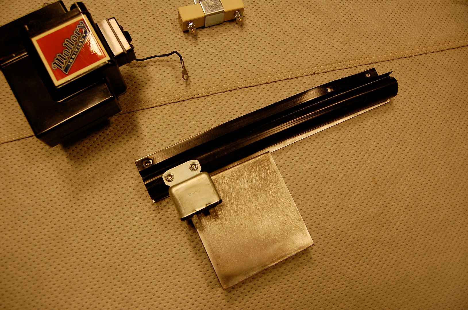

<span style="font-size: 20pt"><span style="color: #3333FF">...coil and ballast resistor mounted and final coat with Eastwood's Underhood Black...</span> </span>
http://img.photobucket.com/albums/v6...DSC_0033-2.jpg
