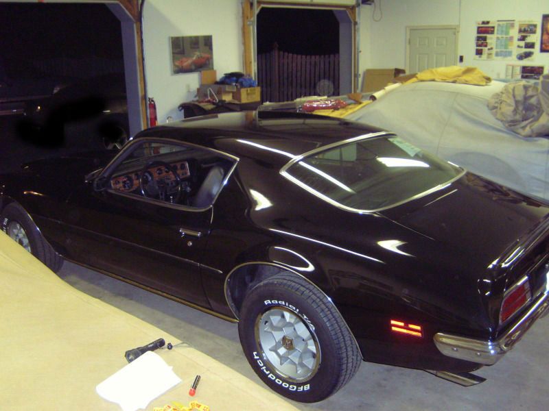

Nice to see the car in it's new home.No surprises from the shipping Company like you have had happen to you before?

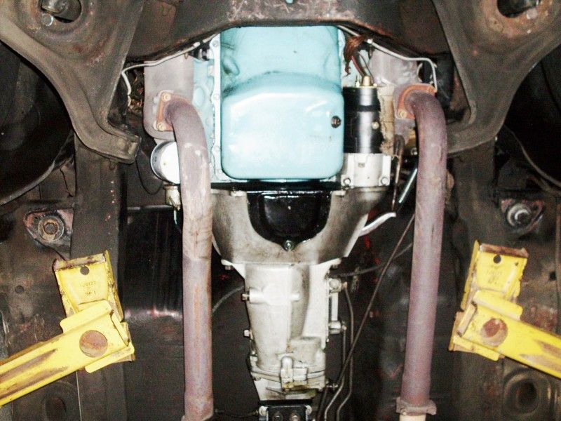

njsteve 05-01-2012 09:52 PM
Re: The New Project: Part Deux!

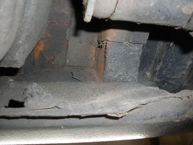

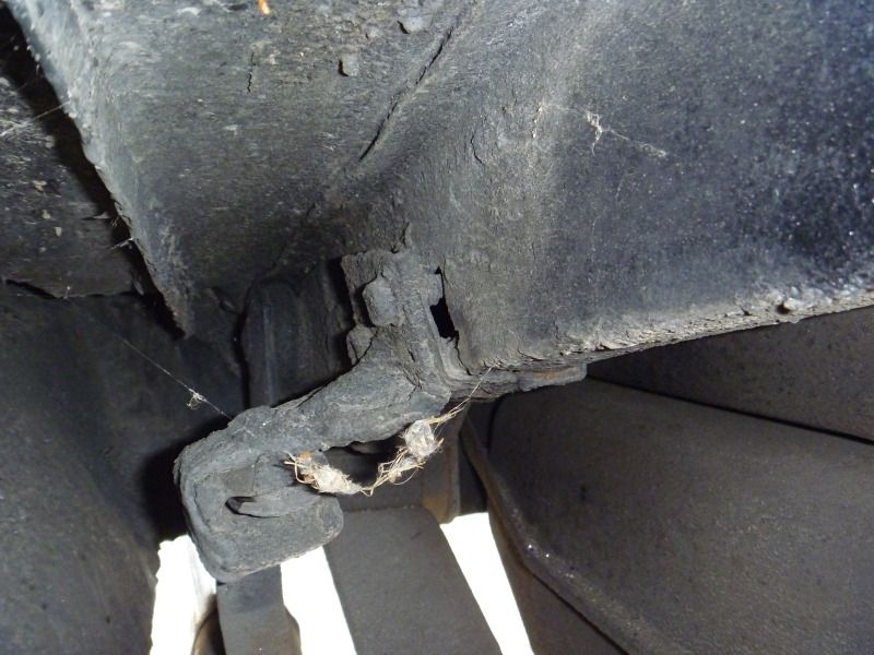

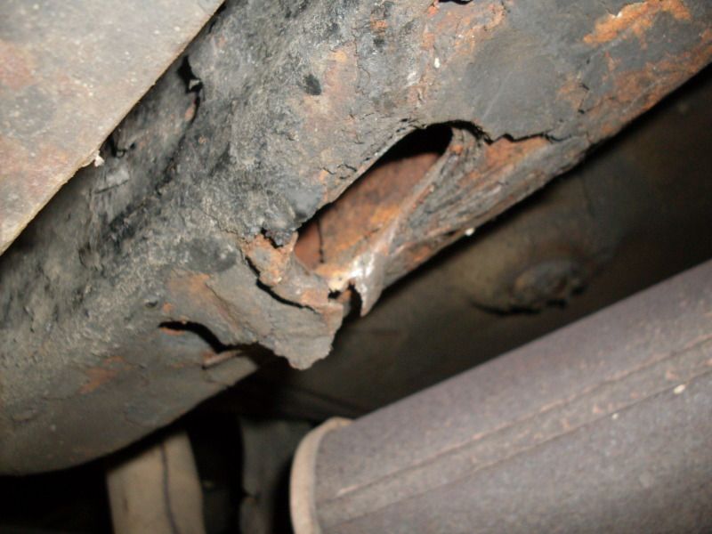

I brought the car to my buddy's garage last night and we put it up on the lift. Lots of loose bolts in the front end, including the subframe to body bolts! At least the oil pan plug was tight. (Grant warned me about how many bolts he had to put back in this thing when he found it).
Looks like its going to need some portions of the rear frame rail on the passenger side replaced. The bottoms of the rails near the front spring perches are notorious weak spots on these cars. Unfortunately, the trucking company used the factory hold down spot in that location when shipping it here and it pulled the metal out of place a bit. This spot is a place where three different pieces of metal are sandwiched together to form the end of the frame rail. It holds moisture and here is the result:
http://i599.photobucket.com/albums/t...c/SDC10421.jpg
http://i599.photobucket.com/albums/t...c/SDC10423.jpg

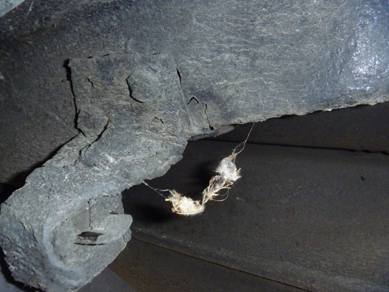

And the broken-out section of the pass side rear frame rail from the tail pipe hanger holding the entire weight of the exhaust due to the broken universal rubber hanger that was carriage bolted to the floor pan above the rusty aftermarket muffler. [img]<<GRAEMLIN_URL>>/rolleyes.gif[/img]
http://i599.photobucket.com/albums/t...c/P1000545.jpg
http://i599.photobucket.com/albums/t...c/P1000546.jpg

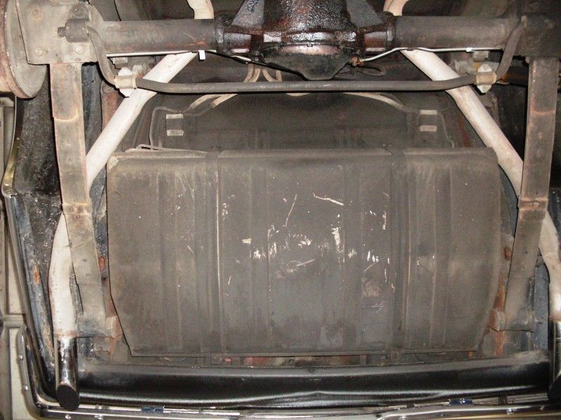

I won't be able to make an accurate assessment of the underside until I can get this thing steam cleaned. I checked with the local equipment rental place near me (the only one that rents the hot water pressure washers) and they quoted me $275 a day to rent the thing. JEEZ! Are the hot water sprayers really that much better than the regular cold water ones? You could almost buy a cold water pressure washer for that price.

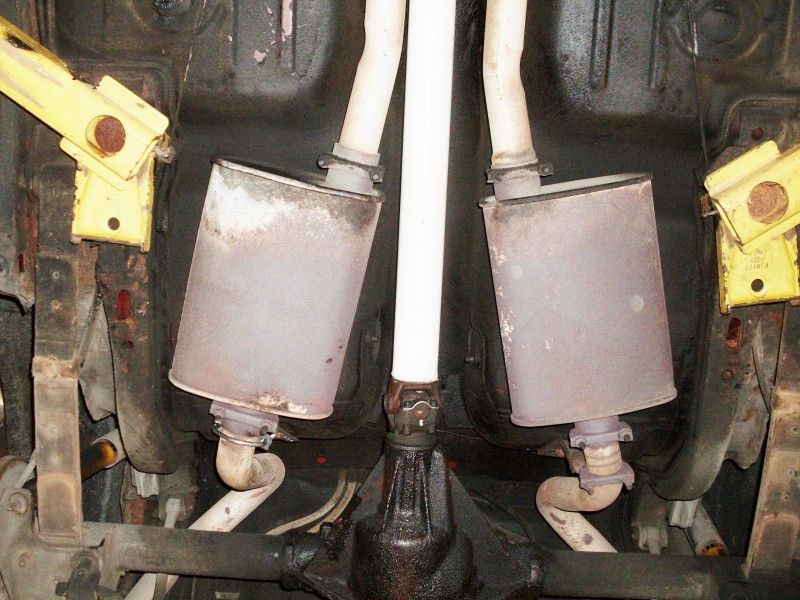

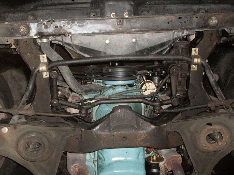

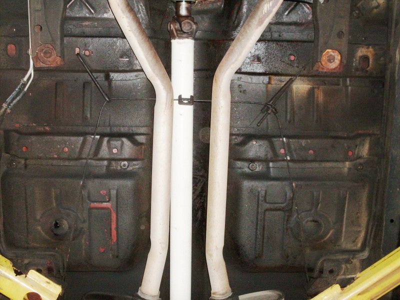

njsteve 05-01-2012 10:08 PM

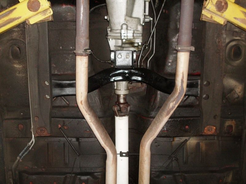

And here is the dirty bottom half of the car. The floor pans looks nice, with some red oxide showing through the grime in places.
http://i599.photobucket.com/albums/t...c/SDC10453.jpg
http://i599.photobucket.com/albums/t...c/SDC10452.jpg
http://i599.photobucket.com/albums/t...SDC10451-1.jpg
http://i599.photobucket.com/albums/t...c/SDC10450.jpg
http://i599.photobucket.com/albums/t...c/SDC10449.jpg
http://i599.photobucket.com/albums/t...c/SDC10447.jpg
http://i599.photobucket.com/albums/t...c/SDC10445.jpg

Isn't it nice how the only clean thing on the underside is the white painted driveshaft! [img]<<GRAEMLIN_URL>>/grin.gif[/img]

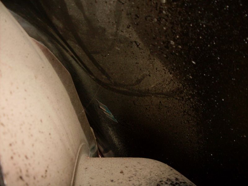

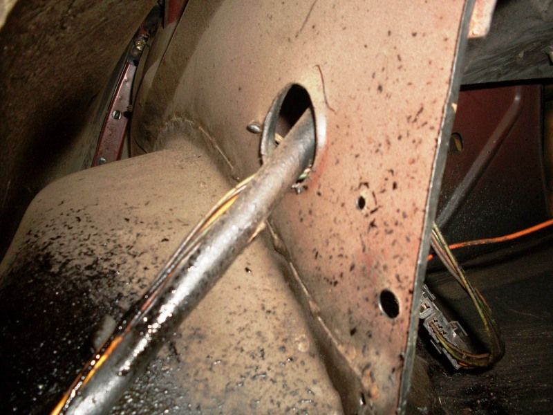

njsteve 05-02-2012 12:19 AM

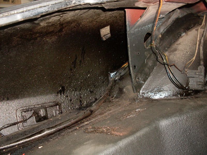

I went crawling around the car some more. At least there is some good news: it has two NOS GM quarters, NOS drivers side outer wheelwell and NOS tail panel installed. The labels are still there. That's about $6k worth of GM sheetmetal I don't have to search for. [img]<<GRAEMLIN_URL>>/grin.gif[/img]
http://i599.photobucket.com/albums/t...c/SDC10530.jpg
http://i599.photobucket.com/albums/t...c/SDC10526.jpg
http://i599.photobucket.com/albums/t...c/SDC10528.jpg
And some bad news: the end of the passenger side frame rail is missing the flange that mounts up with the inner tail panel.
Here is the drivers side:
http://i599.photobucket.com/albums/t...c/SDC10426.jpg
and here is the passenger side:
http://i599.photobucket.com/albums/t...c/SDC10427.jpg
So far it needs a passenger side frame rail for donor sections, left and right trunk drop offs to replace the home made ones. (I just ordered the new reproduction units that just came out), a passenger side outer wheel house and portions of the inner wheel house.
