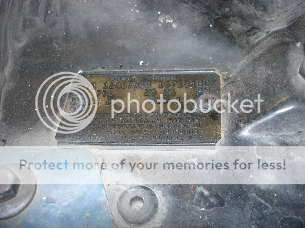

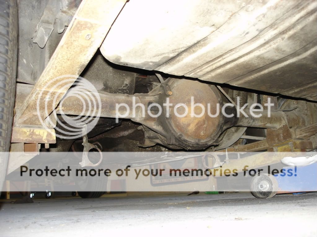

It was sitting there dusty with the engine out of the car so I didnīt take many pics of it. I was just looking for proof of it being an original M22 Z28 car.
http://i436.photobucket.com/albums/q...s-resan085.jpg
http://i436.photobucket.com/albums/q...s-resan099.jpg

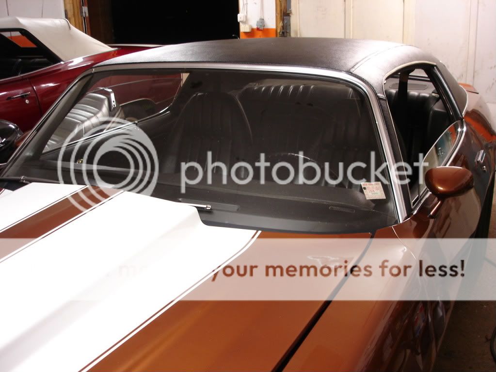

Here is another solid 40.000 miles 1971 Z28 I looked at last weekend. This one now has a LS7 engine backed up by a M22 trans, but the original LT1 and M21 trans is safe on a pallet. I believe the engine, trans, and rearend had never been apart. The original hood is also in safe storage.
It has the one-piece rearspoiler just like the blue one.
That is a New York state inspection certificate from january 1974, in the windshield.

al8apex 09-10-2009 10:33 PM
Re: 1971 Z28
It is, the vins match, the trans is real
the short spoiler was standard in 71, the larger one was optional
