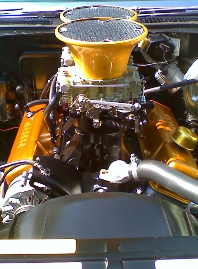

mr.4speed 12-14-2011 05:14 AM
Re: Tunnell Ram Toppers
those are the ones i got new from jegs and had them gold anodized.
http://i579.photobucket.com/albums/s...64276_ORIG.jpg
