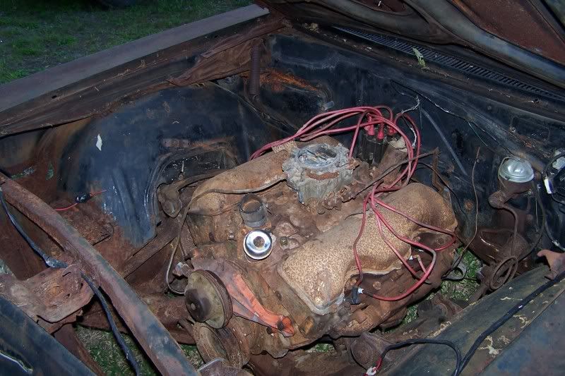

bulletpruf 04-14-2012 05:05 PM
Re: 65 Impala SS409 4sp Triple Black Vert Find-Value?
It's kind of crusty...
http://i102.photobucket.com/albums/m...s/100_3476.jpg
http://i102.photobucket.com/albums/m...s/100_3486.jpg
http://i102.photobucket.com/albums/m...s/100_3484.jpg
http://i102.photobucket.com/albums/m...s/100_3482.jpg
http://i102.photobucket.com/albums/m...s/100_3480.jpg
http://i102.photobucket.com/albums/m...s/100_3478.jpg
http://i102.photobucket.com/albums/m...s/100_3488.jpg
http://i102.photobucket.com/albums/m...s/100_3490.jpg
http://i102.photobucket.com/albums/m...s/100_3492.jpg
http://i102.photobucket.com/albums/m...s/100_3494.jpg
Verne_Frantz 04-14-2012 08:45 PM
Well, first of all, that carb is a Rochester 4GC as used on 250hp 327s, the intake is cast iron so the heads are low perf. The valve covers are from a truck and I don't see any evidence of a ballast resistor, just the resistance wire to the coil (meaning low perf). There's a slight possiblilty it could have been a 340hp to begin with but the carb, valve covers and pulleys were changed.?
Verne [img]<<GRAEMLIN_URL>>/biggthumpup.gif[/img]
Also, since the body was built at Euclid, then rail shipped to Flint for final assembly, there's VERY little chance it was an original 409.

x Baldwin Motion 04-14-2012 11:23 PM
Looks like just two holes in front fender for emblem. In 65, 283 had just the flags, all others had cubic inch numerals above flags (four holes in fender) not saying this is or is not an original 409 or 283 car, just an observation of the fender. good luck [img]<<GRAEMLIN_URL>>/biggthumpup.gif[/img]
Verne_Frantz 04-15-2012 05:10 AM
The car is a real 4-spd car but you couldn't order a 4-spd behind a 283.
Verne [img]<<GRAEMLIN_URL>>/wink.gif[/img]

TAR6569 04-18-2012 11:09 PM
The conv top piece that goes over the windshield is really rotted away on the drivers side. The car was on ebay a few weeks ago, see item# 251024778104 The car could have been a 283/220 (283 with 4bbl carb) but they did make some fullsize cars 65-67 with the base 283 and M20 4spd.
It would be interesting to see the rear axle code.
Warren
TAR6569 04-19-2012 12:41 AM
Also, the holes in the fender for the flags and engine size emblem are the same for 283, 327 and 409.
