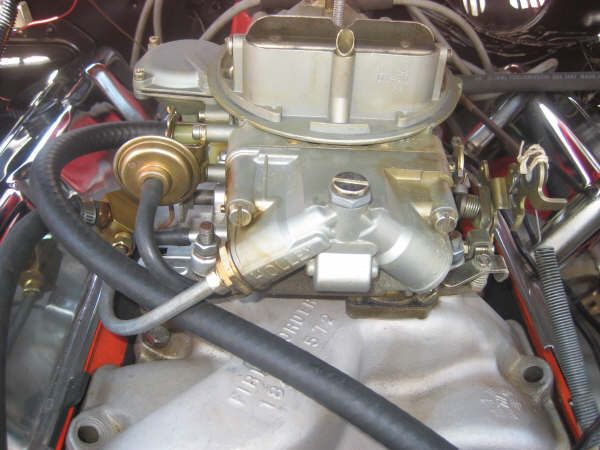

earntaz 11-17-2013 02:23 AM
Re: Removing roller rockers???
How about posting some pictures of the covers in the area of the wiper motor mounting.
Zedder 11-17-2013 02:30 AM
http://i152.photobucket.com/albums/s...olleyCarb1.jpg
