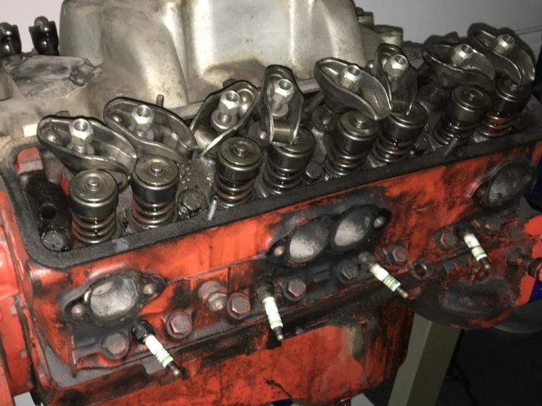

rlw68 10-23-2019 02:20 PM
Are your planning to leave the rest of the valve train stock? It seems like a good idea to update the rockers, maybe like these Comp Cam rollers. It wont keep me up at night without the O stamped originals on there.
The press in studs do create some anxiety though. They are original and cool but it seems worth the 'loss' to keep my original 302 in one piece. Am I worrying about nothing here??
I'm likely going with the Comp Cam 12-107-3 (3849346 replacement). My '69 has an M21 and 4.10 gears. Both of these have updated internals.

I'm in the same boat with the car I have now. I was thinking about roller rockers but then it usually mushrooms into removing the heads, doing a set of screw in studs, guides and likely more when I get to that stage.

For the studs you can always do the old trick of pinning them. It's hard to see once done and keeps them from backing out.

rlw68 10-24-2019 02:03 PM
1 Attachment(s)
I have these 492 heads also but currently into the Day 1 thing. They do have screw in studs already though :) Would a cam choice here be any different or perhaps make the 140 happier?
Attachment 149498
