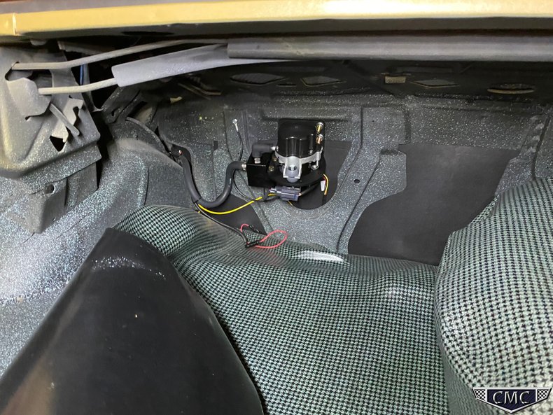

2 Attachment(s)
What's this thing in the trunk?
Attachment 200130
JM apparently certified this one as an RS Z/28
Attachment 200131
:dunno:

Tracker1 08-10-2021 01:44 AM
RPO 088 - Flux Capacitor
