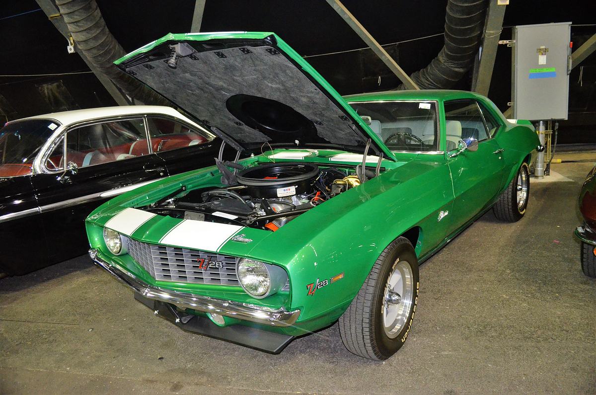

Great looking car. Anybody know anything about this car? This 69 Z28 and I think 9 others are selling on Friday at BJ

Just for my own education, seeing that the stripes extend to the trunk lid does that mean the car was not originally equipped with a rear spoiler?
Danzo 01-12-2020 01:47 PM
Correct
William 01-12-2020 02:30 PM
Incorrect. Just not painted right.
Spoilers became part of Z/28 equipment as of April, 1969. N647817 was final-assembled on or about May 23rd and would have been built with spoilers.
Gets style points for not having added style trim.

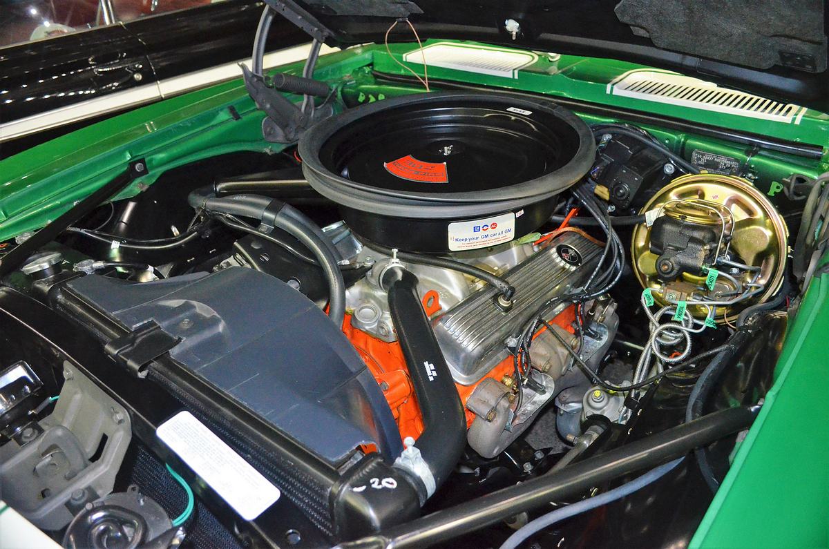

Billohio 01-12-2020 03:50 PM
Looks like a reproducion booster, and the valve covers shouldnt be polished.

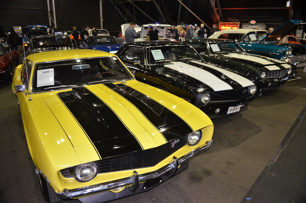

matt5708 01-12-2020 05:52 PM
These are the other 2 I am looking at.
https://www.barrett-jackson.com/Even...RO-Z/28-236193
https://www.barrett-jackson.com/Even...RO-Z/28-236301
matt5708 01-12-2020 05:56 PM
Not sure why they didn’t restore the yellow one with the correct black stripe.

Trim tag on the 9N647817 Rallye Green one says 711 black standard, but it has 729 Houndstooth.
frankk 01-12-2020 07:01 PM
Maybe because of the white top
rszmjt 01-12-2020 08:14 PM
The green Z has lots of small issues, wrong upper alt Bracket, wrong water pump, plus more. It amazes me how many of these cars have the horns on backwards too. A closer personal inspection would be warranted by bidder.
Does look good with the Ivory houndstooth, be interesting to see what these cars bring.

I think someone said that there are 72 1969 Camaros there this year?
I like all the green pn# tags on the brake lines, it kinda' makes the booster OK :naughty:
52 at B-J; 12 at Leake; 47 or so at Mecum FL; 4 at Russo-Steele.
Dynacorn bodies not included
That's funny Mike. I'm betting that RG car hits around 65K regardless.
