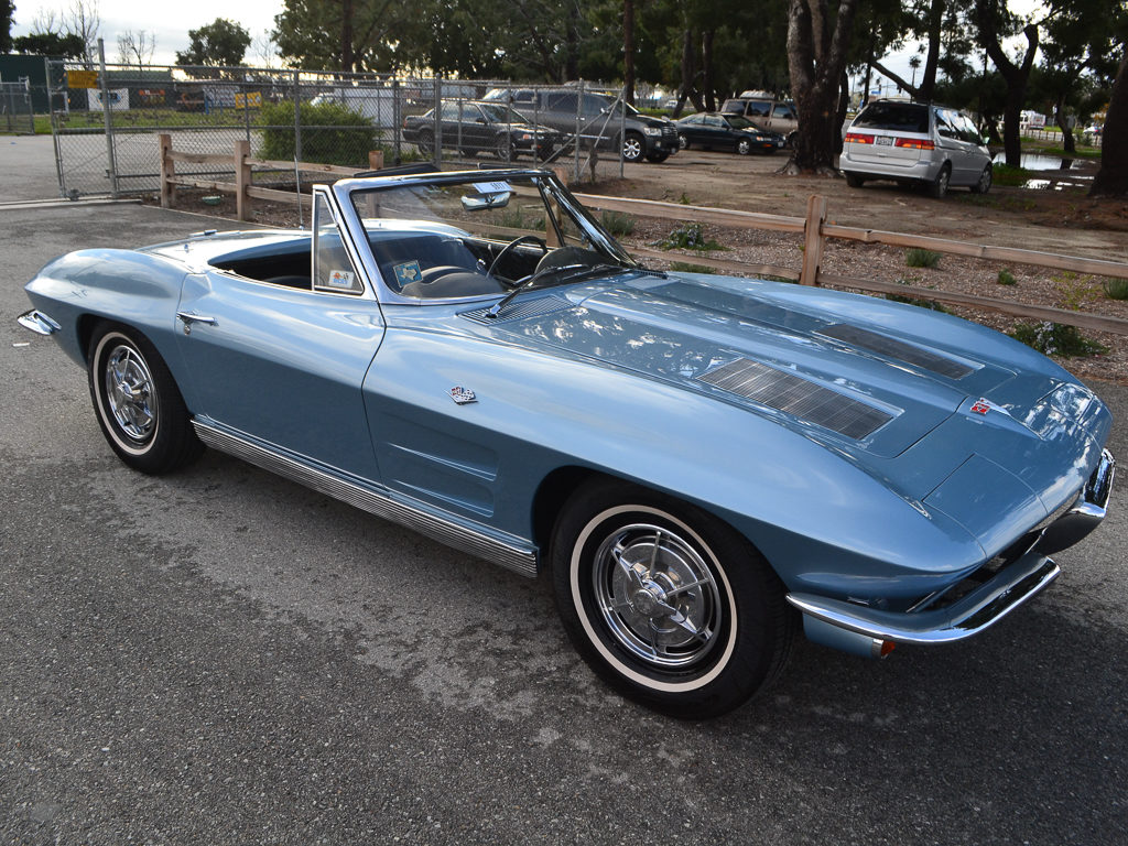

A12pilot 09-18-2020 08:57 PM
2 Attachment(s)
It's a silver blue roadster, but had a repaint in what I think may be a 67 color. Here's a pic. More info to follow...
Also the engine date stamp.
Cheers
Dave

olredalert 09-18-2020 09:45 PM
----Good going, Dave! Color looks close to 65 Nassau Blue, but that is also similar to 67 Marina Blue. Car looks nice, but we all know we will see a lot more pics (can't wait). Tell me about the KOs. It would be such a cool thing if they were real even though they weren't available on 63s. They really make the car even if they are repops. Nice top which are pretty costly and a bitch to get looking wrinkle free. Numbers look OK, but it appears as though someone got just a bit aggressive cleaning up the pad. Congrats!!!.....Bill S
