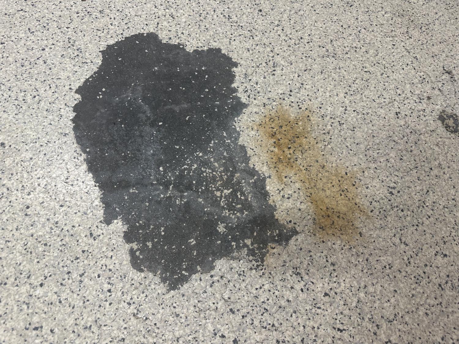

4 Attachment(s)
I had bad luck with what was guaranteed not to fail and prefer my bare floor. And of course the Company is out of business.
Charlie, did they diamond grind your floor and then clean with acid before the primer and top coating? Your floor looks like the concrete installer did a slick finish and if it's not diamond ground before the floor coating goes on then it will never adhere long term.
The coated floor was a new pour that had cured for a few months.They initially did a urethane coating that failed almost right away because the chemical company sent them the wrong chemicals. The chemical company bought them a diamond grinder to remove everything and then the epoxy.
The bare floor just gets shinier as I scrub it with the floor scrubber. |
I was told that even with a brand new and cured floor they still need to diamond grind it followed by the acid wash because the "slick finish" of most concrete floors won't allow good adhesion for the coating. This was from a guy who does floor coatings for commercial businesses.
They did diamond grind it and it still failed.

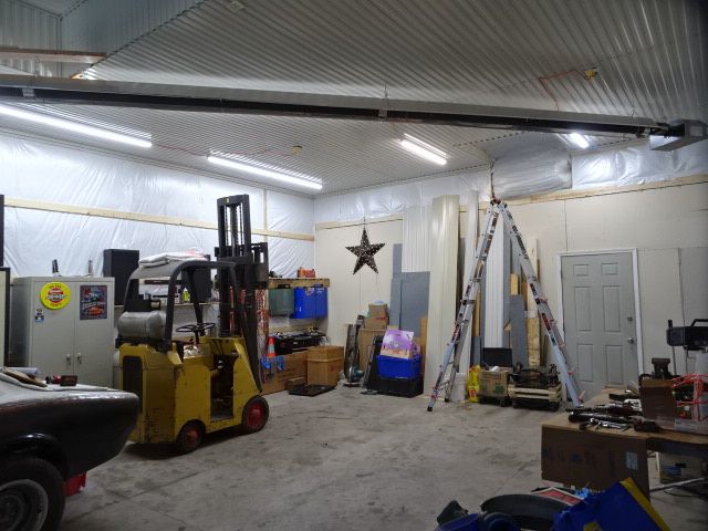

1 Attachment(s)
Finally in it's new home. I'll have to keep it covered up while I'm building walls, putting up the ceiling and other stuff. That's the frame for my '55 Chevy. My next project.
4 Attachment(s)
I had to put the Camaro in the bag while using the saw to keep sawdust from getting into everything. Then the wood was delivered. I was in a race to get as much done as I could in 2 weeks. I got all of the walls framed working to the very last minute, but didn't get the ceiling joists up or the wiring done. That means there will be no heat until around February or later. I had to get the left shoulder repaired this morning, so no more work for 8 to 12 weeks.
