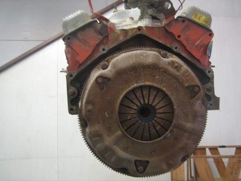

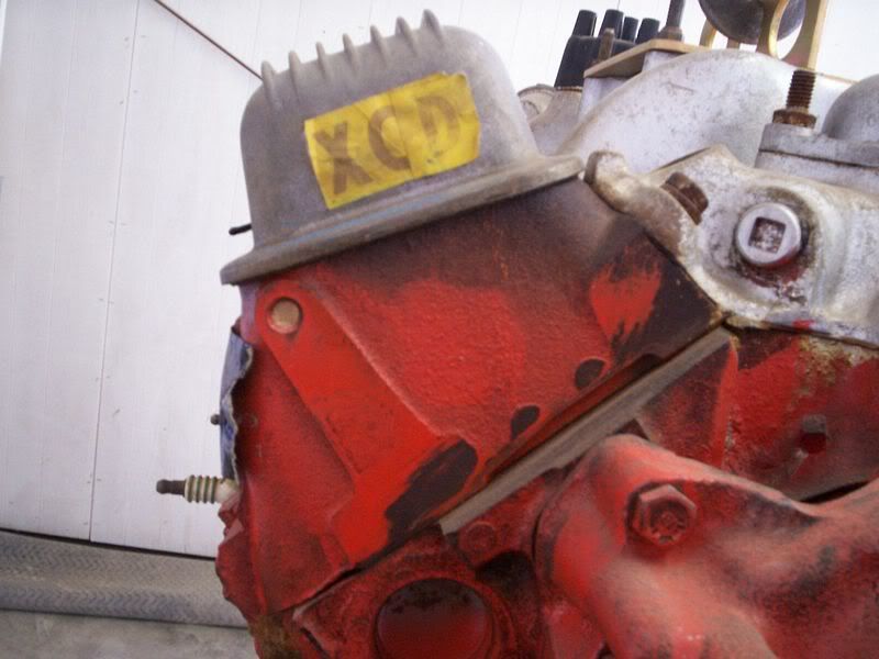

Pete the 70 lt1 motor complete with bellhousing in it's original crate that i bought had the yellowish stickers on the valve cover one in front & on the same cover one on the back. Say's XCD & on the engine stamping it has the date with the XCD.Do a search in this topic for crate lt1 & i have posted pictures.
owners2 01-23-2009 05:47 AM
Re: Yellow Suffix Sticker on Valve Cover question
Pad say's V0615XCD.Can't seem to make pics work but you can search under my posts or this topic & the title say's Possible 70 LT1 crate motor find! & was on 3-4-08. There are pics again sorry for not being good at pictures.Jeff

Heres a couple of yours Jeff (owners2)
http://i271.photobucket.com/albums/j...t1crate012.jpg
http://i271.photobucket.com/albums/j...n_IMG_2632.jpg
