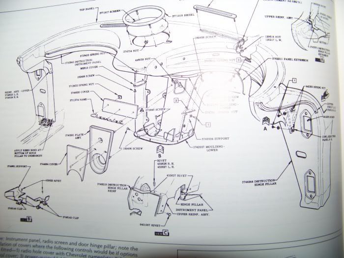

I have an opportunity to buy a 58 Corvette. I am being told that it was a radio delete car and I'm assuming also a heater delete. The fellow who restored the Corvette unfortunately added a box under the dash to support an aftermarket radio and cut in the antenna.
My question is: Did a 1958 Corvette with heater and radio delete not have the center extension from the dash where the heater controls, radio and clock were installed or was this extension in place on all Corvettes and simply blocked off.

Yes a 1958 corvette with radio and heater delete still had same downturn portion that tied the dash into the trans tunnel but had a radio delete plate and a different heater control bezel,ill try to find ya a pic!!!

Nasblu 02-11-2009 01:12 AM
Re: 1958 Corvette Radio Delete
http://i124.photobucket.com/albums/p...u/100_1099.jpg
Ed,
All 1958-62 vettes that were heater delete had blank covers #3744864 these were installed at the factory to cover the three holes where the heater control would be. The radio delete plate part# 3744820 and its chevrolet emblem part# 3711574
Actually, there was no such thing as "radio delete". The radio wasn't standard equipment - the car was simply ordered without checking the option box to add the radio. Heater was the same thing - it wasn't standard equipment until 1962.
