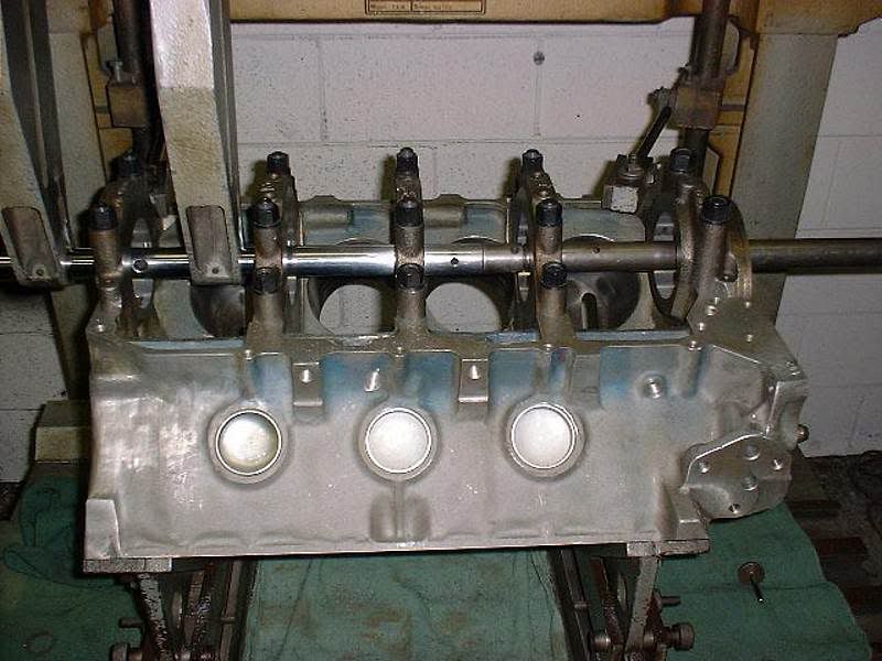

The RA V tunnel port engine is made up of the aluminum RA V block,Ross custom dished pistons for 9.5 CR.The rods are Carillo and the crank is a Joe Reath welded stroker,made from a forged 61 pontiac SD crank with center counter weights and a stroke of 4.125 and a 4,20 bore.The cam is a Comp Cam roller 245-252@50 with a 400 lobe lift ground on a 112.H&S full roller rockers.The heads are stock unported with 2.19 intake and 1.73 exhaust.The carb is a 4545 RA V Holley restored by Jet Performance distributor and balancer are stock RA V pontiac items.
This engine is one of 2 aluminum RA V engines running in cars.One of a few blocks that got out of the factory.The other block is one I also owned at one time.

my block is one of 6 that were picked from the trash at the factory.The one I own took much work to make good.Core shifts and perosity problems were great.I pretty much know where all of the 6 are.There were other alu blocks out there from early developmental engines giving to M/T.There was a article in Hemmings muscle machine a couple months ago that showed that motor.There were hemi blocks made for M/T and im sure other mid 60s early 70s that were givin to the "hooked up" racers.The early 421 SD andd RA V stuff is my passion.Tom
