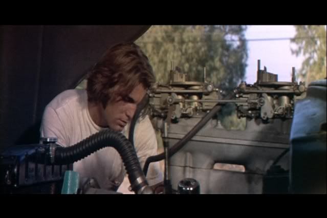

To be period correct, you've got to run a pair of Holley carbs. Edlebrock's weren't around any any close equivalent is just lame IMHO.
This is the empitome of 1970's day 2 TR's. This is a Weiand, but I don't know the model. It has a pair of 450 carbs, but the ol' 1850 600 cfm are cheaper and easily tuned for this application. I run them on my 327 too.
http://i305.photobucket.com/albums/n..._000451501.jpg
http://i393.photobucket.com/albums/p...ktop/tlb45.jpg
There is something about the way this intake looks that I really dig more so than the Two Lane Blacktop set-up.

are those 450's or 660 center squirters?

There are no 660's in the three pictures above... The 4224 has a very distinct look.
