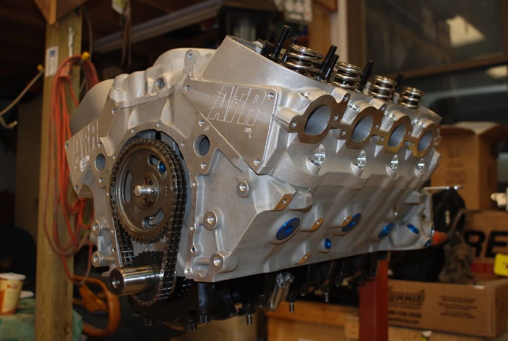

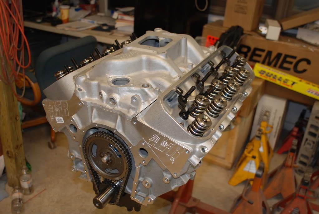

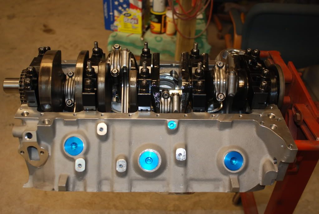

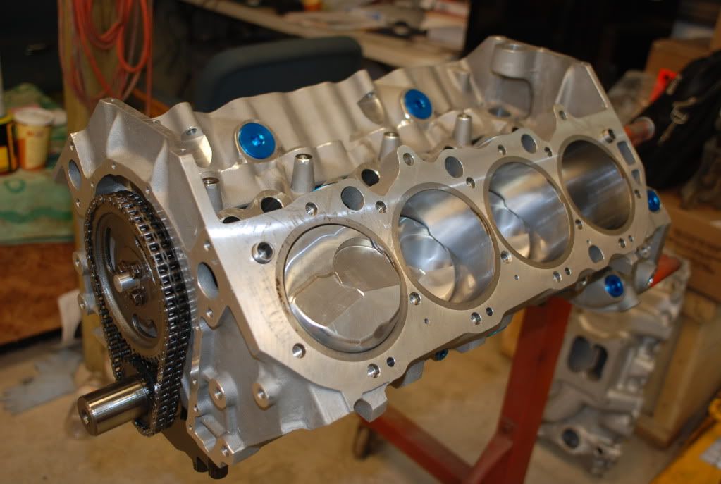

Got my 489 back from the machine shop yesterday..Im stoked to get it in the car!
specs:
std bore Zl-1 block
callies Comstar rotating assembly by Lewis racing engines
11:1 Diamond pistons
Chris Straub solid roller
CNC AFR 305's
GM 198 dual plane intake
Carb TBD.
and the most important part..pictures:
http://i518.photobucket.com/albums/u...DSC_0265-1.jpg
http://i518.photobucket.com/albums/u...DSC_0267-1.jpg
http://i518.photobucket.com/albums/u...DSC_0270-1.jpg
http://i518.photobucket.com/albums/u...u/DSC_0272.jpg

WOW Albert.....That looks like it's gonna rock and roll! [img]<<GRAEMLIN_URL>>/drool.gif[/img] Will you be putting it on a dyno?
mockingbird812 01-15-2011 05:05 PM
Re: new 489 ZL-1
Lookin' good ALbert! [img]<<GRAEMLIN_URL>>/shocked.gif[/img] What kind of numbers are you looking for? Trans &amp; rear gears?

The pictures are what makes me &quot;DROOL.&quot; &quot;WOW&quot; Albert!

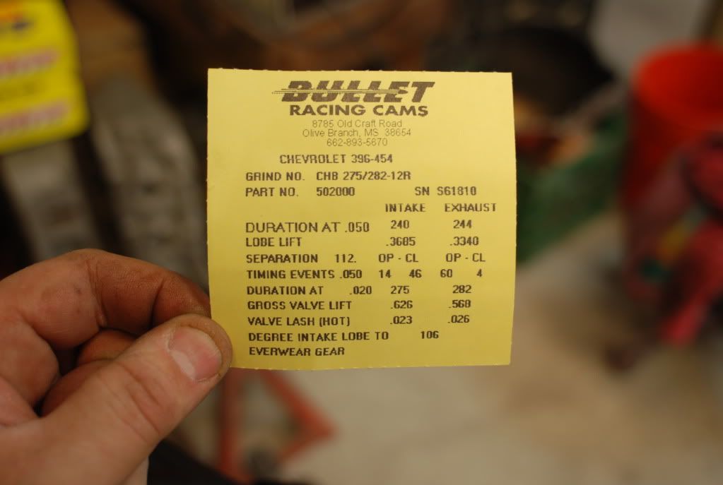

Kurt, Sam..I want to dyno it..just have to find the right guy here on the east coast..It should make some good numbers although I went small on the cam as I am running a T 56 trans/3 73 gear..so it needs to pull at lower RPM'sfor the highway rides..heres the cam card:
http://i518.photobucket.com/albums/u...u/DSC_0273.jpg
Dan.this motor is going in the malibu..the 427 is going ing the Beaumont!
