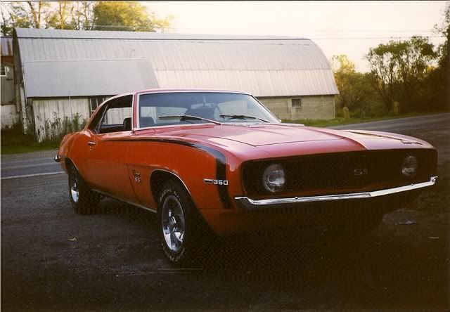

smallblockhero 04-10-2011 09:04 PM
Re: Will 235/60/15 Goodyear eagles fit '69 camaro?
this is 235/60/15 on all 4 corners here. like was previously mentioned.Its hard to see the full clearance but you get the idea. they fill the wheel houses perfect. but i did have a little rub on the sub frame when at full lock to lock. nothin crazy though . and it looked very nice.
http://i174.photobucket.com/albums/w...h/scan0004.jpg
bergy 04-11-2011 12:00 AM
Looks great! Thanks for the input.
