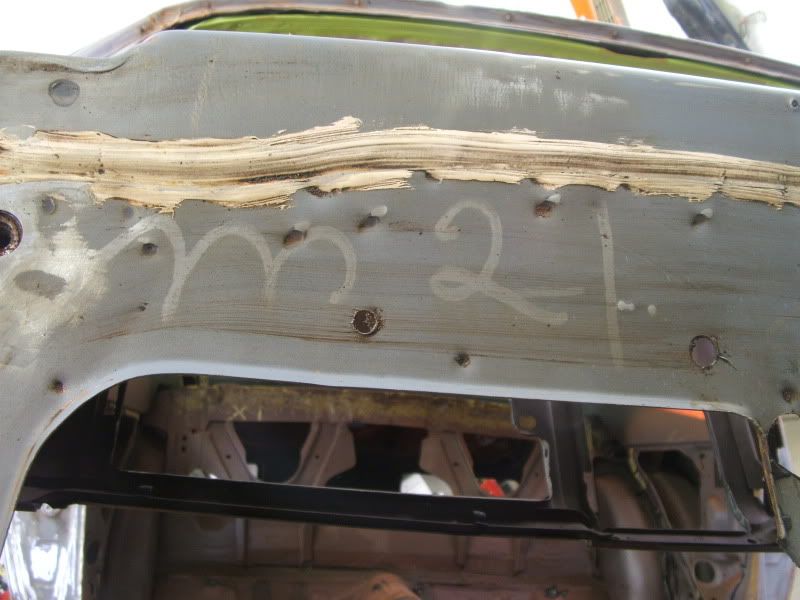

I am getting ready to restore my Indy soon and I can see the cowl markings under the black paint on the firewall, but they are not very clear. What is the best way to clean paint off the cowl without eliminating the markings?

plastic media blasting, very carefully.
m22mike 10-16-2011 05:08 PM
Re: Cowl markings on my L-78 M-22 Indy
Check this out. Those crayon marks were done on bare steel. I stripped this firewall with cheap Kleen strip. It was buzzed with rattle can black, plus the OE lacquer.
The primer underneeth is very tough stuff, work the black off and wipe with lacquer thinner till you get to the gray.
The crayon will be gone, but the primer that was over the marks locks in the image.
http://i18.photobucket.com/albums/b1.../COPO02831.jpg
http://i18.photobucket.com/albums/b1.../COPO02827.jpg
http://i18.photobucket.com/albums/b1.../COPO02826.jpg
Show us the pictures... [img]<<GRAEMLIN_URL>>/grin.gif[/img]...we like pictures... [img]<<GRAEMLIN_URL>>/naughty.gif[/img]

Thanks guys..I will try the lacquer thinner method since I have no media at the moment....
And Yeh, great pics Mikey...I will post some pics of my car 'as-is' before I remove the paint... And then some after pics also.....I am in Brasil at the moment but will post some pics when I get back in the US next week..I can see some of the markings, but cannot figure them out...I'm sure you guys probably can help.

Is that a OR (orange) behind the Z21
m22mike 10-17-2011 04:55 AM
Look closely , it is a big &quot;OK&quot; in yellow, it was over the Z21.
Mike
