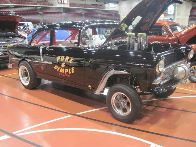

First off, I think you need to pick a specific period in time. I talked to Jamie Jarvis about his 55 Chevy and that is one of the first things he committed to on his 55 build. He went for a build on a 55 chevy done with in the late 1960's theme. I think he did a great job.
http://i722.photobucket.com/albums/w...w/556771c4.jpg
Every time period has cool parts, but they don't all mix well. I personally draw the line for Day 2 around 1972, but that is because of my taste in cars and equipment. There are a lot of cool things you could use form the mid to late 1970's, but I would probably keep away form the 1980's stuff just to help with the focus of your theme. There is a bit of a departure on 1980's equipment as it became less "grass roots". Kinda tough for me to explain at the moment, but I'll try to expand if it is needed.
