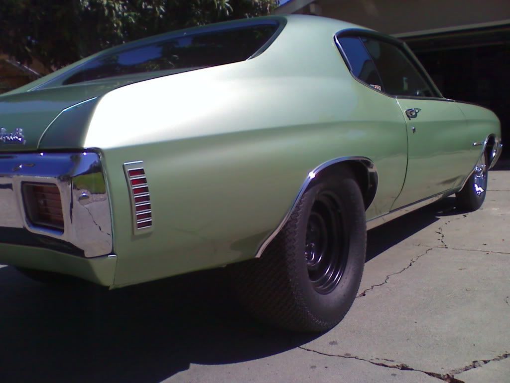

mr.4speed 01-14-2012 12:47 AM
Re: will these tires work for my day 2 project?
mine are 15x8 4 1/2 bs L6015 MICKEYS FIT GREAT! http://i579.photobucket.com/albums/s...85499_ORIG.jpg

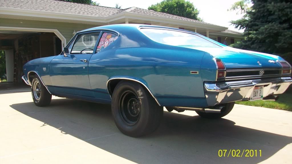

69 Post Sedan 01-14-2012 02:03 AM
Here's my car with factory 15 X 8 Corvette Rallys and 28 X 11.5 M/T ET Streets.
I did a little research and it appears the 15 X 8 rally's have a 4" backspacing not 4-1/4". So a 4-1/2" backspace would be better as mine are a little too far out although I don't have an issue with any rubbing.
Kurt
