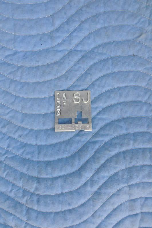

Donnie 01-15-2012 11:54 PM
Re: Radiator tank codes
Tag info, IA, CF, 53, SN.

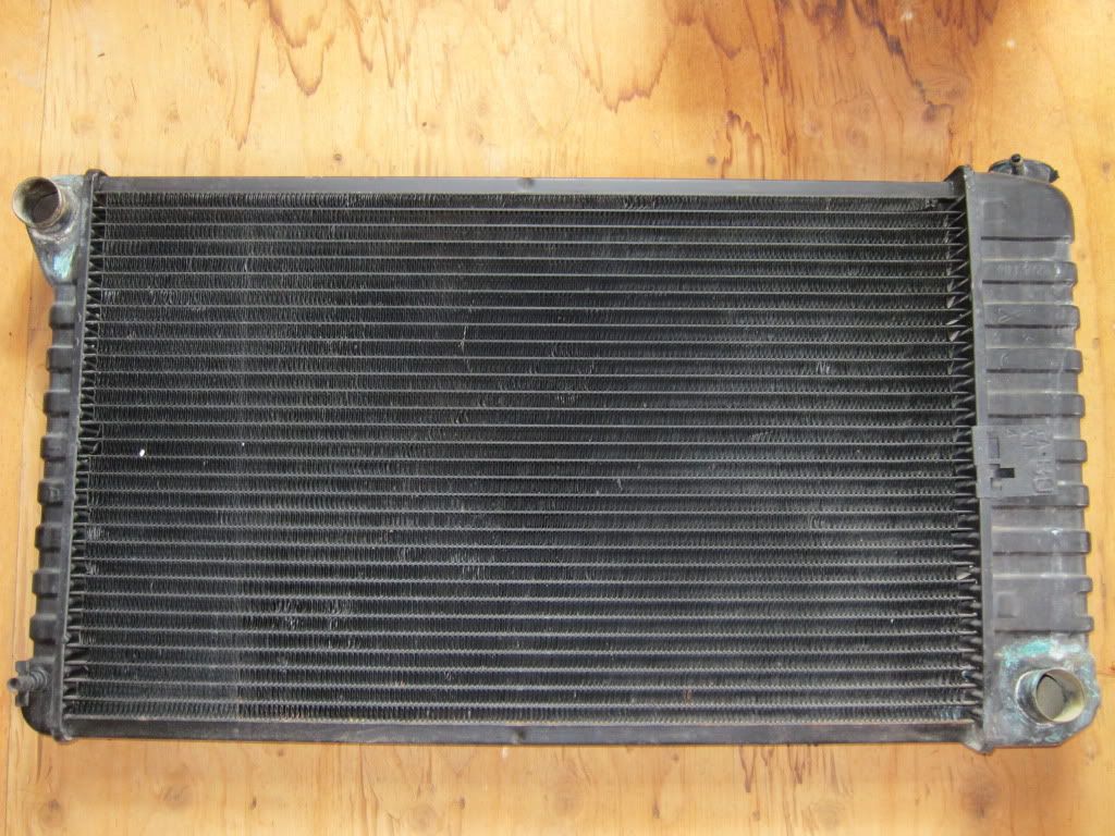

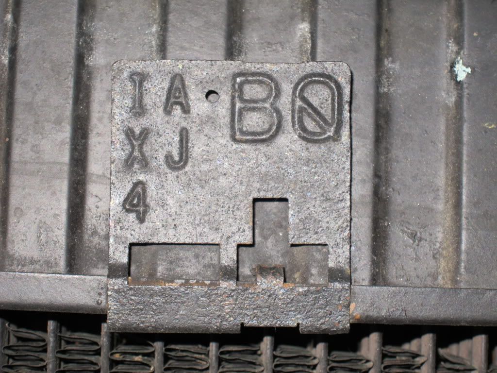

GenOne 01-16-2012 01:05 AM
Donnie what car is the radiator for? I have a bunch as an example this December BQ with tank codes IA XJ(L78/LS5/LS6 4 speed if I remember correctly) - let me know and I will dig them out and take a look for you.
http://i317.photobucket.com/albums/mm397/X66396/081.jpg
http://i317.photobucket.com/albums/mm397/X66396/083.jpg
Nova Research Project 01-16-2012 01:19 AM
<div class="ubbcode-block"><div class="ubbcode-header">Originally Posted By: Donnie</div><div class="ubbcode-body">Tag info, IA, CF, 53, SN. </div></div>
IA and CF are Auto trans tank codes use on a bunch of cars for 2 and 3 core rads. SN code is 'I believe' a Monte for a 400-2 small block (LF6 265hp Turbo-Fire).
Greg
