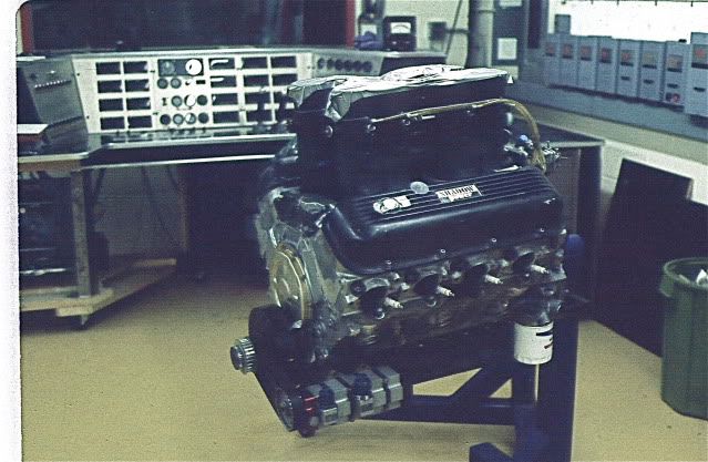

<div class="ubbcode-block"><div class="ubbcode-header">Quote:</div><div class="ubbcode-body">Here's a picture (taken in late 1972 probably) for Y'all. This is a development engine (495 inch Reynolds, 1200 hp) for the 1973 Shadow Turbo car on the dyno. Keep in mind this was all mechanical, no electronics, modified Hilborn injsction, Bendix aircraft air metering units, Switzer pneumatic wastegates. What a nightmare to work on. I'll bet I changed 50 head gaskets on this beast </div></div>
http://i174.photobucket.com/albums/w...640003_003.jpg
http://i174.photobucket.com/albums/w...th/shadeng.jpg

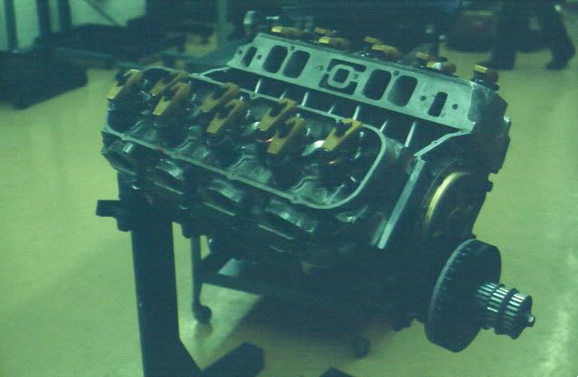

information from a previous thread i posted in and another one of dougs photos
Doug Meyer Shadow team engine builder
<div class="ubbcode-block"><div class="ubbcode-header">Quote:</div><div class="ubbcode-body"> I was an engine builder for the UOP Shadow Team from 72 through 75 and built these engines almost exclusively. Engines I assembled were driven by Jackie Oliver, George Follmer, Vic Elford, James Hunt and Peter Revson. I was trained on them by Lee Muir who came to Shadow directly from McLaren. I've got loads of photos and, if I dig deep enough I can probably dig up my track/tuning notes.
In the early Can Am years only three teams had the Reynolds &quot;390&quot; Aluminum blocks. McLAren, Shadow, and Chapparral. Later they became more common, but most of the &quot;lesser&quot; teams didn't use the all-aluminum 390 blocks, but iron sleeved castings. All were Lucas injected.
McLAren did their own porting, as did we. The usual well known California head guys did most of the rest.
We rarely built 510's, almost always 495's. Race trim hp was about 735with flat tappets. We bult some roller tappet &quot;Qualifyers&quot; that did about 775 hp. In '73 we built a 1200 hp turbo 495 (I could change those head gaskets in my sleep!) to compete with the 917K. We were faster at Laguna Seca but ran out of brakes. Vic Elford was driving- Donohue came over to Lee and I after the race and told us &quot;he'd NEVER seen anything accelerate up the hill like that beast&quot;. THe tires on that car were 24 inches wide and it would leave giant blackies all the way up the hill. I've built lots of engines but those are still my favorite. Nothing in motorsports sounds like 20 of those things at the green. I'll never forget it.
We got our parts directly from GM racing. The sleeveless blocks were all Reynolds since Reynolds was the developer of the high Silicon 390 alloy/iron plated piston technology. Could be that the sleeved blocks the &quot;regular people&quot; got were Alcoa castings.
</div></div>
GM #'s
3992038..Block, 4.44&quot; bore AL W/Liners
3993803..C/Shaft, 3.47&quot; stroke
3963642..Rod, connecting 6.405&quot; C/C
3992042..Sleeve, cyl liner (for 430&quot; AL)
http://i174.photobucket.com/albums/w...h/shadeng2.jpg

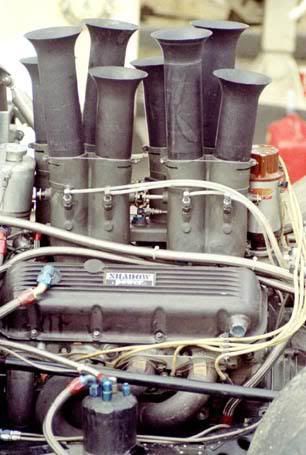

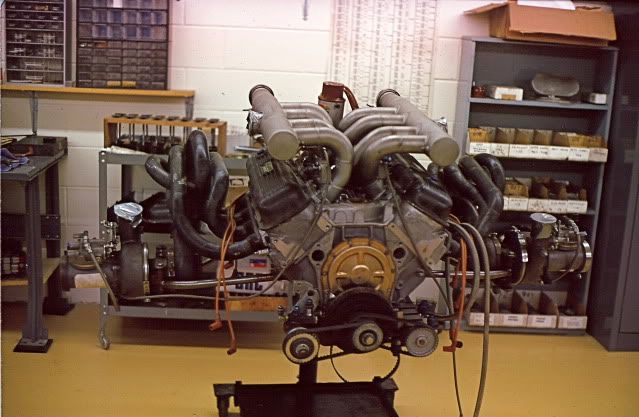

more of dougs work from back then. from his own photo collection.
http://i167.photobucket.com/albums/u...640015_015.jpg
http://i167.photobucket.com/albums/u...s/93690003.jpg
http://i167.photobucket.com/albums/u...93690007-1.jpg
and doug with the &quot;infamous&quot; DN4
http://i167.photobucket.com/albums/u...640029_029.jpg

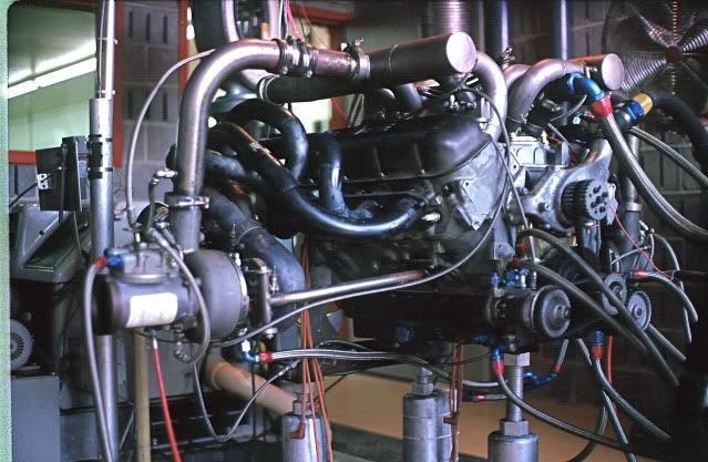

dynoing the nasty Turbo 1200hp Can-Am monster!
photo courtesy of Doug Meyers.
http://i167.photobucket.com/albums/u...640014_014.jpg

I was not THE engine builder but AN engine builder for the team (no &quot;I&quot; in team ya' know). As I mentioned I was mentored by the great Lee Muir (ex McLaren) who taught me a great deal (and I wasn't too shabby a wrench when he hired me). There were three of us; Lee, Me, and &quot;Stump&quot; Davis.
The picture of the running engine on the dyno is not a Can Am engine,but is a 390 block aircraft engine that Lee and I worked on for about 7 years. It was successful (technically if not financially) and is currently sold as the Trace Engine. (look it up).
The reason Lee and I were chosen to develop that engine was that when Reynold was contacted for engineering they sent the developer to us because only a very few builders had as much knowledge on working with the 390 as we did (and I was a pilot and could fly on the test flights).
