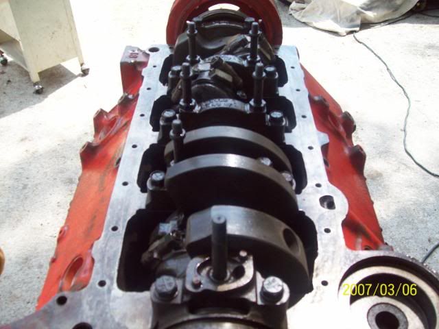

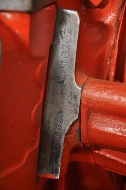

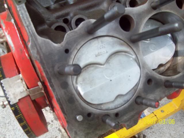

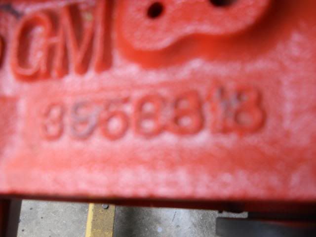

I have, what I think is the real deal (1969 DZ 302 Engine). I would just like some input on this to make sure it is a DZ 302.
Here's some numbers I have found.....Thanks for any help.
Front pad....... V0107DZ 1576024
Oil Filter....... 371 388 88N
Back of block........3956618
Heads........3927186
Couple pics..........
http://i88.photobucket.com/albums/k1...1/100_0637.jpg
http://i88.photobucket.com/albums/k1...1/DSCN2226.jpg
http://i88.photobucket.com/albums/k1...1/100_0646.jpg
http://i88.photobucket.com/albums/k1...1/DSCN2223.jpg

DZ is nothing but a suffix code. At least the block started life as a 302 it looks like. All those 4 bolt blocks could be in many applications. Have to see if the crank says 1178 on it. Its casted on the first throw up by the balancer. That is a Z/28 crankshaft. Rest of the stuff looks pretty good from here. DZ code looks like January 7th of 69.

If stampings are original and pad location correct for Vin, isn't there some digits missing between the 1 and 5?
9N if Norwood car?
VIN 124379N576024 ?
[img]<<GRAEMLIN_URL>>/dunno.gif[/img]

I checked the numbers on the crank and it is a 1178 and main caps are 2482.
Salvatore 06-03-2012 12:45 AM
Re: 69 DZ 302 Engine ID.........
Main caps would be the same for a 350....I think? The crank being an 1178 is a 3&quot; stroke so you are good. Like I said DZ is a suffix code for a Z/28. Block is nothing special compared to other 4 bolt blocks.

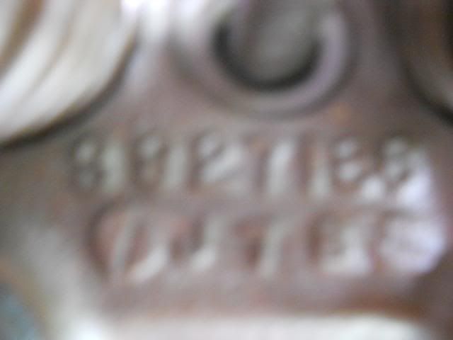

You need to provide a good sharp image of the pad with the stampings. Use the Macro setting on your camera (Flower symbol).
Then we can see if it is a &quot;real&quot; DZ-block.
Jan
198plus 06-04-2012 03:06 PM
[quote=jannes_z-28]You need to provide a good sharp image of the pad with the stampings. Use the Macro setting on your camera (Flower symbol).
Jan [/quote
http://i88.photobucket.com/albums/k1...1/DSC_0787.jpg]
x77-69z28 06-04-2012 05:39 PM
i believe that 1 is an L or van nuys car. stamp looks good to me, but i am no expert.
x77-69z28 06-05-2012 01:11 AM
just checked with a friend who has an 01B norwood z-28. his vin is 9n575XXX and his vin is by the oil filter. i dont think that after they changed the location, they would go back to the pad.
Fast67VelleN2O 06-05-2012 01:51 AM
A different plant might have done things differently.
