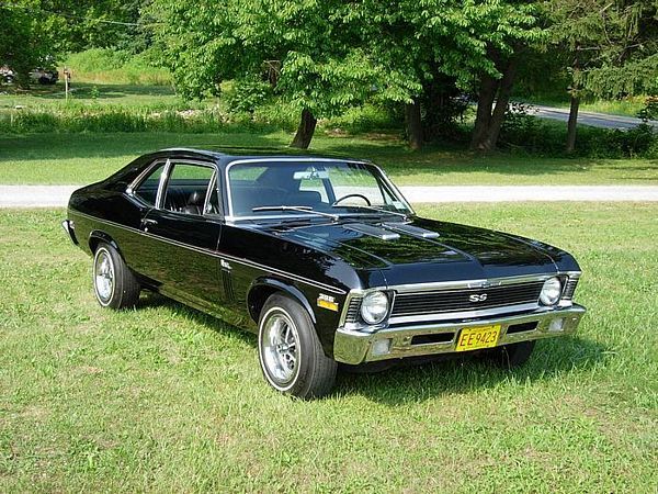

Our 1970 Black L78 4 speed car had the Ziebart treatment...the old sticker is still visible inside the trunk lid. They sprayed it everywhere!! Inner fenders, behind the headlites, firewall...you name it. There are also the plugs in door, rockers, door jambs, etc...underside, too. This car has ZERO RUST..about 90% original paint...it was well cared for by the original owner and of course by us for the last 12 years...I have no doubt the Ziebart has helped preserve and protect our Nova.
wilma
http://i1235.photobucket.com/albums/...DSCN5386-1.jpg
