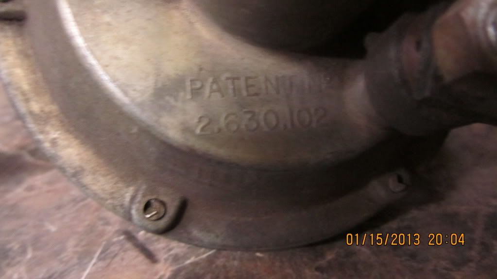

Andy4639 01-16-2013 02:25 AM
Delco Pleasur-lift air shocks w POWER PAC compress
<span style="color: #FF0000"><span style="font-weight: bold">Delco Pleasur-lift air shocks w POWER PAC compressor?
Do any of you know any thing on these. I know the basic operation and know how to hook it up I think. Just wondering if anybody has any litature on them with instructions maybe. Thanks.
vacum line to pump/compressor then to gauge then to the shocks which in my case will be my helper air bags inside the rear coils.</span></span>
http://i1233.photobucket.com/albums/...k/IMG_1673.jpg
http://i1233.photobucket.com/albums/...k/IMG_1674.jpg
http://i1233.photobucket.com/albums/...k/IMG_1677.jpg
http://i1233.photobucket.com/albums/...k/IMG_1679.jpg
http://i1233.photobucket.com/albums/...ck/airbag2.jpg

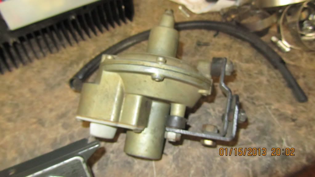

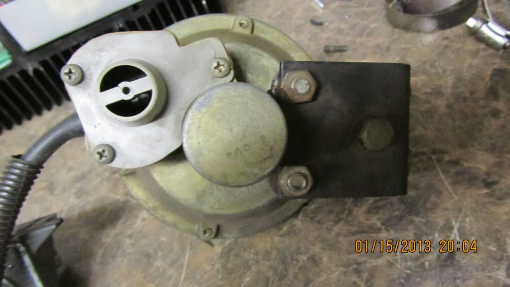

Andy4639 01-20-2013 07:15 PM
Re: Delco Pleasur-lift air shocks w POWER PAC compress
1 Attachment(s)
<span style="color: #FF0000"><span style="font-weight: bold">Well I brought the pump into work today and we put it on a vacum. It works but needed some lubrication. So I took it a part and cleaned out good and then Neolubed all the little parts that move and put grease on the o-rings and sealed it up good.
Hooked it back up to the pump and she is perring like kitten. </span></span>
