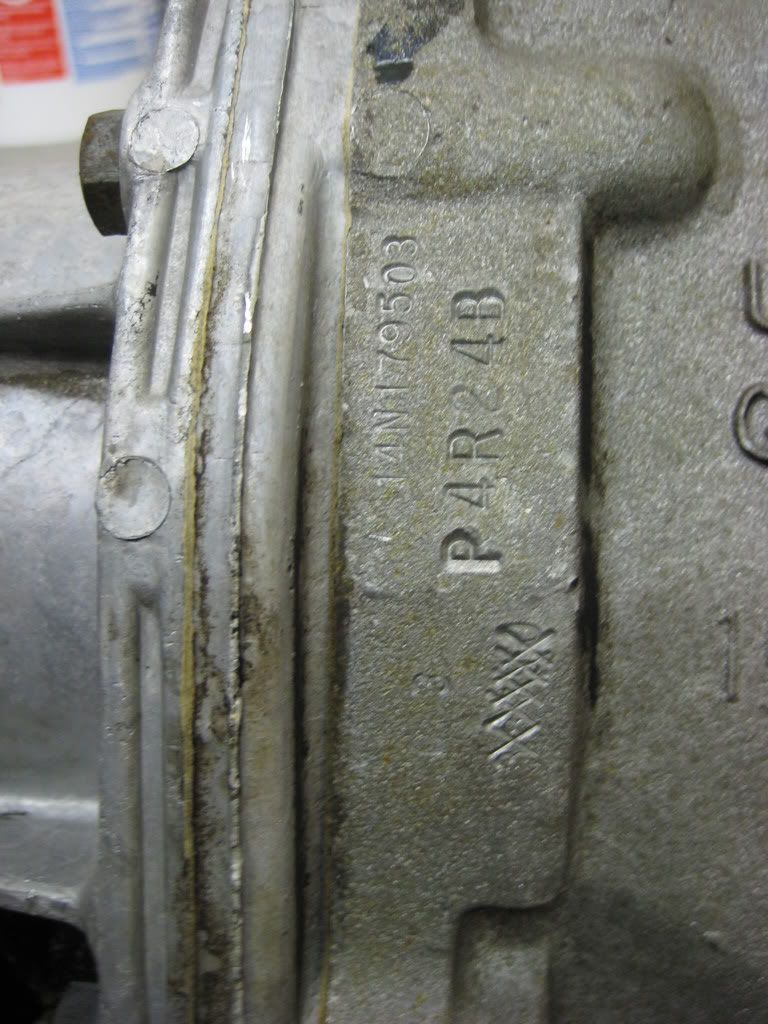

I PICKED UP A 1969 M22 TODAY AND THE DATE CODE STAMPED ON THE SIDE OF THE CASE LOOKS LIKE IT WAS DDOUBLE STAMPED HAS ANYONE EVER SEEN THIS DONE ?

ALLZS 01-30-2013 04:12 PM
Re: MUNCIE DATE STAMP
HERE A PICTURE https://www.yenko.net/attachments/use..._speed_001.jpg
iluv69s 01-30-2013 05:42 PM
im no expert, but, does not look anything like my fonts on my original 69 m-22??
Kurt S 01-30-2013 06:27 PM
That's not right.
The stamps don't line up. The 9 is not between the P and B of either stamp. Meaning it wasn't done with a factory gangstamp.
crash 01-30-2013 11:44 PM
RESTAMP Muncie date code never used flat top "3"s , and the font and spacing looks odd...
Hope this helps... Crash
