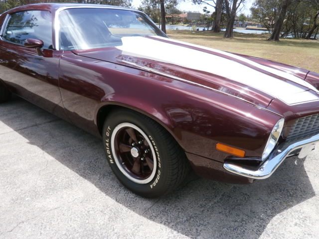

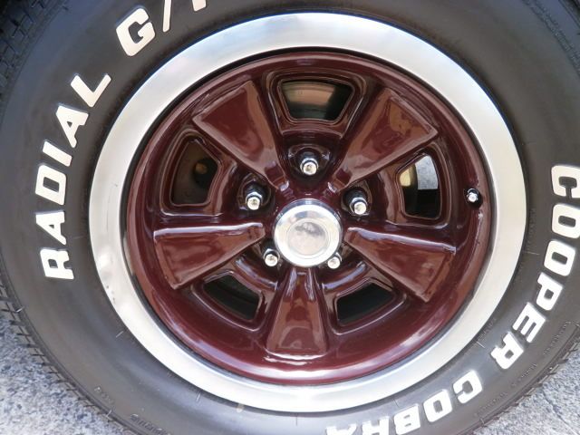

Im looking for the paint code for the cast 5 spoke 71 Camaro Ralley wheel. I have a nice 71 but the wheels are Maroon overkill. Im sure they are not the same as Vett ralley silver ya?
cheers Dave

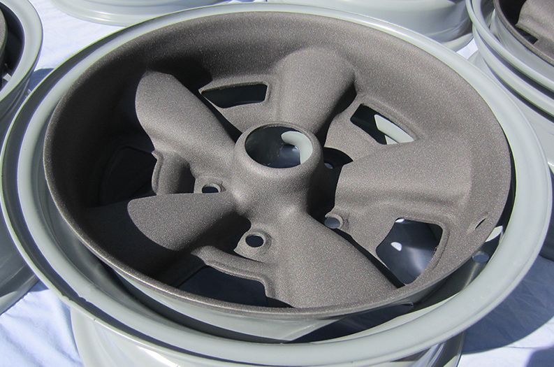

Done correctly, it should have a textured finish. pm Just bad joe. I think he has the mixing formula.

Yes, as mentioned above, the correct formula is DDL32961. If you search the NastyZ28 website you'll find more than enough info on this. I believe someone was recently able to get the lacquer formula from Year One. BTW, the wheels in your post (OP 6pakdave) look like 76 and later wheels.
- Mike
http://i630.photobucket.com/albums/u...ps866f0410.jpg
m22mike 02-24-2014 07:26 PM
Re: 71 Ralley wheel paint
That wheel looks great. I saw an original one recently and it was very textured, almost rough.

Looks like the valve location changes on the later rim?
cheers Dave
roeville 02-25-2014 06:09 PM
Dave, the original lacquer formula is now a little difficult to find. Most paint manufacturers can match the color but have trouble replicating the texture which was done with a suede additive. Somewhere I have the actual formula too. Let me know if you need it and I'll post a picture of the can with the specific formula for DDL 32961.
This type of wheel in early 1970 had a 5/8” oval valve stem clearance opening in the outer face. Mid 1970-76 had a 13/16” oval valve stem clearance opening. 1977-1978 had a round 7/8” opening, 1979-81 are 1” round. The date code is stamped near the actual valve stem hole (i.e. K11 6 14). K=Kelsey-Hayes, 1=Chevrolet, 1=1971, 6=month, 14=day. The outer rim face protrudes out more on the early wheels (pre 77) creating less of a lip with the trim ring installed. Also, the spoke design is rounder and less flat compared to later years. -Mike

Im not too concerned about the rough argent finish, the correct 'dull grey' is what Im looking for.

Dave, YEAR ONE has the absolute correct wheel paint. It takes a few weeks to get, but it is the original DDL-32961 formulation. There is a thread on nastyz28.com with pics of my wheels. They are DBA(dead balls accurate) it's an industry term! Oh crap, just looked at where you are from. I don't think it can go by plane!
