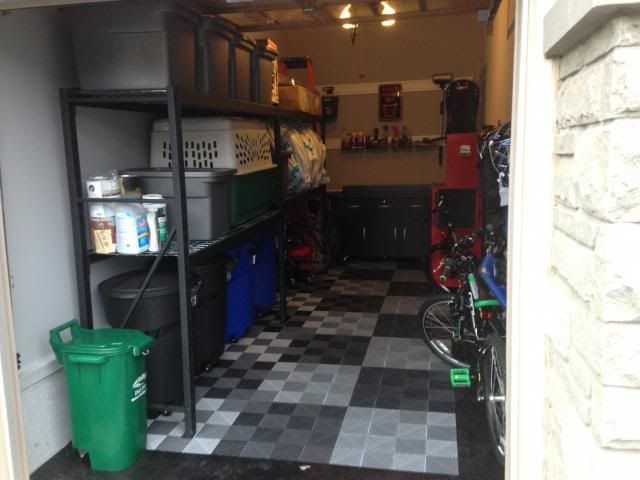

Sam I checked into those tiles for my outbuilding floor where the cars are stored and was going to install them at the end of summer. It was going to cost me just over two grand to do it so I passed for now. The company that makes the tiles I looked into is Rubber Flooring Inc. out of Chandler Az. They seem to have a nice product. My friend installed their rubber roll out mat in his garage and said it worked and is holding up fine.
Another friend of mine told me that if you want something inexpensive to put down on the concrete and will look nice is to roll out a good grade grey paint primer. He did this in his shop and it has held up very well for several years..
Other people I talk to discourage you from painting the floor due to possible adhesion issues.... [img]<<GRAEMLIN_URL>>/dunno.gif[/img]
Rich

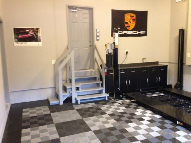

Hey Sam...I have Race Deck flooring and a 4 post lift and there is no problem with that set-up at all. I am adding a second 4 post lift this summer.
If you are a garage journal member, call Race Deck and tell them and they wlll give you a 10% discount and free shipping [img]<<GRAEMLIN_URL>>/smile.gif[/img]
