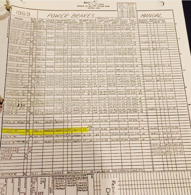

Keith Seymore 08-04-2015 02:51 PM
Re: Brake Booster Check Valve Tag
<div class="ubbcode-block"><div class="ubbcode-header">Originally Posted By: cook_dw</div><div class="ubbcode-body">No one knows??? </div></div>
I have the engineering brake release charts for '69 and later (passenger car and truck for '69; truck only for 70 and newer).
I'll check the book when I get home.
K
cook_dw 08-04-2015 03:14 PM
Thank you Keith!!
Keith Seymore 08-05-2015 02:26 PM
1969 and 1970 Chevy B car (…at a minimum).
I wouldn’t be surprised if it spans more model year/usages than that, but my charts start in 1969, and the format changed in 1971 making it less obvious.
This is how it was done in the days before Excel spreadsheets….
[img]<<GRAEMLIN_URL>>/wink.gif[/img]
K
http://i23.photobucket.com/albums/b3...psboqzufep.jpg
http://i23.photobucket.com/albums/b3...psnswz5gjn.jpg
http://i23.photobucket.com/albums/b3...psgzyk42ja.jpg
SS427 08-05-2015 02:35 PM
Great information and a very neat sheet to possess. Thanks for sharing Keith!
