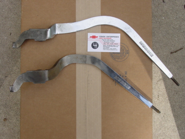

you ever see a shifter and ball like this?
no muncie on it just a T and the ball looks marbleized.
https://www.yenko.net/ubbthreads/pics...6-img_0185.jpg
https://www.yenko.net/ubbthreads/pics...7-img_0184.jpg
scuncio 09-15-2016 12:39 AM
Re: 69 70 nova guys
Maybe a Saginaw shifter. Never seen a ball like that....
WILMASBOYL78 09-15-2016 01:55 AM
Re: 69 70 nova guys
I have seen that 'T' marking before...Saginaw 4 spd. I think we have a console version with the same mark. Low horsepower V8 applications got the Saginaw wide ratio tranny. Limited audience for that item..
-wilma
L78steve 09-15-2016 12:34 PM
Re: 69 70 nova guys
I had a 72 SS 350 El Camino with a Saginaw and that stick.Do not recall which ball it came with.
Swapped it out for a M-20 and a Hurst.
Donnie 09-15-2016 11:50 PM
Re: 69 70 nova guys
Tom, how do you tell the difference between a console shifter and a non console?
Bill Rose 09-16-2016 02:17 AM
Re: 69 70 nova guys
Donnie...The console shifter kicks the handle over to the right so it comes up thru the center of the console. The non-console shifter is more straight up and comes thru the floor closer to your leg.
