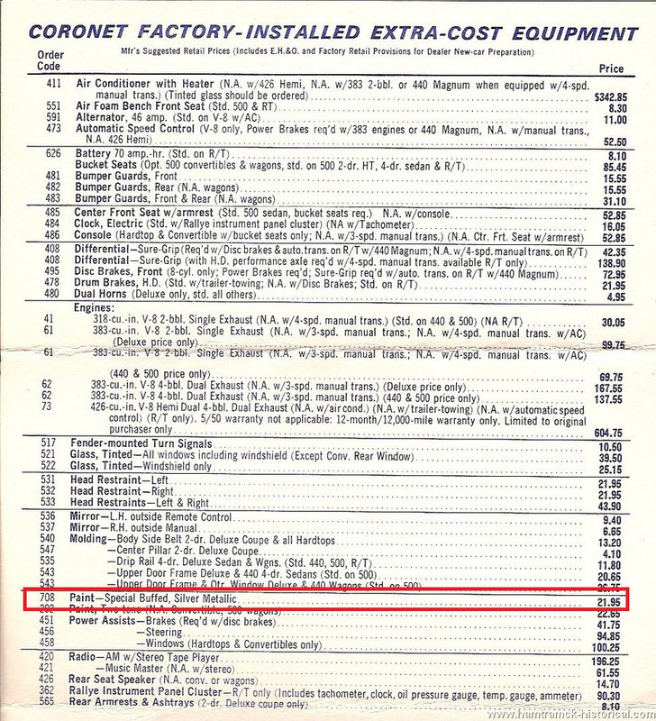

https://i.postimg.cc/5NHr3q1v/68-Cor...t-Card0004.jpg
Chrysler charged extra for buffed Silver Metallic on it's cars during the middle to late 1960s. That was the only "standard" color that was buffed and had a cost to it.
