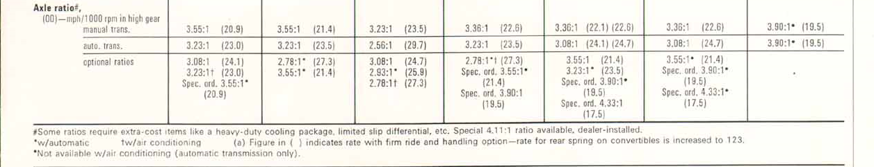

so was the 3.36 or steeper gear available with any motor option?
Lee Stewart 07-29-2019 02:32 PM
Originally Posted by iluv69s (Post 1457200)
thanks!
https://i.postimg.cc/hv9RZLZj/screenshot-7296.png
https://i.postimg.cc/sfpFrJKf/screenshot-7295.png
