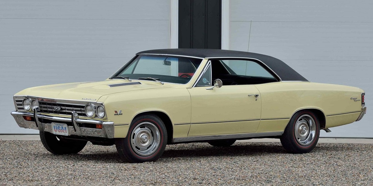

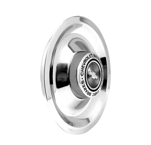

1967 was the first year front disc brakes were an option on the Chevelle. Part of the option was the inclusion of the rally wheels (14") which were not a separate option. No 15" wheels/tires until 1971 (standard on the SS)
Lee Stewart 04-20-2020 08:12 PM
https://i.postimg.cc/bJp6KvdR/sc0517-282321-1-2x.jpg
https://i.postimg.cc/dVRrgjCz/screenshot-7882.png
Lee Stewart 04-20-2020 08:21 PM
https://i.postimg.cc/Z59Kdbbj/623690.jpg

You will be looking for 14 x 6 rally wheels with DG stamped by the valve stem hole

14x6 DG wheels is what you will need. Only available with front disc brakes.
